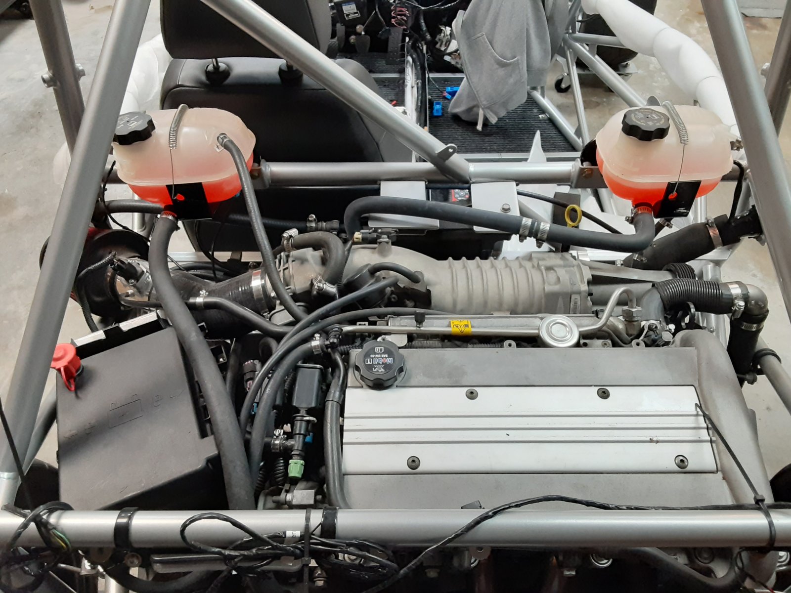

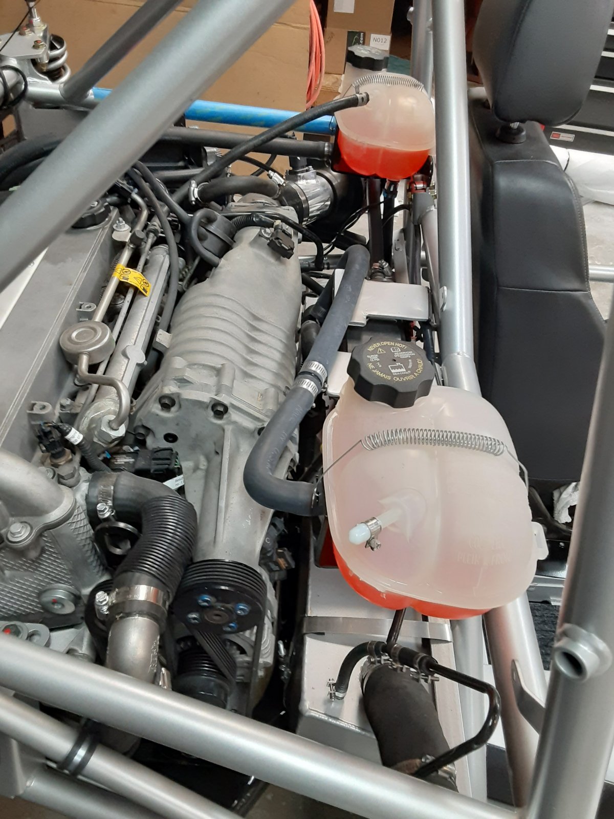

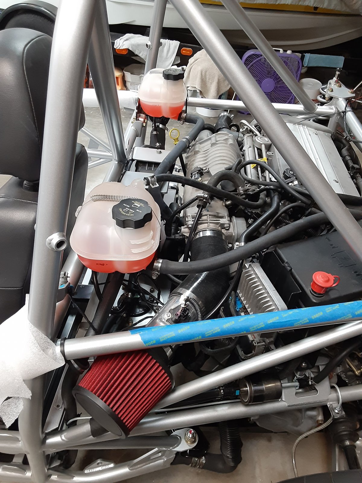

This is what I had ended up doing for the Option B tank, which I copied from the Ariel Atom. I wanted to keep the area open around the dipstick.
Waterdriver
Did you tap the intake manifold for the bleed line?
Yes. That's where the small hose, connected to the top of Oprion B tank, is connected to.
The only time I've seen air come through that line is when first running the HE pump after initial installation and fill. There was a bit of burping that did occur at that time.
It's reassuring to know that any air that could be trapped in the intercooler is purged.
Thanks yeah I saw your thread in my scouring of the forums. Not sure that I want to mount it on top of the engine, but it's an idea to keep in mind. Probably mostly personal taste.
