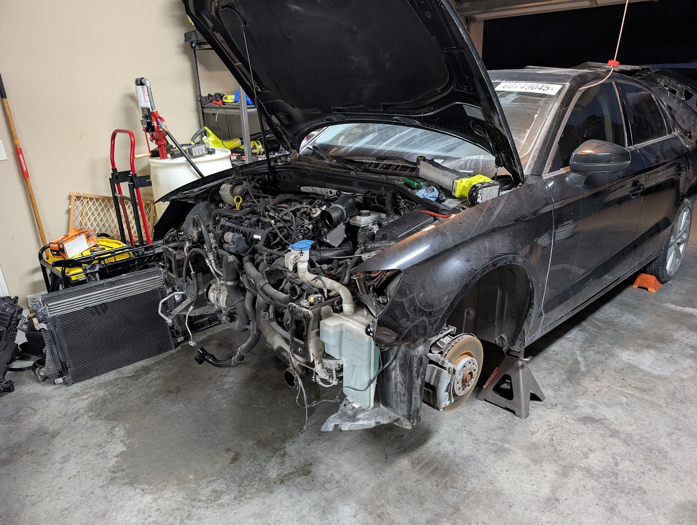

Not as productive as a weekend as I had hoped, but still progress nonetheless.

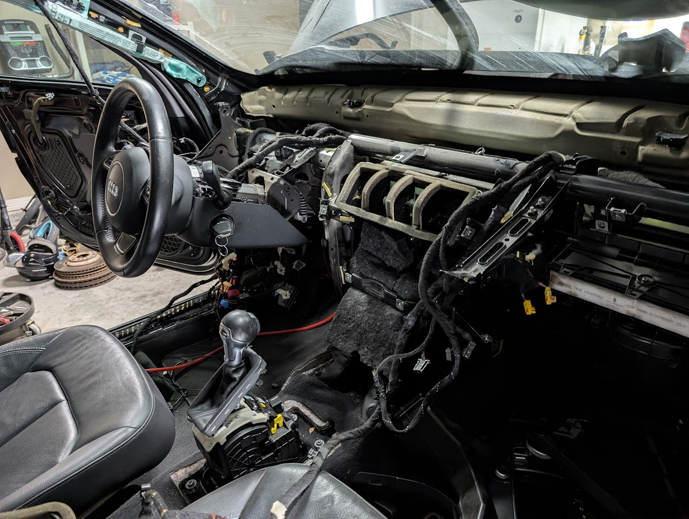

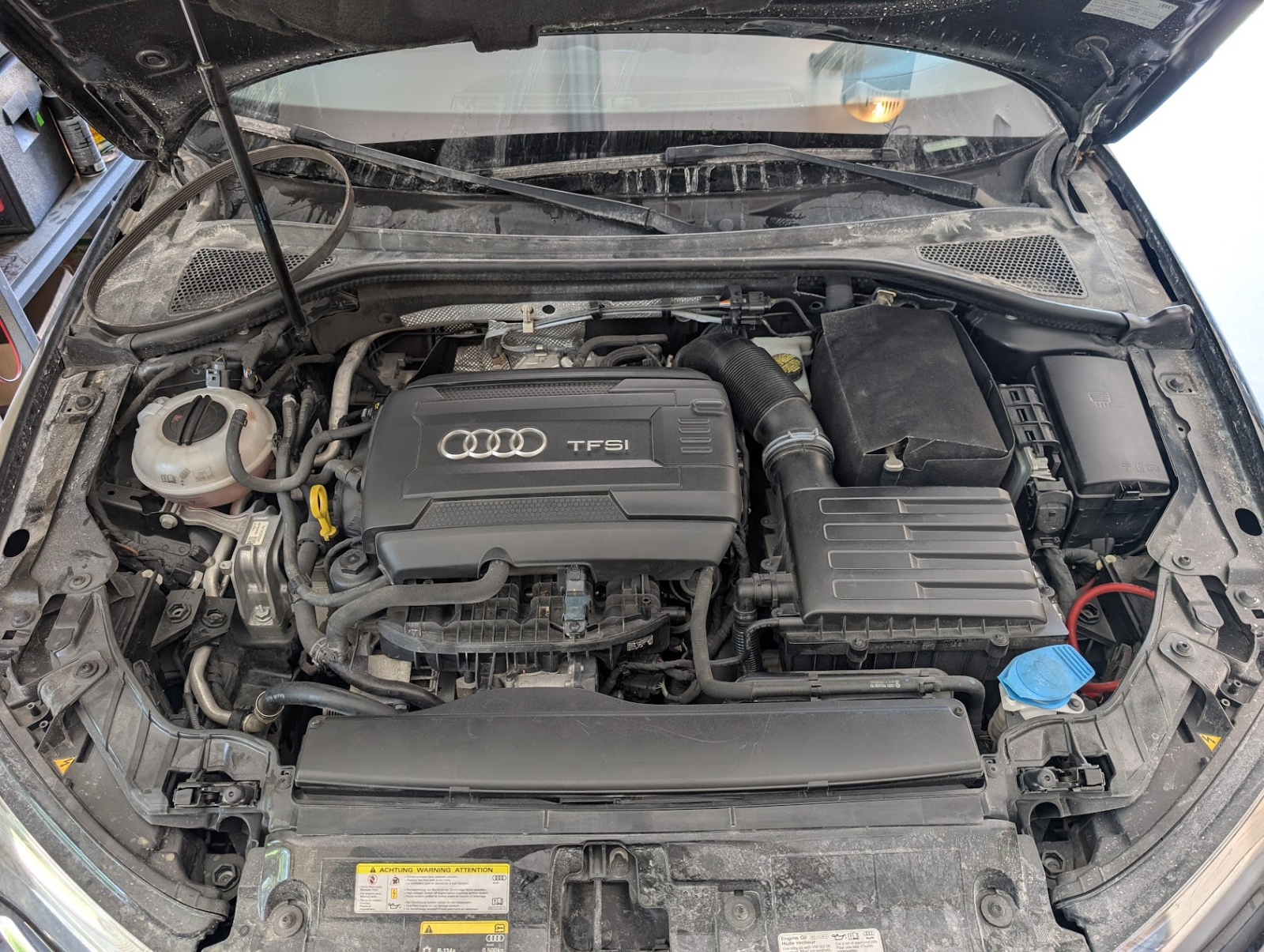

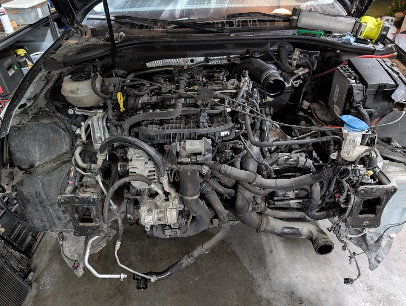

Brake booster and every wire out of the engine bay. Trans shifter removed (that under car heat shielding was a PITA)
Only thing really left is the body harness and LPFP/module. Got all the wire out of the doors and everything from behind the dash area. Some items i in the rear are going to be a pain I feel like, but so far I can only think of the rear wheels speed sensors, LPFP wiring and wiring to the rear lights should be all I need... I think.
Hopefully have all of this done in the next couple of weeks. The cooler temps (Florida) is really making the job a lot easier.

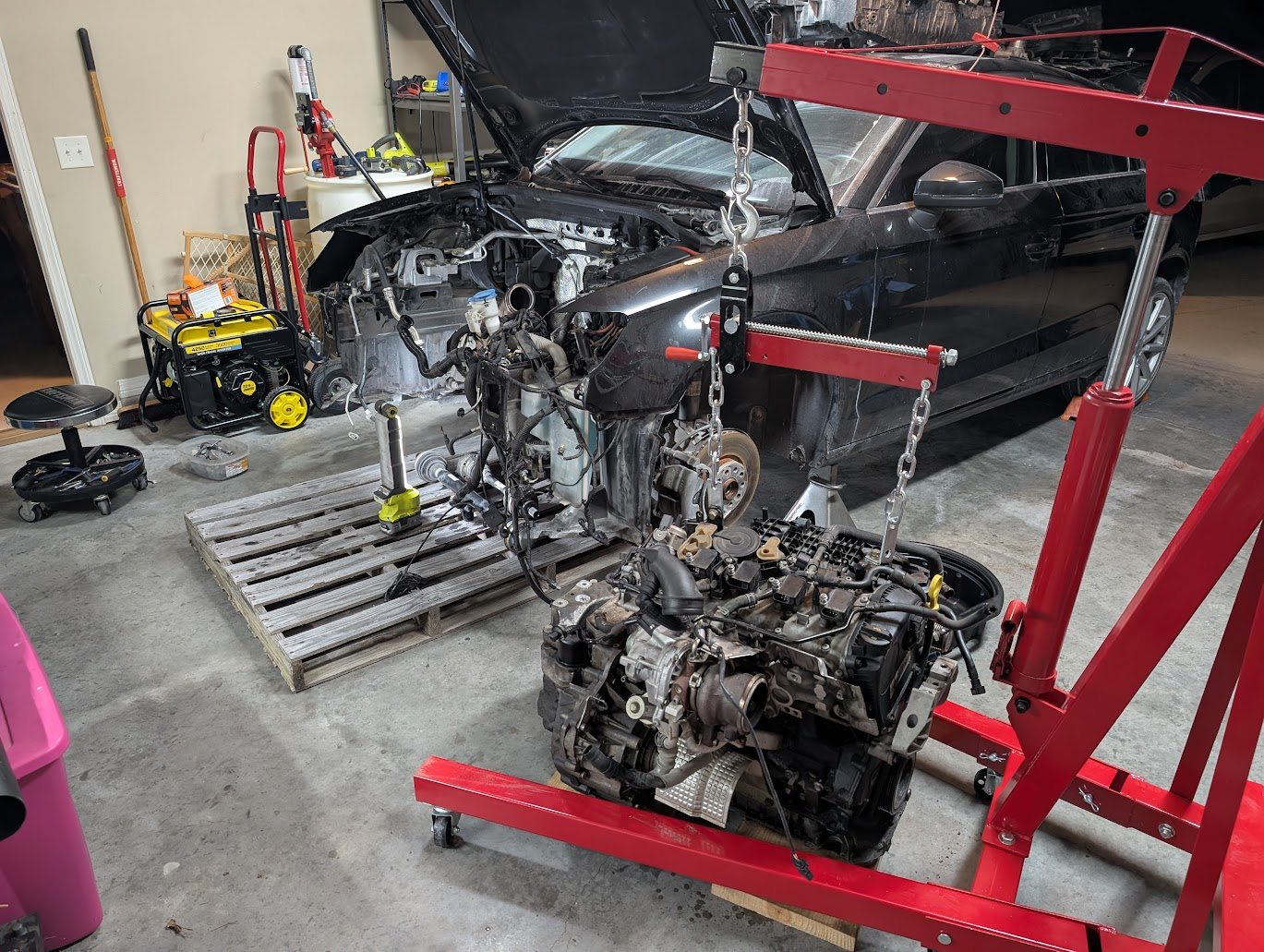

Okay, lots of time working on the car today.

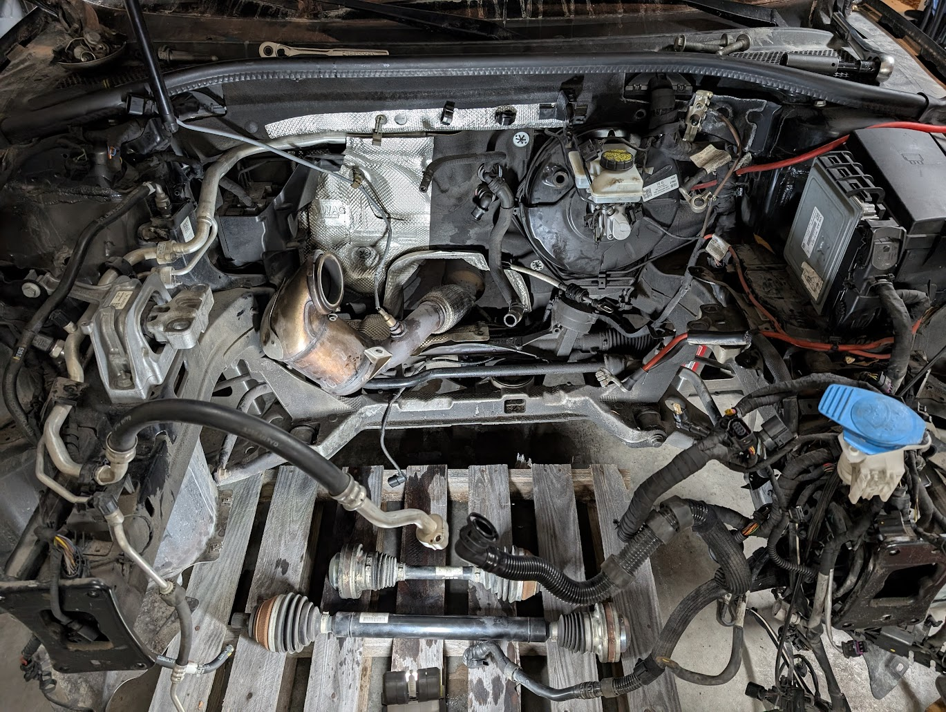

I have everything out of the car that I need. A guy is picking up the car to continue to part out in a few weeks. Once it's out of the way I'll regain a bunch of garage space to organize things better and get started working on the motor and trans stuff.
Wiring harness was a huge pain, but it is done.
