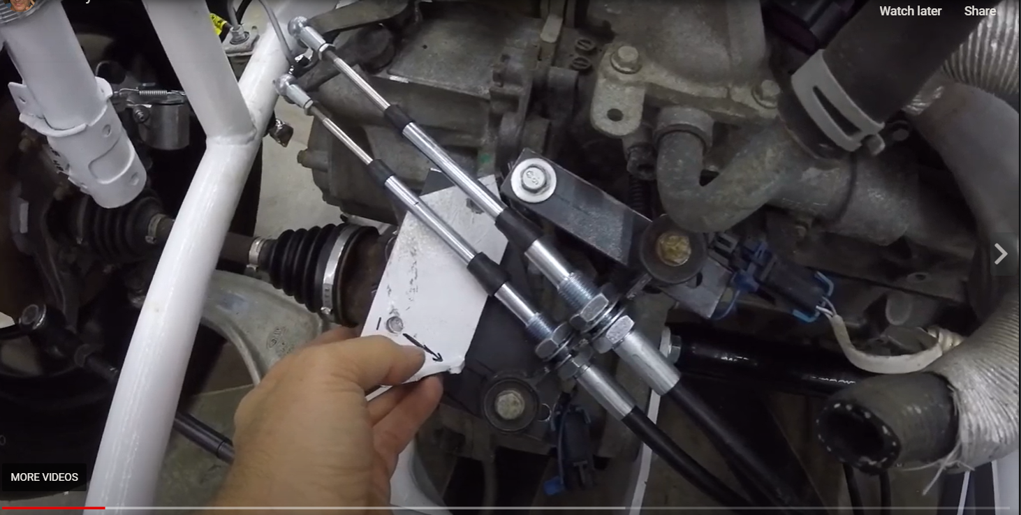

So while going through this video (very helpful by the way, thank you for having me rewatch it) I noticed that they were hooking up the "automatic shifter cable" since it resides under the fuse box assembly. Should I be doing that also/before installing the fuse box? (any video instructions on assembling the Shifter Kit?)
Furthermore, I have seen images of people routing the shifter cable behind the engine, and in the video you linked, they routed it between the engine and under the fuel tank. Is this optional?
Video link: https://dfkitcar.com/forum/index.php?media/tranny-cables-alternative-routing.437/

The manual transmission shifter cables run under the fuel tank and engine oil pan to loop around to connect to the transmission from the rear - like in the last photo you posted. The cables need to be routed as far from the exhaust as possible.
Those are pretty old pics of my car. DF has changed the cable mount on the F35 transmission, so you should be good to go.
Don't worry about that old issue I had.

Okay, sounds good Ross. I appreciate you sharing your video with mods. I am looking for another one posted that shows where "DF has changed the cable mount on the F35 transmission " so I can follow along.
