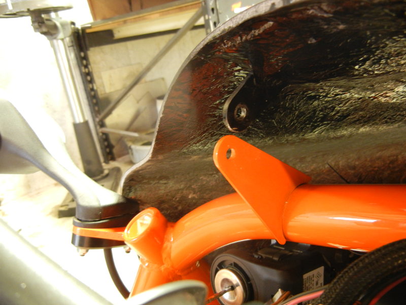

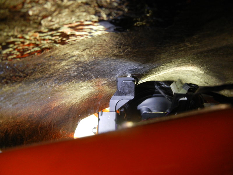

Guys, what do we do about this? The body hits the clutch switch and can't be lowered into position for mounting at the dash. I hate to cut a hole in it.
My switch, plug and top of the bracket all touch the body. I had bent my clutch bracket to help get the clutch pedal arm away from the steering shaft which may have moved the top closer to the center of the hood allowing it to fit.

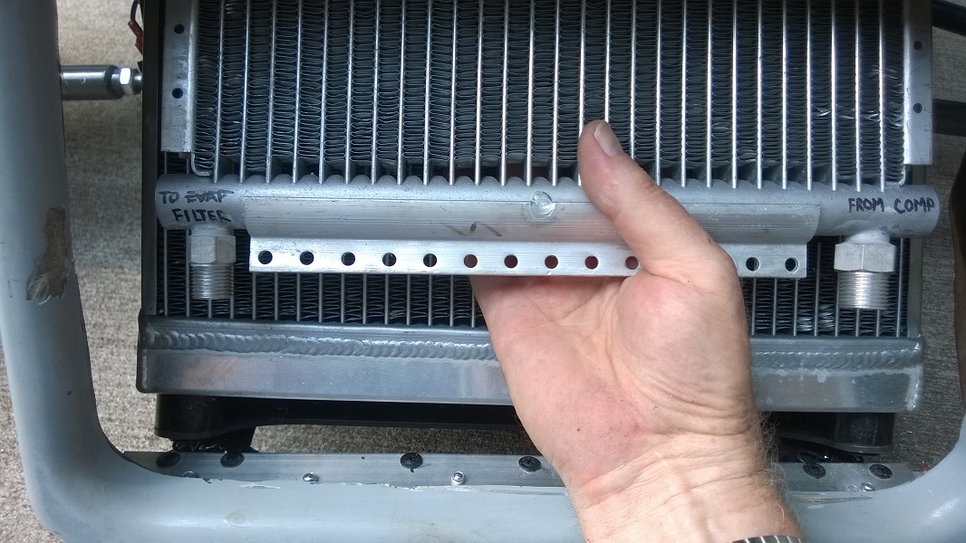

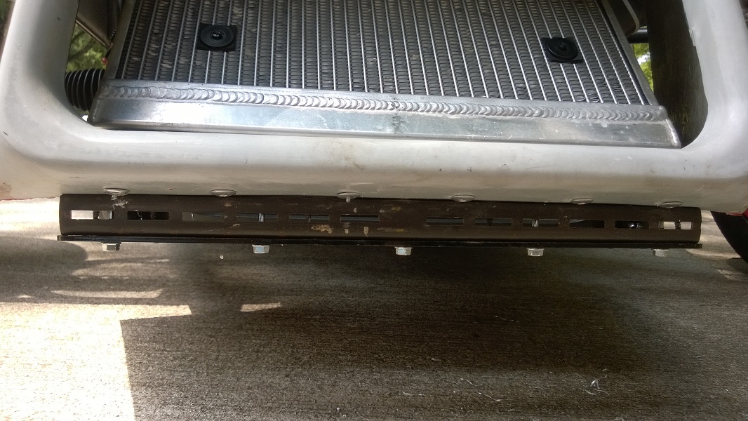

I don't know if this will help - my car is an automatic, but I raised the front of my hood up and forward about 1 inch by sandwiching the hood and the mounting plate from DF. I did it so I had some extra room for my AC condensing coil.
