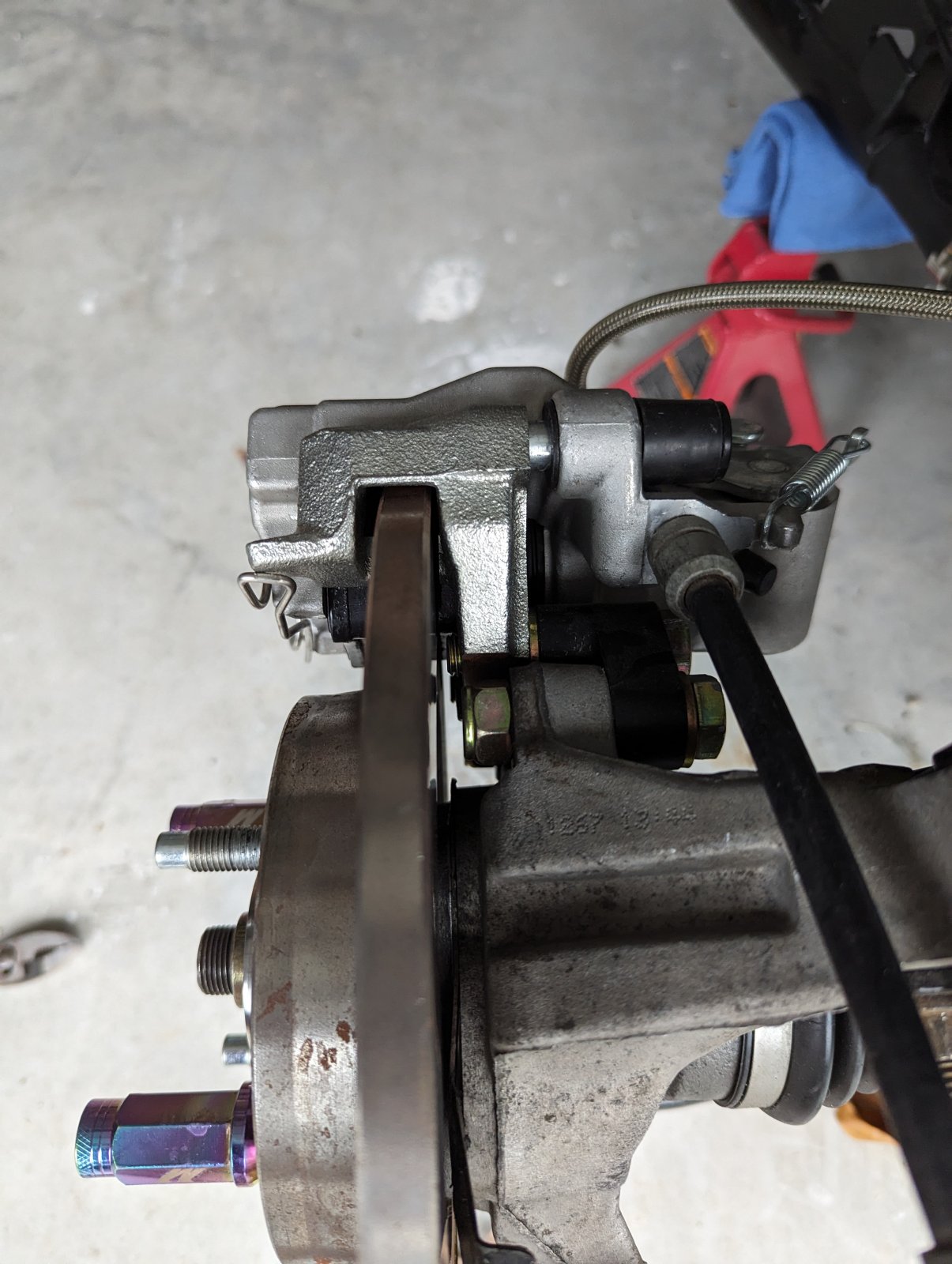

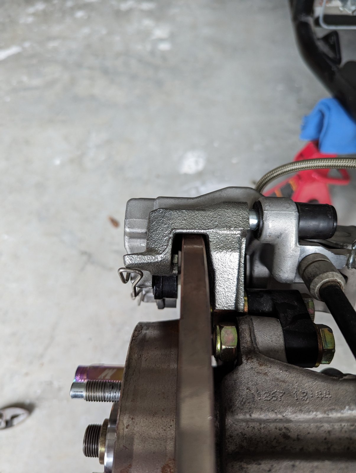

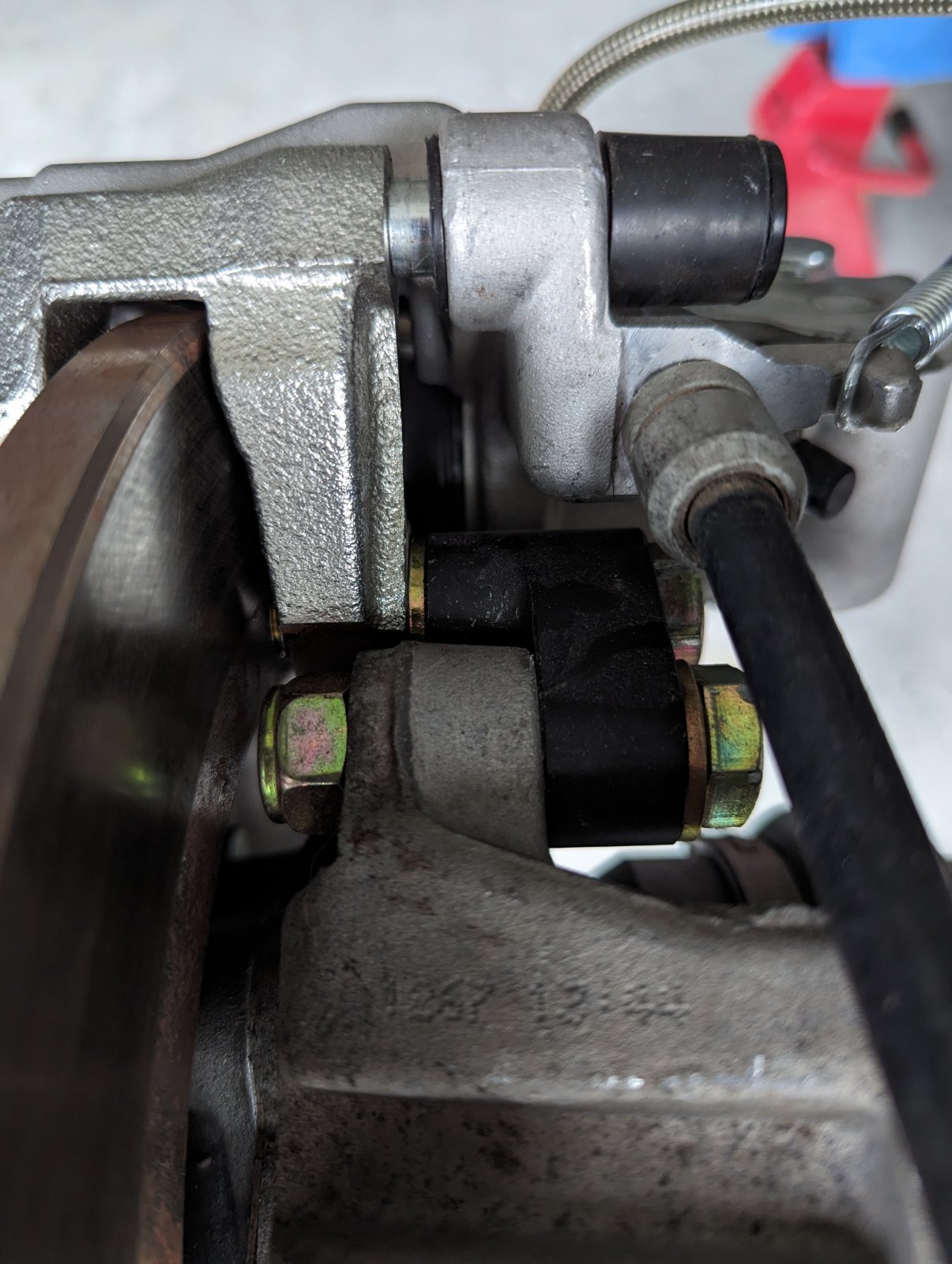

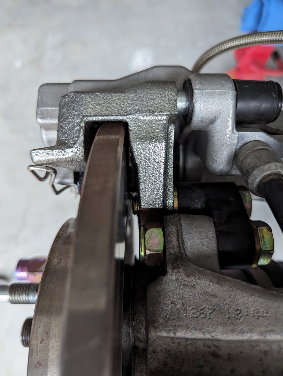

I've fiddled with the brakes for what seems to be a million times now, and they have just been my biggest pain point. I have taken the calipers off, and "twisted" the piston brake in to reset the brakes, then as soon as I put everything back together again and test the brakes, the piston brings the pads back to rubbing on the rotor 100% of the time. This is happening on all 4 brake zones. Any idea what I'm doing wrong? Or is anyone near NW Arkansas that would be interested in helping me troubleshoot this?

Thanks all, I'm going to have Ross come over to help me troubleshoot. Based on what you guys have said the bedding needs to come in on the pads. The front pads are touching, but I get a at least a full rotation on the wheel, the rears however seem to be sticky.
When I took it out on a quick first drive (maybe 3miles) I pulled back home and the passenger rear brake was smoking like hell...that's what prompted this....this issue happened before I installed the parking brake as well...I just wanted to make sure from the pictures shown that I had all the hardware and washer in the correct places.

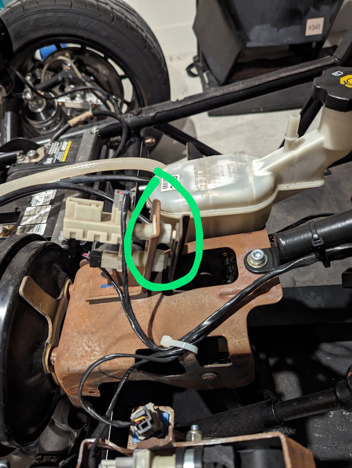

Good news. Problem is fixed thanks to @Ross for the trouble shooting help. Ross is a wealth of Goblin knowledge! Turns out I had my pedal switches set to far in, so it was basically emulating me riding on the brakes. He just pulled them back a bit, and poof! Problem solved.

Is that the before or after photo?
Friedhouse
My setup presses the whole trigger buttons in. I’m not sure if this is right or not now.
For me, when those two switches were pressed all the way down with the pedal at rest, it was simulating me riding on the brakes while driving the car. That's why I had issues with overheating the rear brakes. Moving the switches back a bit allowed the pads to fully retract off of the rotor.
Chad did say he had to bend the brake mount to move the switches farther away. Maybe your car needs to do this too, if the brakes are dragging.
