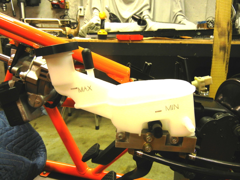

New member here been building our Goblin in my high school shop class with my students trying to figure out brake reservoir
cant find any pics about how this relocates or where it goes anybody got any

You will need to press out the two roll pins holding the reservoir to the master cylinder. Then the reservoir is mounted to the aluminum block. That whole assembly is then mounted to the pedal box with the long bolts and long spacers. Be careful of which two of the three holes you use to mount it with. I cannot remember at the moment which ones to use, but you want it level as the car is on the ground (ours does not look level as the car is not).
Maybe this might help some also.
