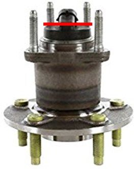

I have the 512250s. I chiseled off the entire plastic cover and then cut an 1 3/4" circle out of some metal flashing. I then used some black RTV silicone to stick it on. Stuck surprisingly well. I'm probably going to top that off with a rubber cover I found on eBay.
