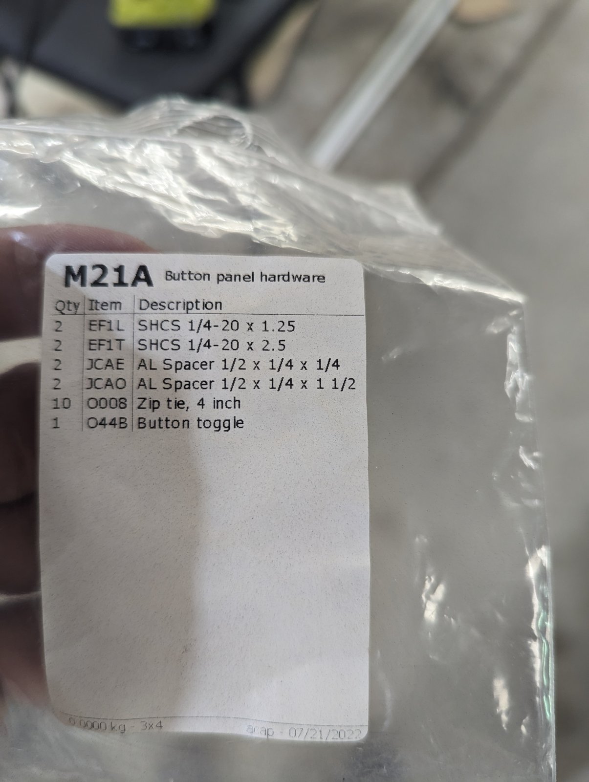

Anyone have the button panel set that they haven't installed yet? If you would be so kind, could you post a photo of the baggies contents? I need to know the two shank bolts sizes (thread, pitch and length).

As far as diameter and thread, as long as the nut and bolt match, does it really matter? I'm pretty sure that everything DF supplies that doesn't screw into a Cobalt part is SAE, not metric and I'm pretty sure they supplied 1/4-20 bolts/nuts. As far as length, there is plenty of room behind the panel if you go a little long.
And 6mm bolts are just slightly smaller in diameter than 1/4".
They are definitely 1/4-20s. My bags were missing hardware so I had to go buy bolts anyway. I think I still have the bag though and can snap a pic for you tonight after work.
That's be great. I need to get slightly longer bolts and knowing what they are already would be great. I could just pull them out and measure but having them beforehand would be easier.
