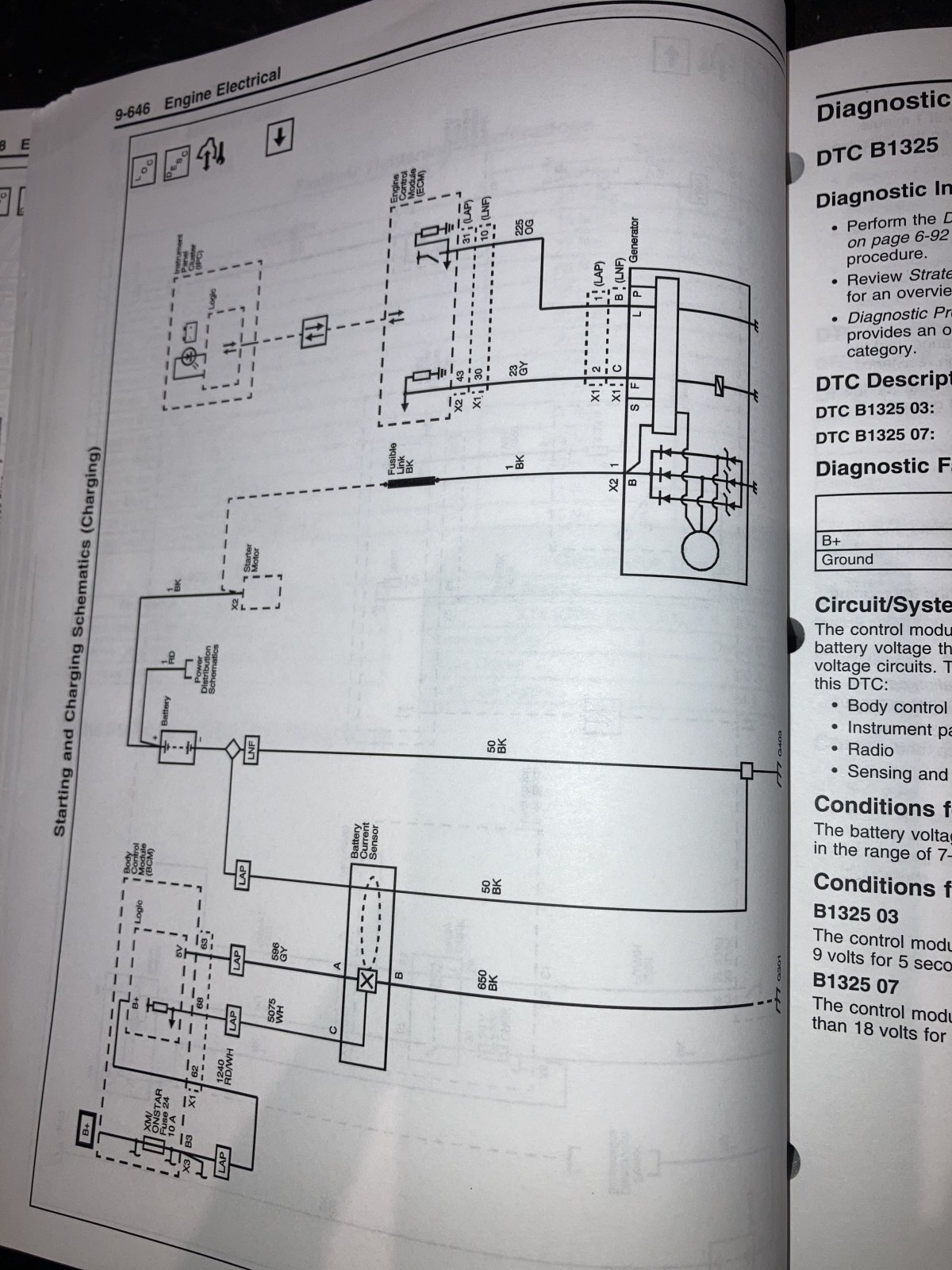

From the service manual:
The engine control module (ECM) uses the generator turn on signal circuit, or L-terminal circuit, to control the
load of the generator on the engine. A high side driver in the ECM sends a voltage signal to the voltage
regulator. This signals the voltage regulator to turn the field circuit ON and OFF.
The ECM monitors the state of the generator turn ON signal circuit. The ECM should detect low voltage on generator turn on signal circuit
when the ignition is ON and the engine is OFF, or when the charging system malfunctions. With the engine
running, the ECM should detect high voltage on the generator turn on signal circuit.
The engine control module (ECM) uses the generator field duty cycle signal circuit, or F-terminal circuit, to
monitor the duty cycle of the generator. The generator field duty cycle signal circuit connects to high side of the
field windings in the generator. A pulse width modulated (PWM) high side driver in the voltage regulator turns
the field windings ON and OFF. The ECM uses the signal to determine the generator load on the engine. This
allows the ECM to adjust the idle speed to compensate for high electrical loads. The ECM monitors the status of
the generator field duty cycle signal circuit. When the ignition switch is in the RUN position and the engine is
OFF, the ECM should detect a duty cycle near 0 percent. However, when the engine is running, the duty cycle
should be between 5-99 percent.
Yes I just re-read the manual and the above is correct.
