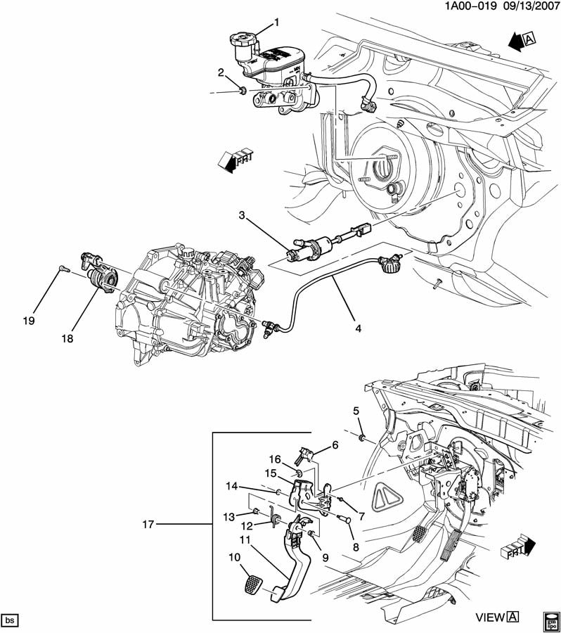

I broke what looks like the bleeder part of my clutch pipe. The pipe that runs in between the master and slave. In the pic below it is part # 4. What is needed to complete the kit from DF. What parts do I need to replace.

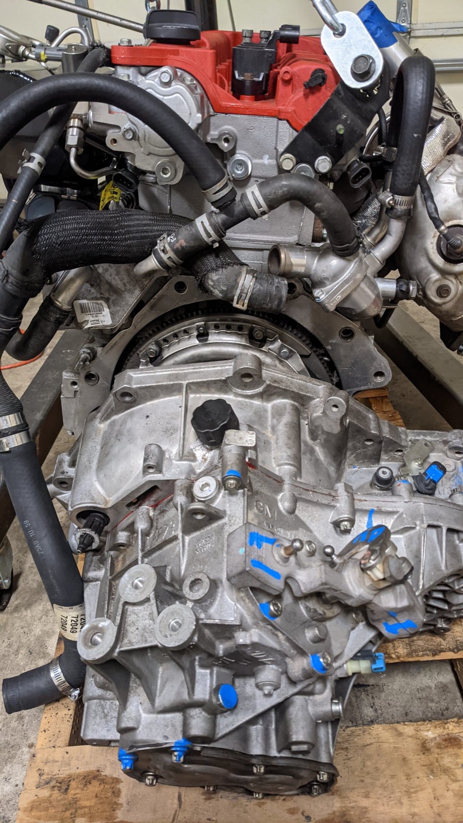

This is the part he’s referring to. The plastic line should go to this piece on the transmission line:
Towerdog, you and I have the LSJ engine with the F35 transmission. Lokian does not have this...
Lokian I am not sure what you get, but I do know what Towerdog was mentioning for the F35 transmission.
I think you have the F23 transmission?

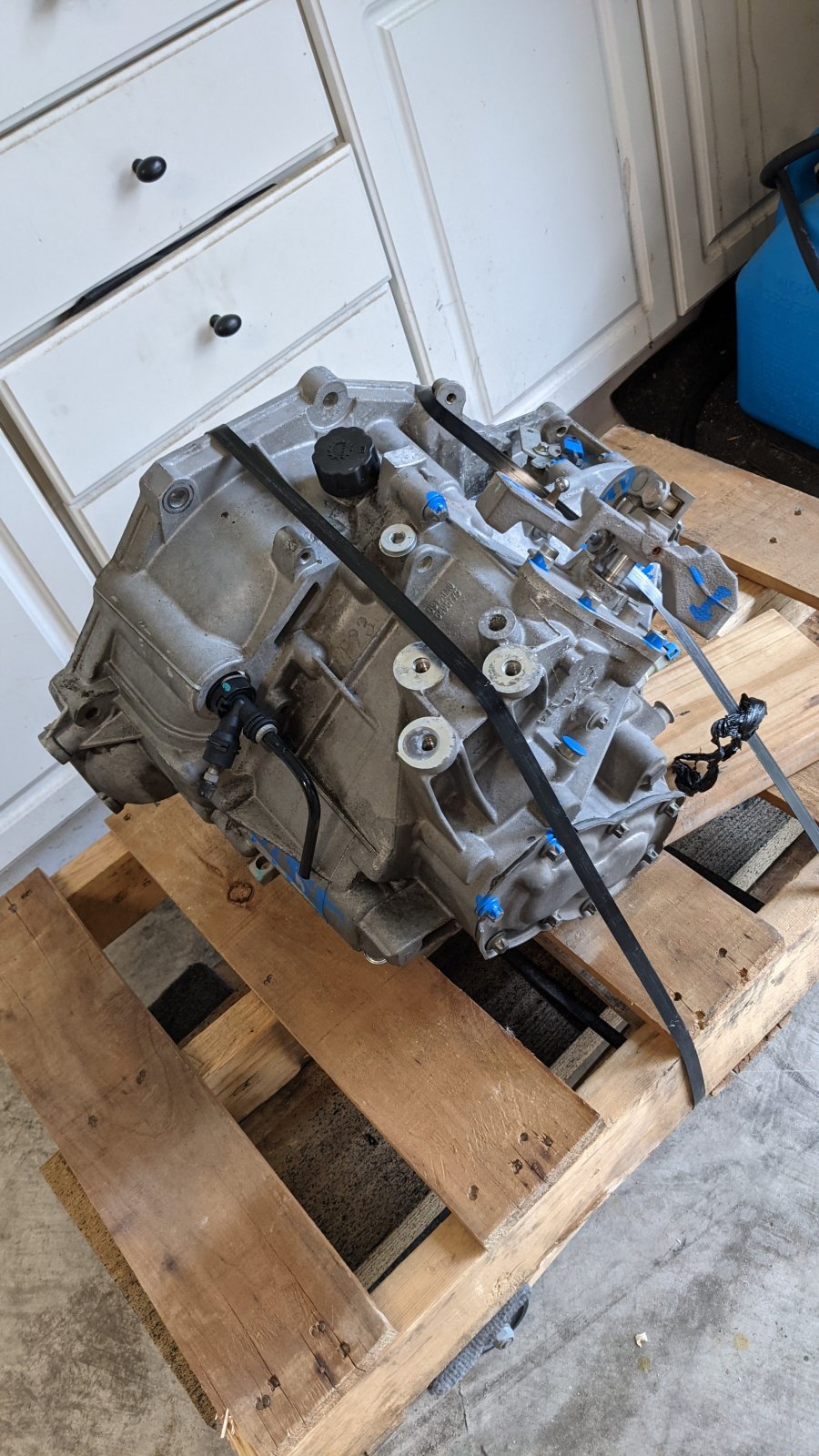

correct. My connection is not a male on the transmission but a female. I think the F35 is a male that requires that seal everyone keeps referencing :)

Anyone with a F23 transmission be able to take some pictures of the master cylinder connections?
Does this help? This is the plastic connection to the Throw Out Bearing (and not the master cylinder, which wouldn't be different between f35 vs f23)

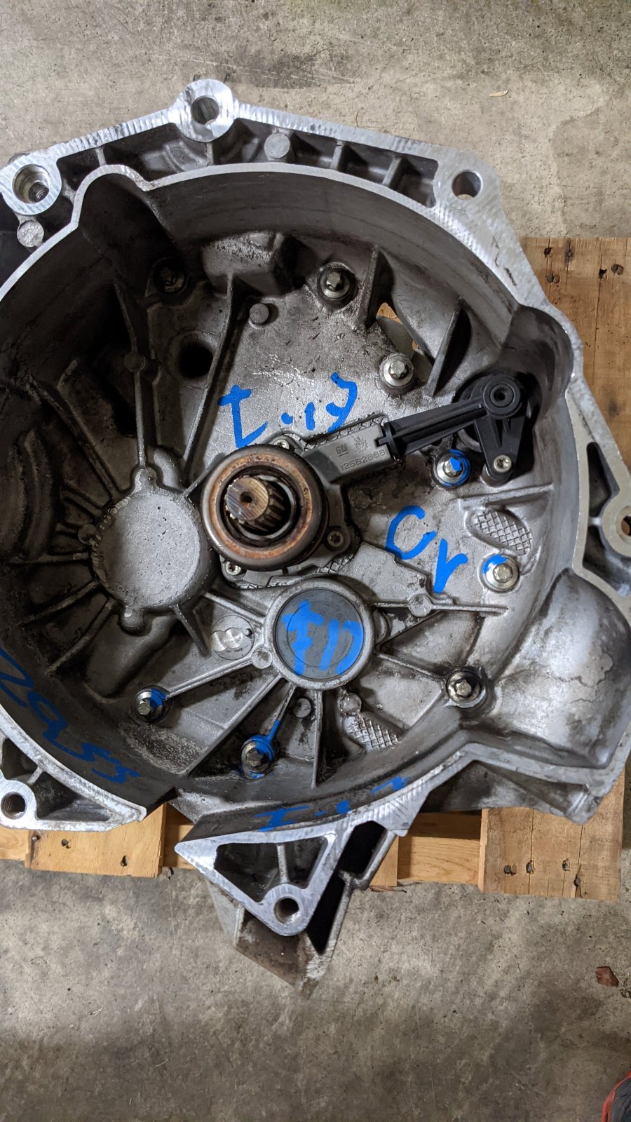

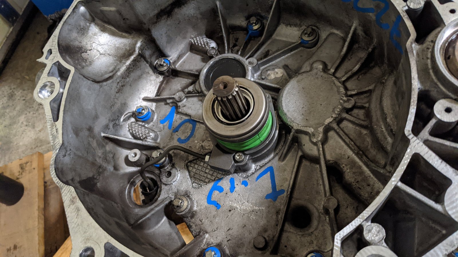

I'm probably not the right person to ask this as my build is an outlier when it comes to this. I went from F35 to F23 and used the F35 Throw Out Bearing / Pipe / Clutch Pipe Fitting on the F23 trans.
21339
21338
Here's what a normal f23 tob / pipe looks like on the inside

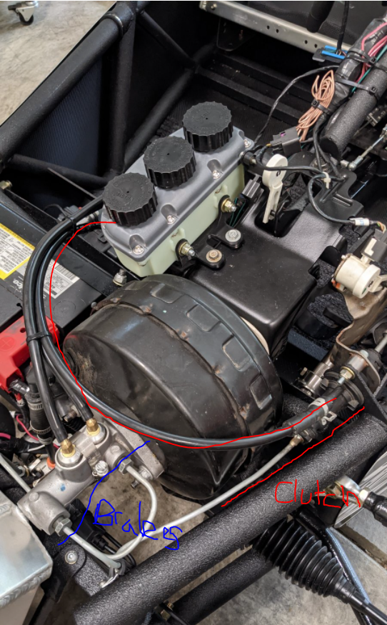

Here's what a normal DF Goblin MC looks like
21341

I updated one of the pics, the MC is for the brakes. The clutch hardline feeds directly from the pedal, gets it's fluid from the reservoir, and connects to your plastic clutch pipe fitting on the trans
