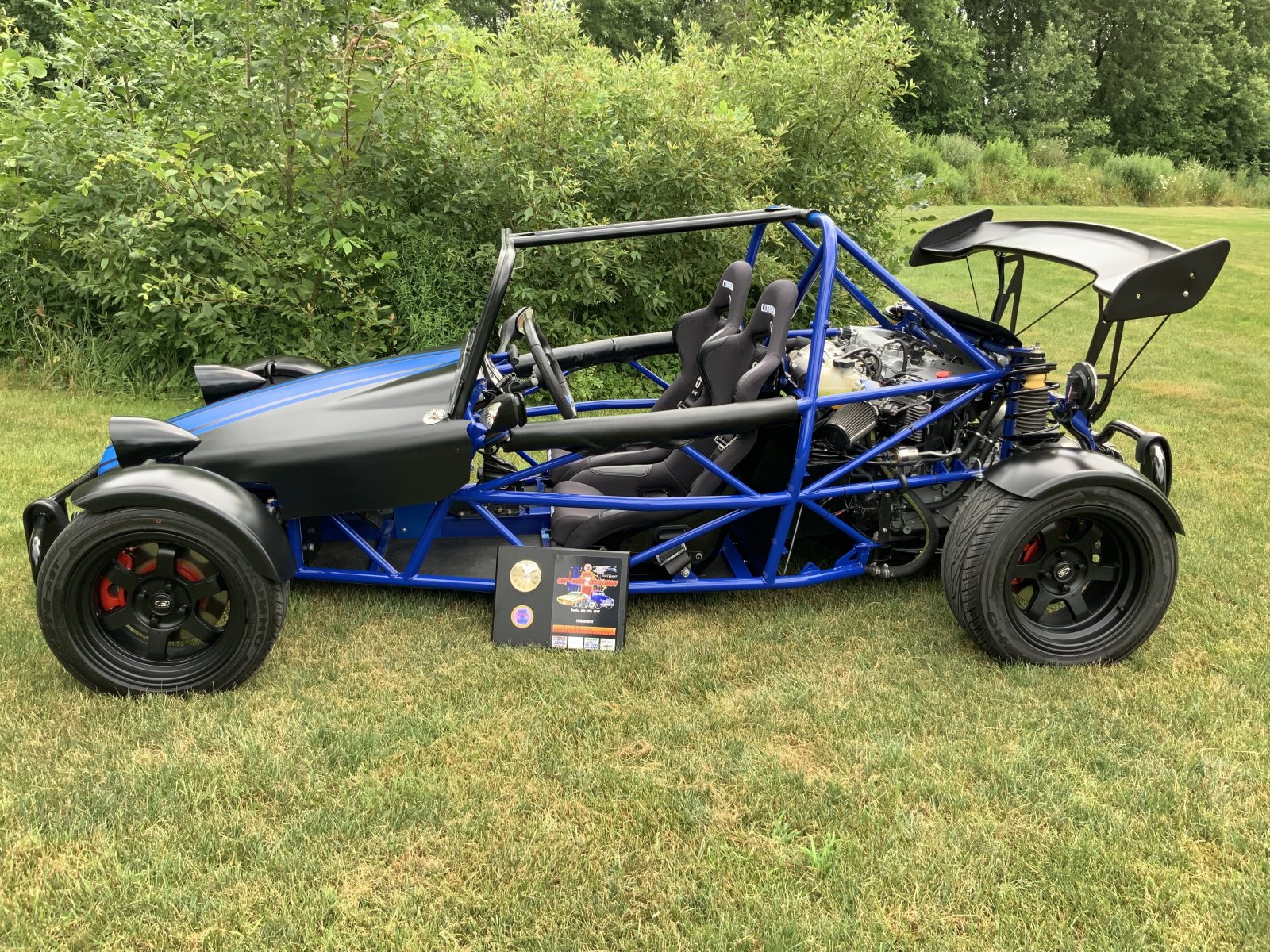

Since I've put the A7s on my car this thing has quickly from fast to scary fast to some people (not me lol). Well those some people are family members of mine and they are wanting me to have a full cage/halo on it.
So I've been thinking about seeing if the DF guys and girls would sell me the bars I need to make mine a track frame. Since the "A pillar" part of the frame will no longer be a solid bar from the top to the bottom can it still be trusted if something unfortunate were to happen?
My father in law is an excellent welder so I have no doubts about the quality of the welds. I feel like it will still be very strong but I want to hear other opinions.
You can weld a tube inside a tube at the joints where it joins the original frame. Plenty strong enough.

If it were me, I'd sleeve the A pillars and gusset or triangulate the joint between the halo and the main hoop. And since I'd be welding on the cage anyway, I'd add a harness bar at the correct height.
