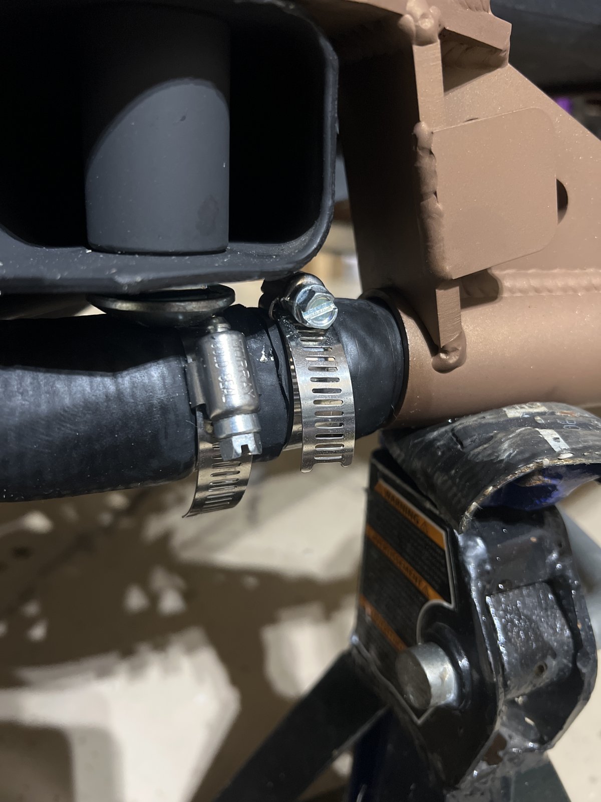

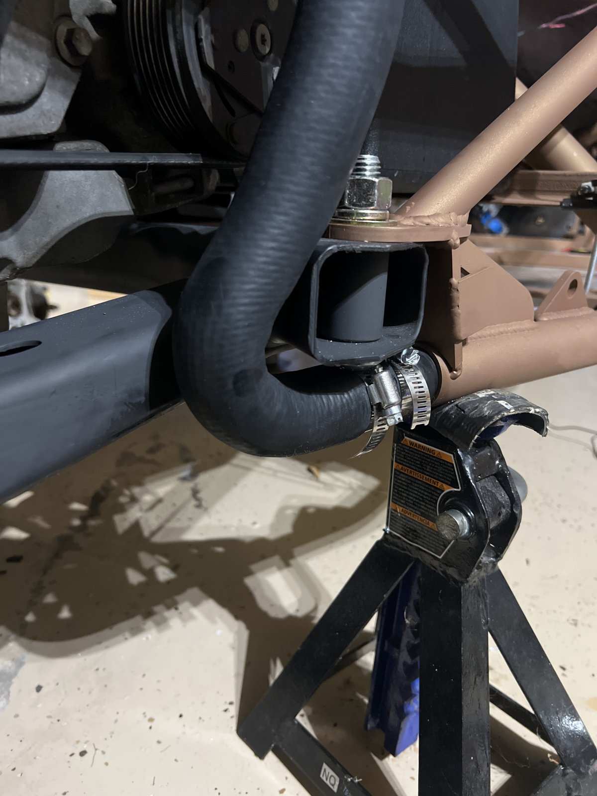

V1 Coolant hose leak at frame
Apparently I pinched the coolant hose on the passenger side rear that runs in the frame. Went to install the subframe and the coupling pinch the hose against the frame causing a leak. What are my options here? I’m sure I’m going to have to replace the whole hose, but for pulling a new one with the motor on is it possible to do or do I have to remove everything and start over? Also what hose do I have to buy to place this one. Thanks in advance

Believe that a puller could be improvised to pull a new hose without disassembly. Getting the old hose out maybe more difficult. I'm sure there is some info in the forum about removing a bad hose, I'm not having much luck in my search so far.
These pics show Continental Hy-t heater 1" hose, but any 1" heater hose from your local auto supply store will work. Heat up your garage, and that will help make the hose more flexible.

Someone who drilled into their hose trying to mount the side panels used a come-along to remove the damaged hose.
