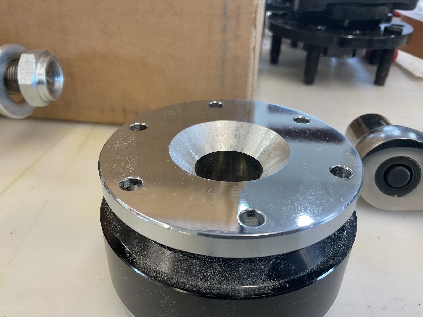

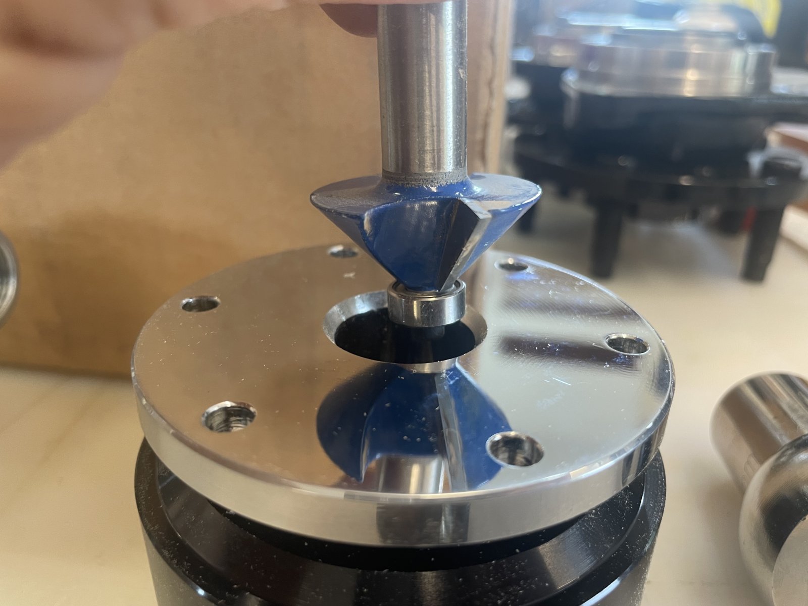

What has anyone done to get this DF Quick release adaptor to mount to the column? the nut doesn't even fit inside , let alone a socket to tighten it .
N
I just used a 45 degree router bit and ran it around the hole and it worked great. Even though the aluminum is soft I still did it in two passes.

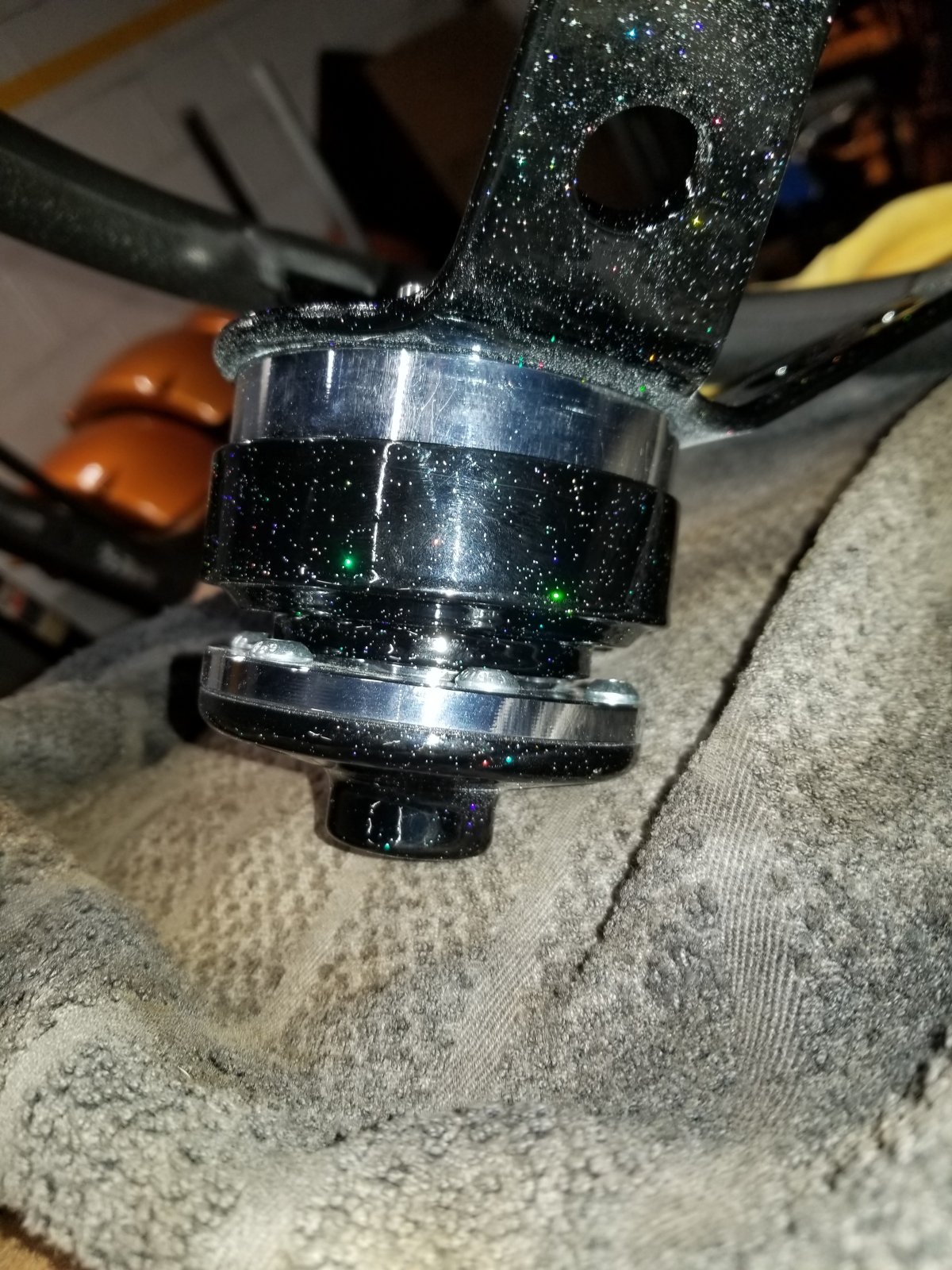

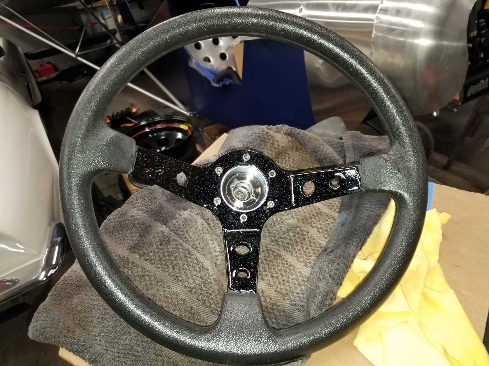

So , I borrowed a 1-1/4" drill bit from work and used it to taper the inner lip of the aluminum hub. Not as beautiful as
Nimrod26's but, the first picture is the hubs bolted together with the hub nut inside there
So , another question ,,,,,, someone here may have a solution for........... What is a good center cap for the steering wheel ?
