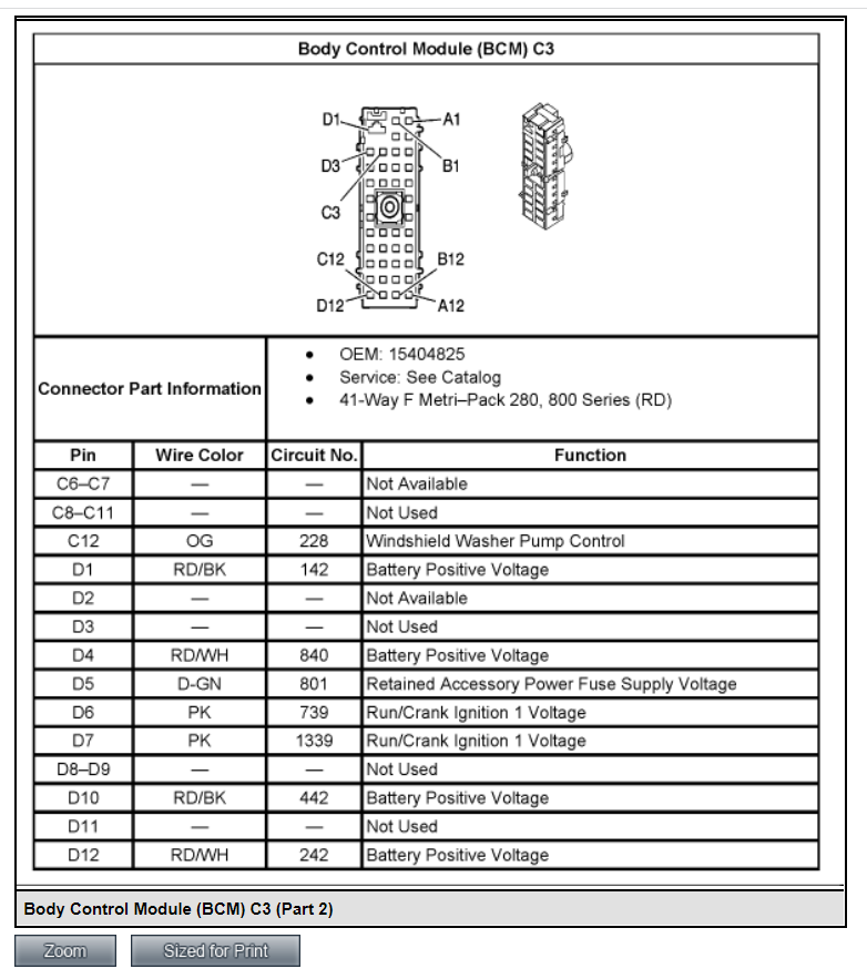

I've been away from my project for a while. Lots of personal stuff going on. Anyway, I'm getting back into my wiring harnesses, and I have no reference for connector positions. For example, where would "D6" be on the red BCM connector, etc? Does anyone have reference pictures for different connectors to show the numbering system(s)? The videos don't show any reference to positions (WTH?) and I need to know for sure that I am at the correct positions before I begin cutting / thinning. Any help is greatly appreciated.
numbers are rows, letters are columns... so D6 is the 4th column and 6 rows down.
If you look real close on the connector, you often can find some of the corners labeled... cast into the plastic.
I use my phone to take close up pictures, and look for the small numbers or letters.
31711
Iwanttogofast
Thanks, Ross!! That's exactly what I was looking for. I've heard that the numbers are cast into the plastic housings on some of them, but I honestly don't see them. I never thought of taking a pic and zooming. Where'd you find that connector position schematic? I'd like to find others like that for the other connectors, like the fuse block connectors. Google searches have not been much help at all. Thanks again, in advance...
