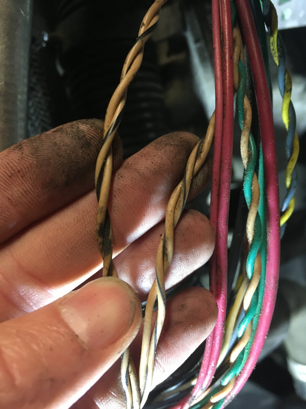

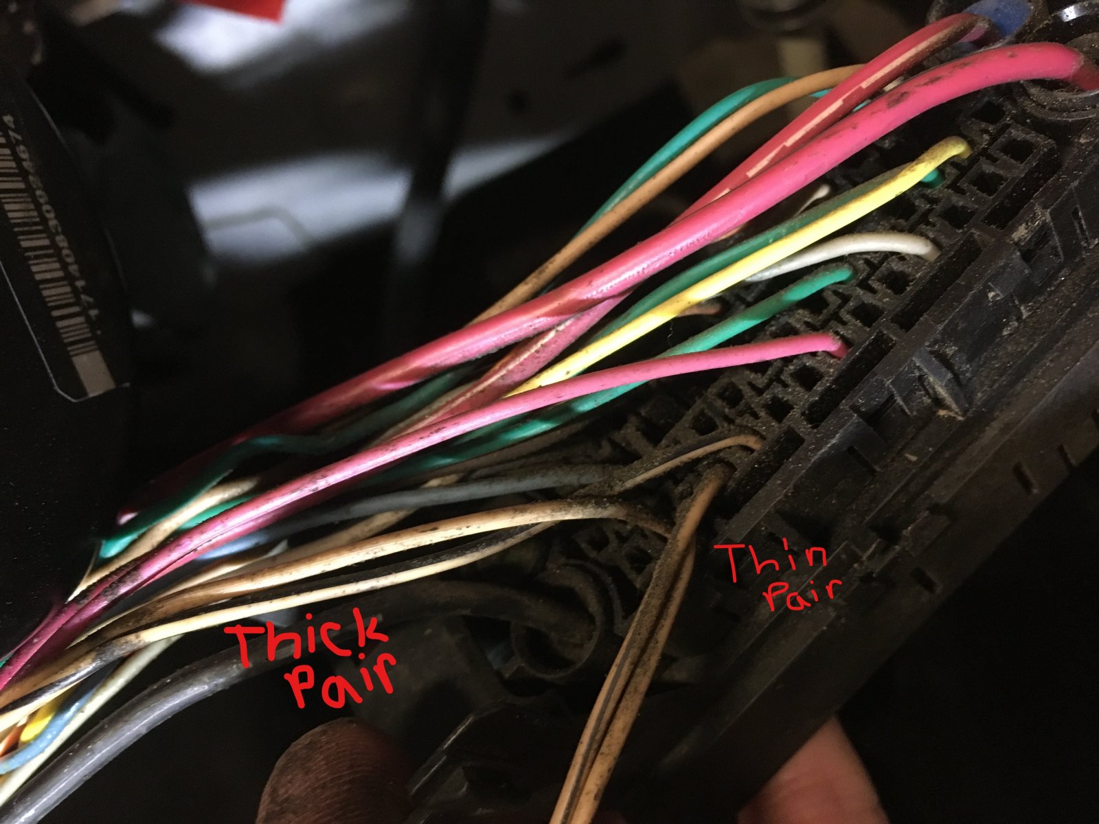

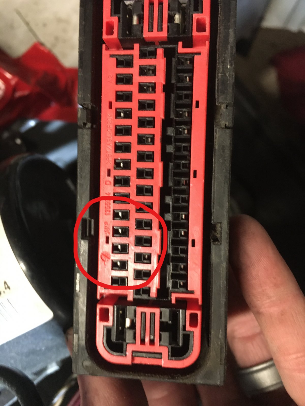

I DO have the CANBUS running through the plug. Two sets actually. One twisted pair with a fat black stripe and one with a thin black stripe on brown. How do you loop them to continue the path? do I just jumper the stripe to stripe and solid to solid? see pics below.

IT RUNS!!! I jumpered the striped and the non striped of the CANBUS twisted pair (With Lonny's help) and she fired right up. Had to shut back down as I don't have the tranny lines connected to a cooler but we did it. Thanks all for your help. Now to drive it around to see if anything else needs repair before the disassembly. Looks like Lonny will get another order soon.
