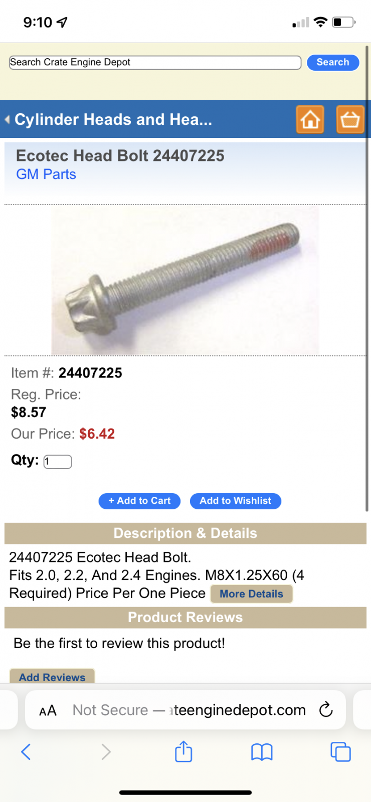

Hey guys have you replaced the following bolts for the head at the cam gears/chain end with ARP bolts? This 12-point bolt is a terrible design.
Ecotec Head Bolt 24407225
I think most built engines run ARP studs that go the whole distance from bottom to top. That’s what I did. Unless this is something different

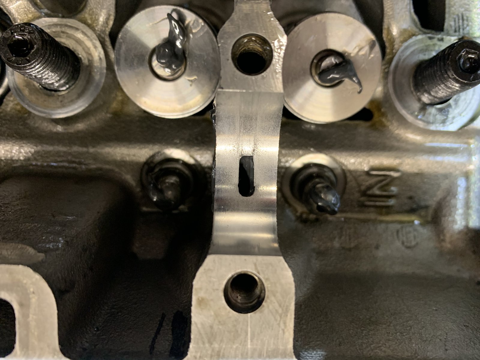

Ok another question just because I’m paranoid with new cams going in.
Are the head journals where the cam sits supposed to have a polished like texture like a crank bearing? My old cams feel smooth but I noticed that the head journals are not polished.
