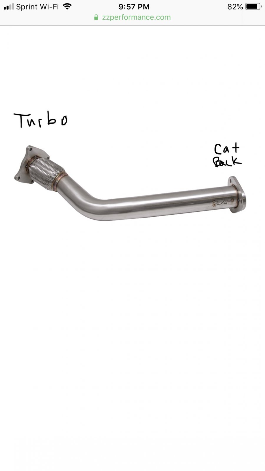

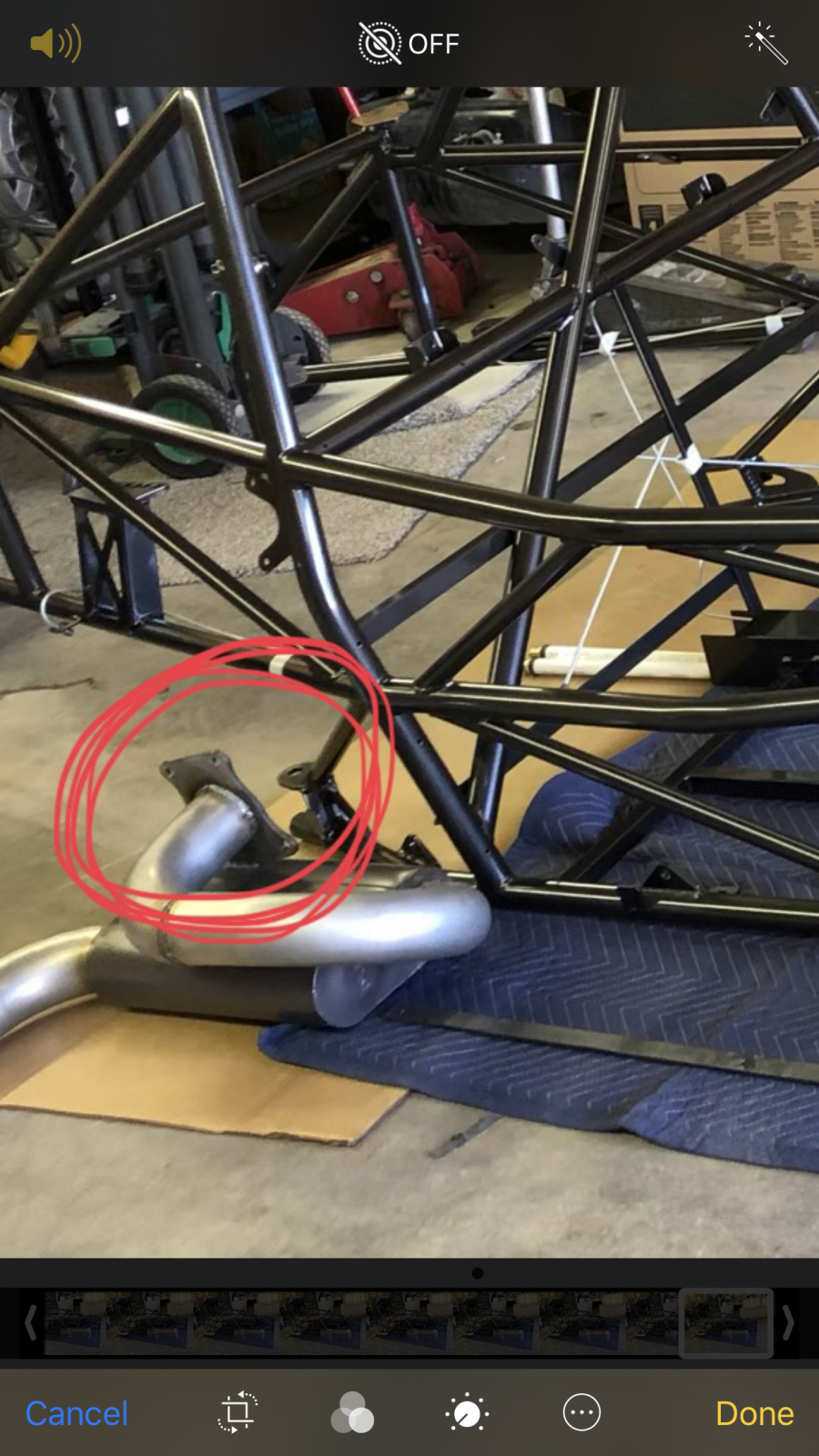

Is there a gasket that goes between the turbo header and the DF exhaust, or does it just butt up against it?

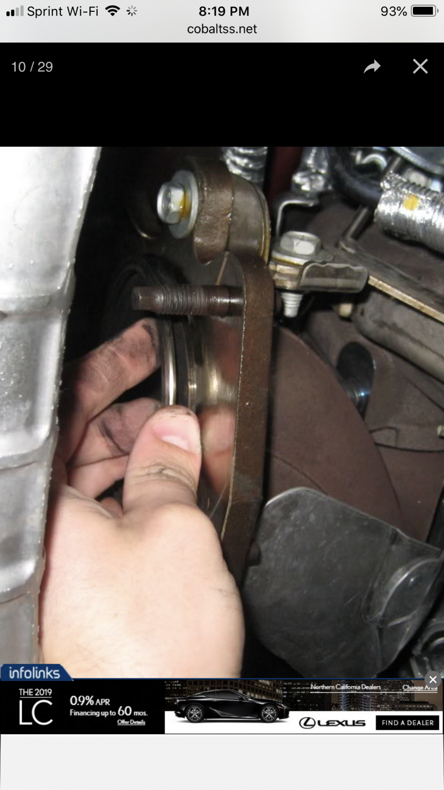

There will be small circle exhaust gasket that you can reuse. Most likely it’s still attached to your turbo side. Mine was.. this is the only gasket you need
Christopher Sanchez
The o ring type.. the other downpipe gasket is not the correct bolt pattern from the O2 housing to the DF exhaust. The turbo exhaust has a 4 bolt pattern
