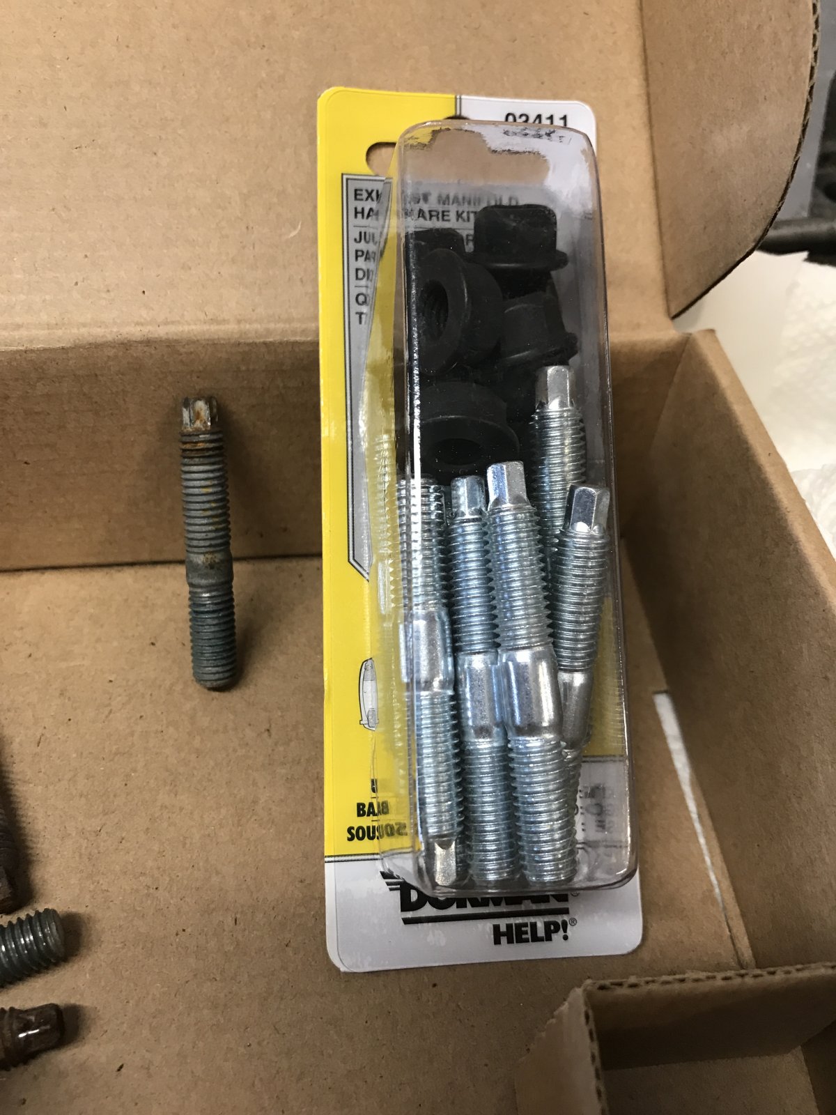

Tim Moland
Keep in mind, my donor was a 2010 ss/tc. Yours looks to be a SC, so it might be different. I had to replace an exhaust stud on mine. This is what I got at autozone.

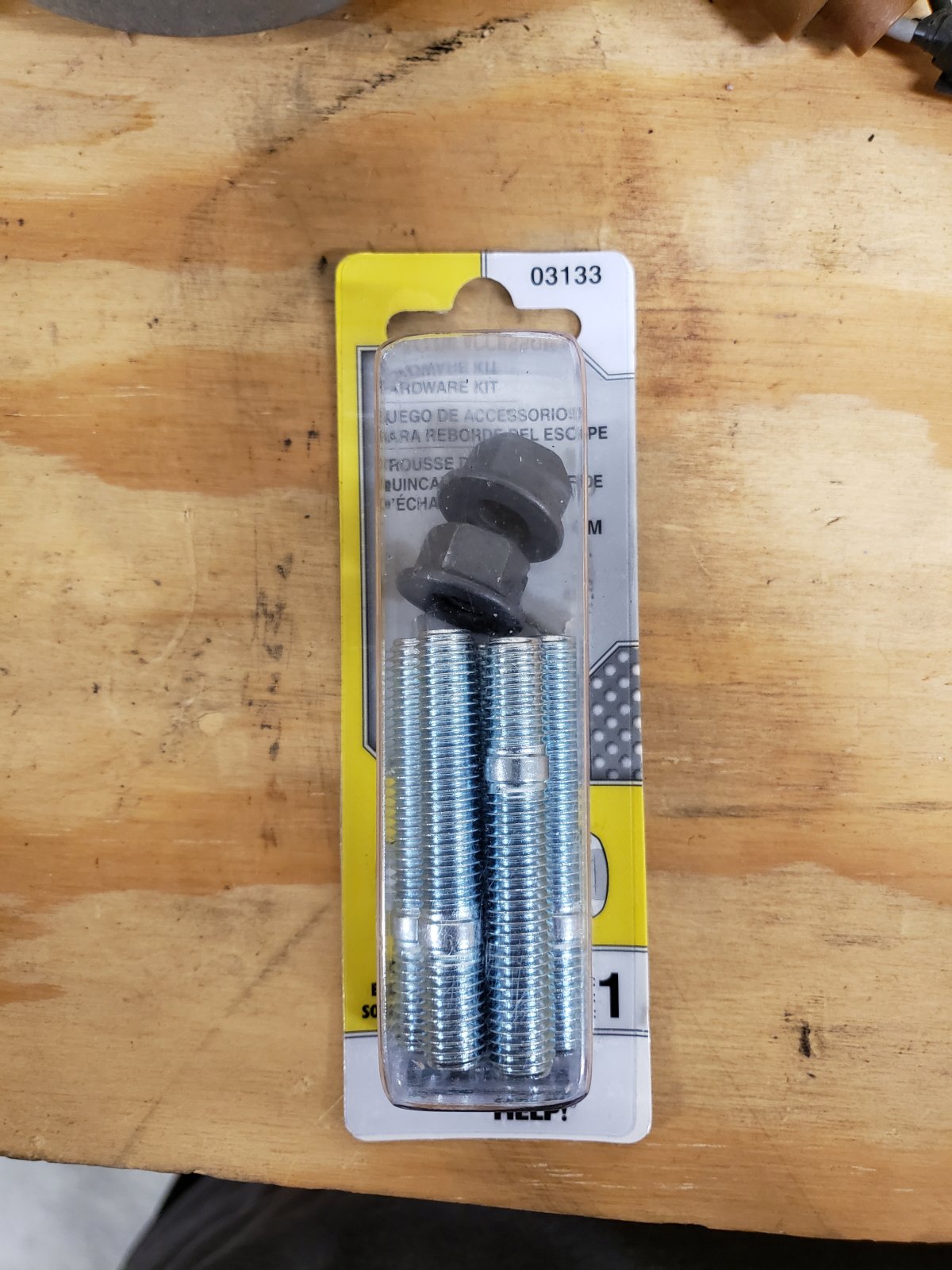

JeffsGoblin
k.rollin was correct... they are 8M x 1.25 for the LSJ. I picked up the following at Advance Auto for $7.99. They are slightly longer, but a test fit proved them to work as needed for latching down the ZZP shorty header, plus there are 10 in the box which is what the LSJ calls for. I only had seven originals:
8719
BaltimoreHokie
Same one I have used....No issues yet. Also about 5x cheaper then the ZZP / Equiv purchase.
