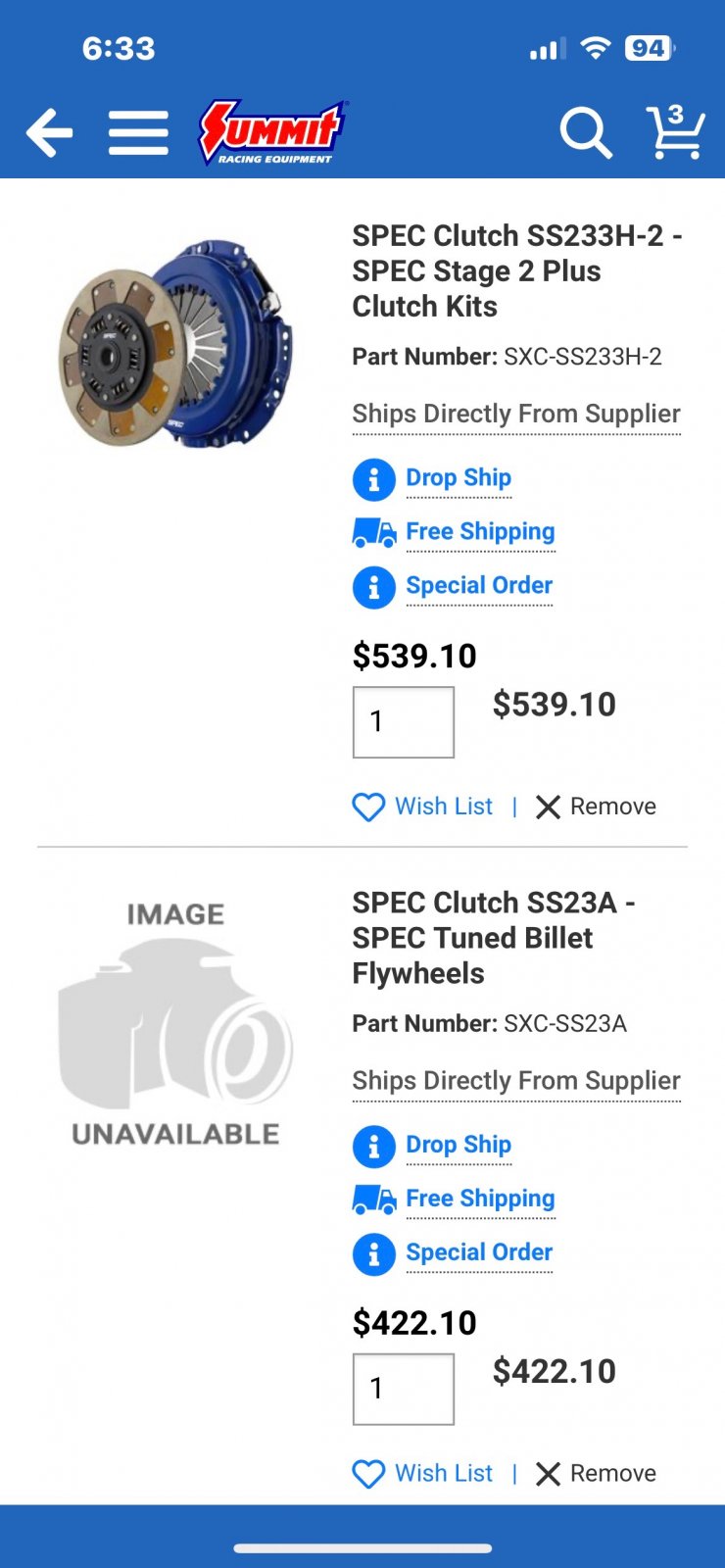

Ended up ordering SPEC. Ive had good experiences with them in my rwd Ford products before. Spoke with them on the phone and explained what Im basically looking for is a 400hp/400tq on a 1900lb with driver setup and they set a 2+ stage setup would be plenty. A stage 3 would be a carbon disc and would be grabby. I still want my fiance' to be able to drive it and have fun yet too, so we went with the Kevlar disc of a 2+
