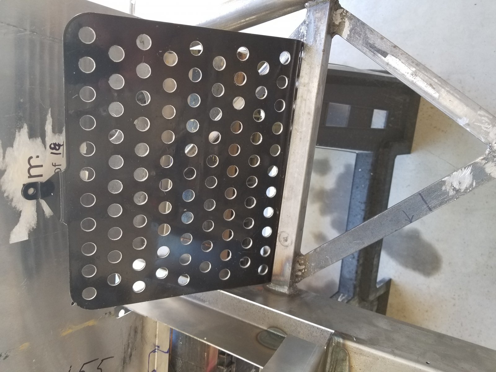

That heavy kick plate? How about an alternative way to make it 'grippy', Racer X cool looking and 30% lighter. And you can do whatever finish you like.:cool: Sorry, couldn't resist. :p
k.rollin
I resisted finishing mine for a long time because I wanted to use dimple dies for grip, but couldn't justify the expense of the tools necessary.

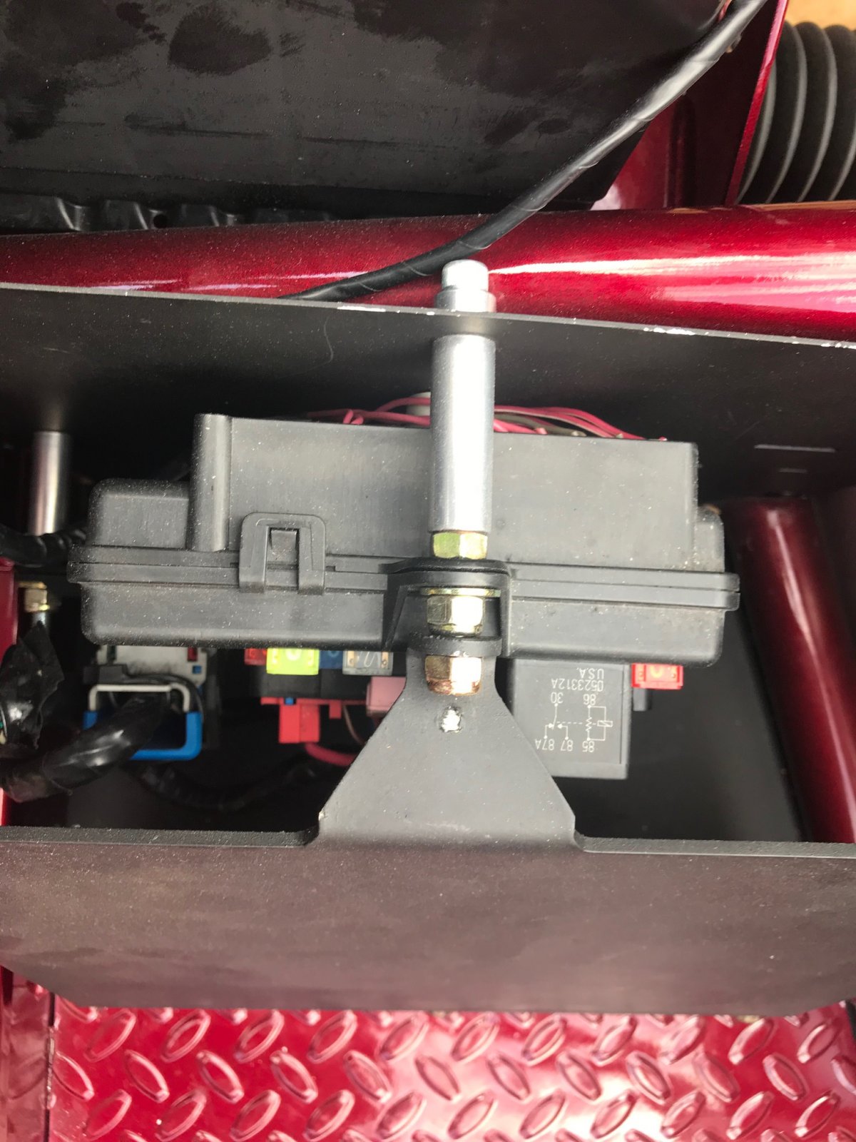

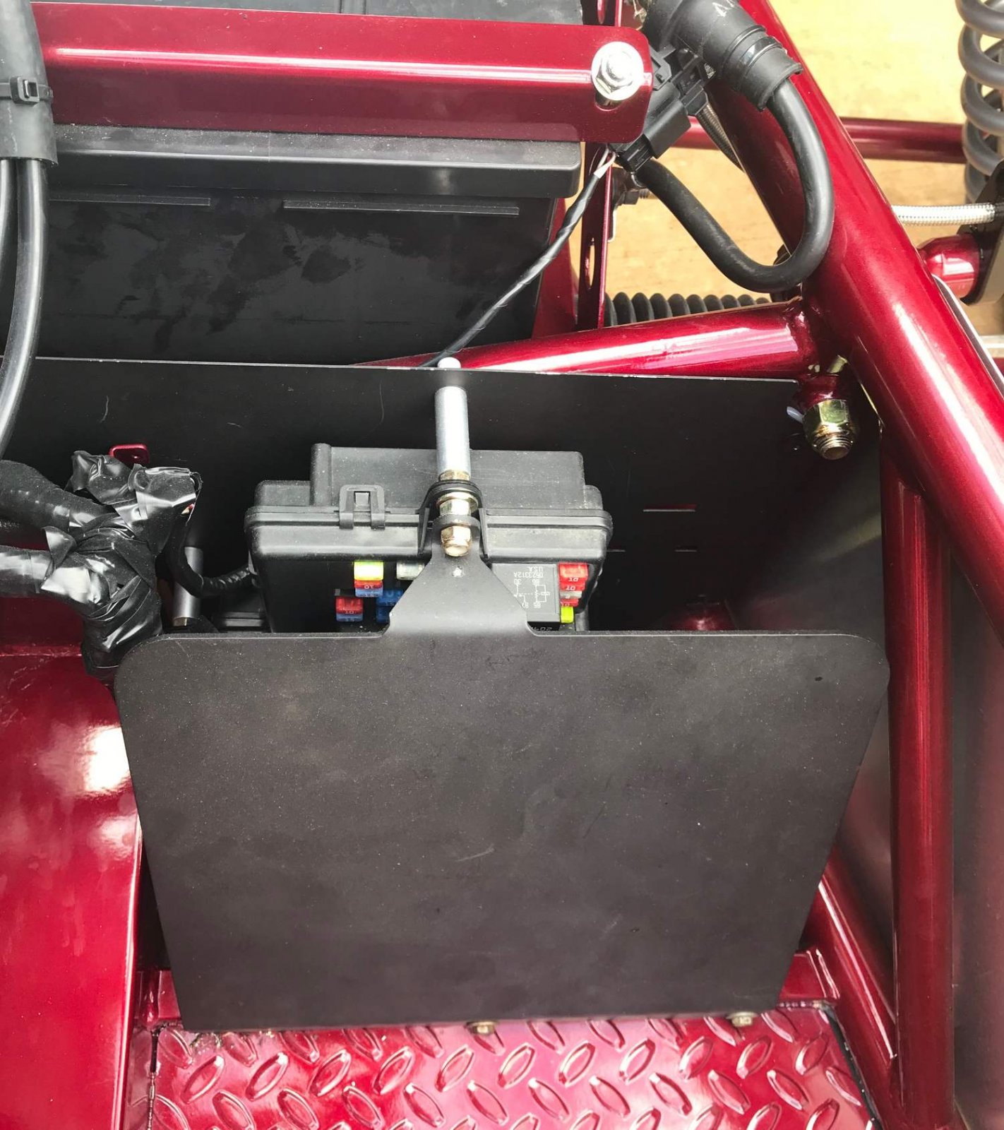

CaptFrank2001
This is how I did it. As we say in the Navy .... "Works fine, fail-safe & drains to the bilge"
Don't look at the crappy tape job. I fixed that.
