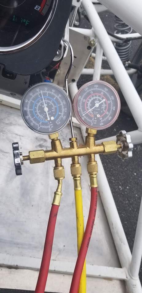

The fuel rail had the same thread as my AC gauges, so I looped my red hose to plug the extra 2 ports, and put the yellow hose on the fuel rail.

Here I did a 2nd gear WOT pull, and the fuel pressure went from 64PSI to 60PSI, with the stock LSJ fuel pump, stock 32lb/hr injectors.

Pretty neat idea there. I have a set of A/C gauges and never even thought of use them to check pressure. I should set them up just to check the inline gauge accuracy.
That drop I would think could be expected. I doubt that will cause much of an issue as the tuning can adjust for the small drop in fuel delivery.
64 PSI is a bit high for a 4 bar (58 PSI) system, but I doubt any donor car was spot on with just a spring and ball regulator.
