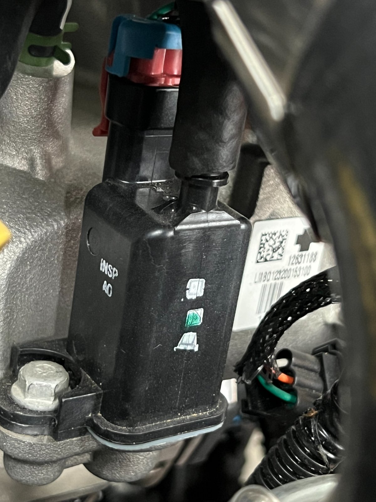

Is this a rollover valve? This is what the vent line runs into. It's mounted on the intake and looks like it runs into the intake. This looks to be a bit more sophisticated than just a check valve of sorts

After following the current vent hose up under the intercooler, it appears to be plugged into this device mounted directly on the intake manifold. Any idea what this is? What would happen if I bypassed it? Wondering if this is a specific requirement for the LNF setup?

That's EVAP related and you no longer use it for the goblin. I believe some people unplug it, some people leave it plugged in, but I think the consensus is to leave it unplugged. I removed mine and installed a blanking plate, and tied off the harness plug. You aren't supposed to run the fuel tank to it as that would apply engine vacuum to the tank whenever that valve actuates. This would explain your issue... are you sure the noise you heard was pressure and not vacuum? I'm honestly pretty impressed with the tank holding up... I had this issue happen once on a BMW and it sucked the entire tank into a pancake, until the car stalled because it was crushing the fuel pump.
LNF with the evap solenoid unplugged will cause the car to not use long term trims on fueling. Not necessarily a bad thing, since the calculation is so basic it’s hard to say it’s useful.
