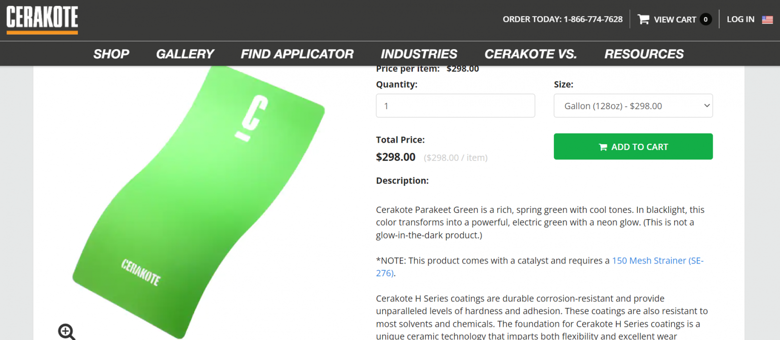

The Cerakote option is interesting, but you'll need access to a large oven to cure it. Powdercoating is probably the best option but prices can vary significantly from less than $1000 to more than $2000. Paint is the most economical.
What is your end goal? Show car quality? Durability? Spend time instead of money? Listing your goals should help you narrow down your options to what is best for you.

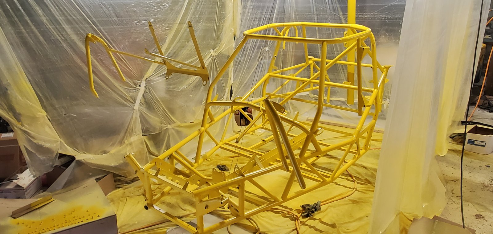

I personally chose to paint over powder coat, I had the frame professionally sand blasted and bought a cheap "touch up" spray gun from harbor freight. https://www.harborfreight.com/120cc-hvlp-touch-up-air-spray-gun-61473.html
It worked great, I sprayed rust oleum from Menard's because its cheap and easy to find
I used bare metal primer first 2 coats, then ford tractor blue implement paint because it will never not be available in some form or another.
I followed the mfg instructions to thin for spraying and used a home made air dryer made from copper pipe ( https://7echocharlie.com/shop-setup-air-compressor-and-dryer/ ). I'm pleased with the results and the color exactly matches the same paint available in rattle cans, just much much cheaper to buy by the gallon. Rattle cans are super convenient for touch ups, just grab a cardboard scrap to catch overspray and shoot where you need to... I am glad I went this route because I am now ordering the halo from DF to convert my car to a full cage/track frame with added reinforcements.
