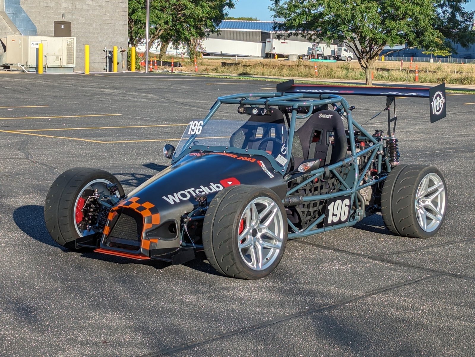

Tell us about your build. (who did you build it with? where did you build it?)
Me and a couple friends put the whole thing together in about 3 days in my garage. We had everything ready to go when the kit arrived. When we got home from DF headquarters with the frame I immediately took it to a buddy to have modifications welded on and then dropped it off at powder coat. We got the frame back from powder coat a week after picking it up on a Thursday and it was ready to drive, minus one wire issue and backordered seats, on Sunday.
44670

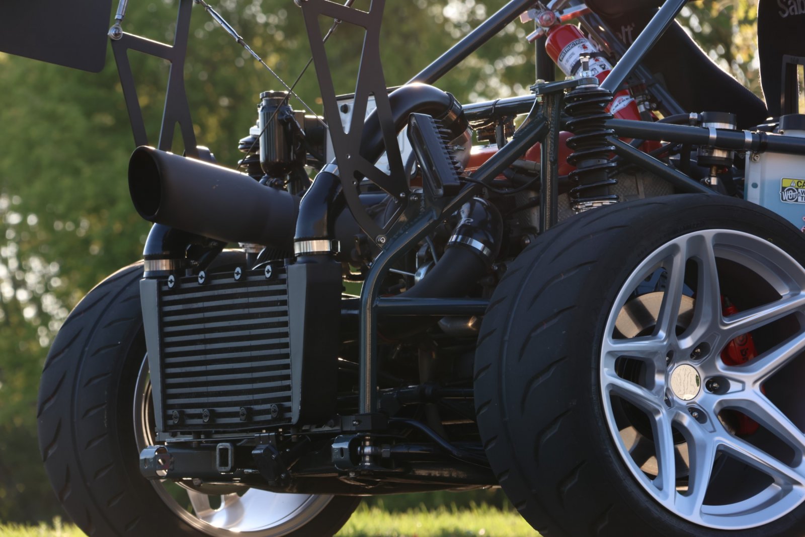

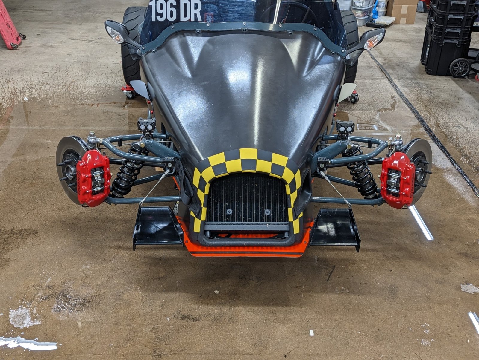

What, if anything, have you modified on your Goblin that sets it apart from others?

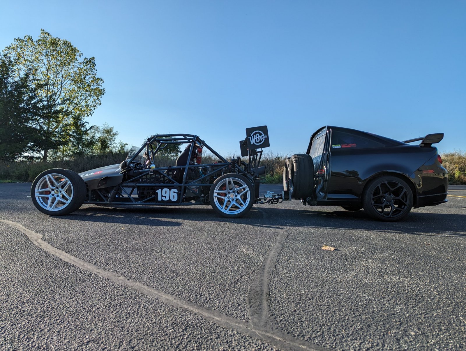

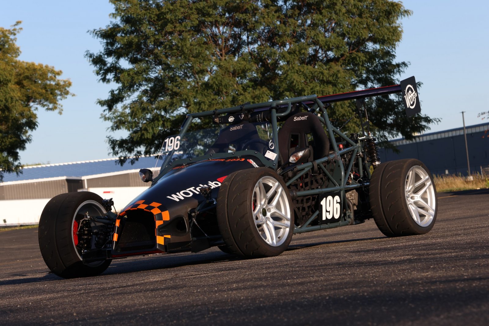

My favorite mod is running coolant through the frame tube instead of pulling a hose through it. Other than that probably the Brembo brakes, rear intercooler setup, and the massive diesel exhaust tip! Oh, and the trailer hitch!

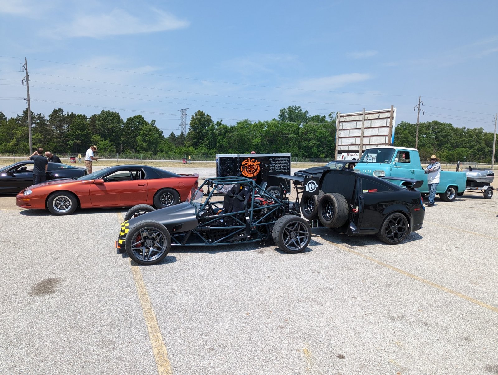

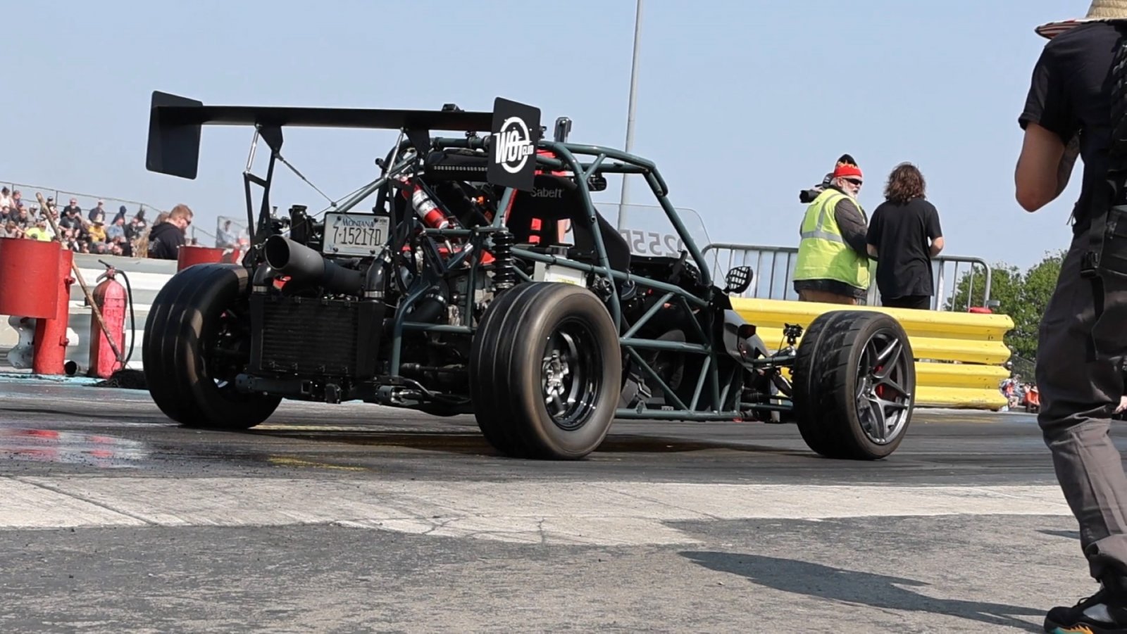

Do you have any memorable road trips, races or events you've attended in your Goblin?

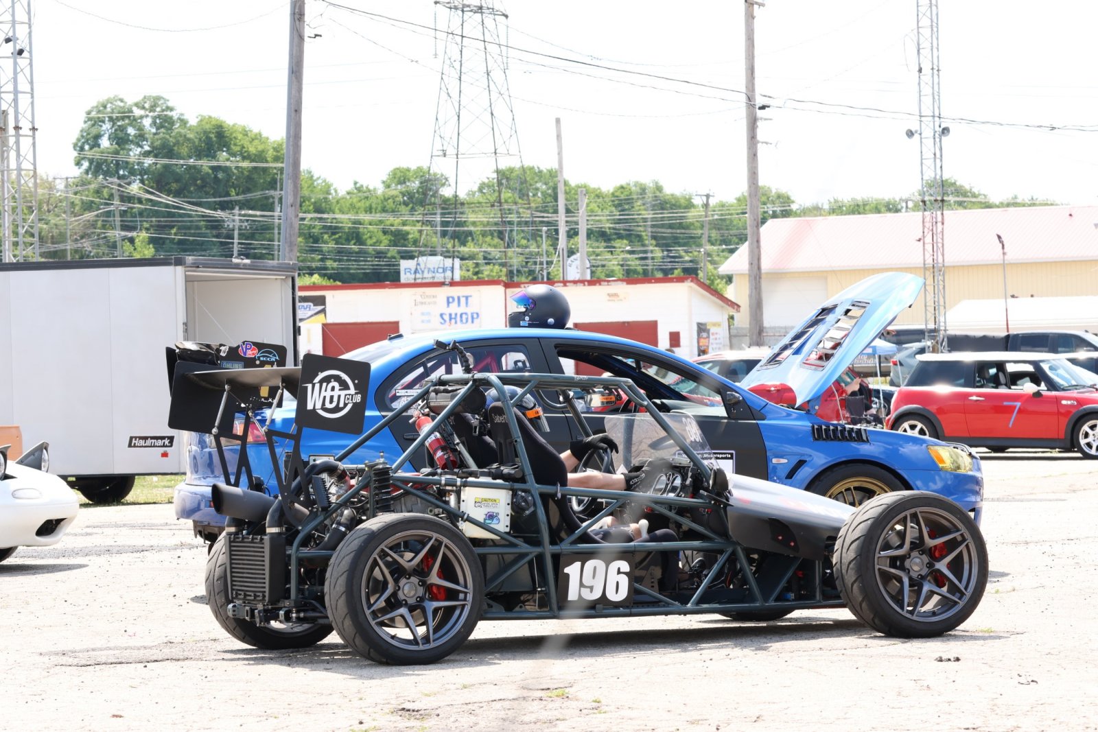

This past year we used the Goblin to participate in a week long drag-n-drive event called Sick Summer. We put about 1000 miles on the car and raced at 5 drag strips that week. Other than that I've done a whole bunch of local autocrosses and track days.

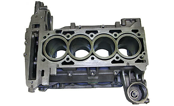

Radiator coolant is formulated to inhibit corrosion with iron/steel, as it is used in engine blocks and heads. The Ecotec iron sleeve in the engine blocks we use is directly in contact with the radiator fluid. There will always be some corrosion, but it should create an oxidizing layer on the inside surface of the frame tube and that should be the extent of rust generated in the cooling system, as long as the correct mix of radiator coolant is maintained.
The is coolant around the cylinder sleeves in the engine block - which is completely separate from the coolant circuit in the cylinder head. In the attached pic, the gap around the cylinder liner is a coolant passage that surrounds (mostly) the iron cylinder sleeves.

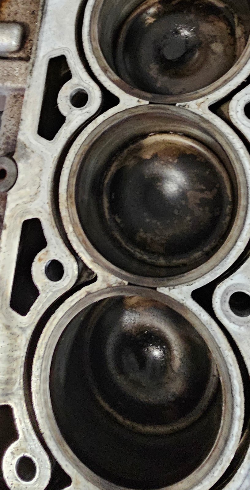

Where would that be? I had the head off my LSJ and the steel sleeves sitting in aluminum and don't have direct contact to the coolant. At least what I saw from the top. May have a picture somewhere.
Same for an LNF, iron sleeves press fit into aluminum. Water jacket is around the aluminum but I don't believe coolant ever comes in direct contact with the sleeve. But to DS's point, any notable amount of antifreeze would prevent damage from corrosion. Otherwise, older iron blocks/heads would have lots of issues.

Attached is a picture of my LSJ. The water is not in contact with the metal at least what I can see from the top. Not sure how it looks like if you take the block off.

Antifreeze is a corrosion inhibitor for both iron/steel and aluminum. As others have stated the general principle is the same whether the coolant comes in contact with the liners or not. Sometimes people take short cuts with their explanations or take the time to think through the details of general principle to actual examples.
