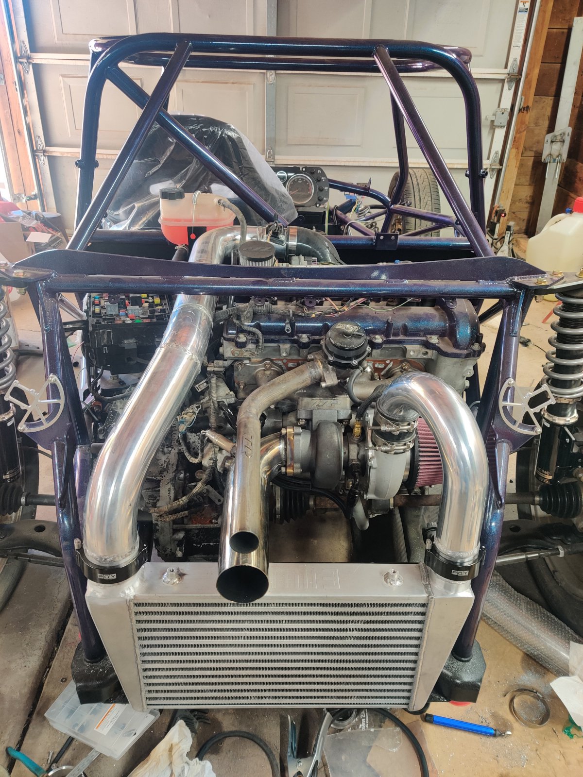

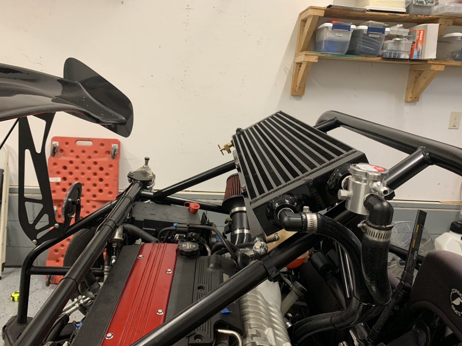

I'm a tad late here but here's my take on the intercooler setup, while it's not an LSJ it conveys the point quite well and has absolutely zero effect on rearward vision, I haven't made more than 6-8psi yet but it's within a few degrees of ambient without any fans or anything
Which intercooler is this, and could you share a few more pictures of the clamp mounts?
Cnixon160

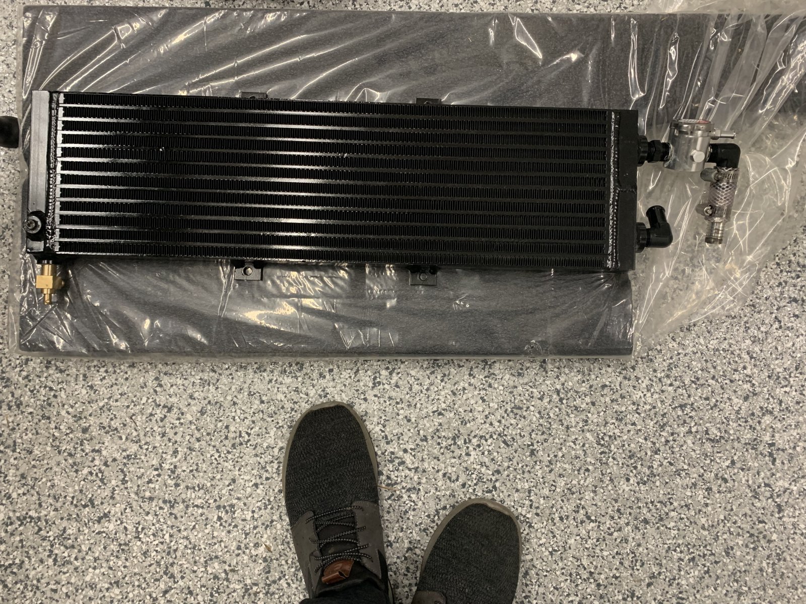

Here is the intercooler

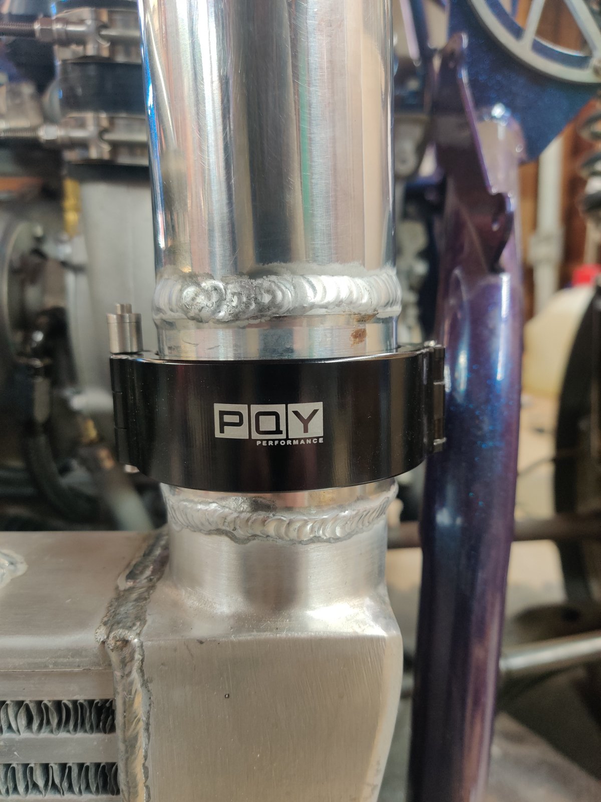

Here are the clamps, the turbos side is 2.5" and the outlet to the engine is 3"
I used a strip of 1x¼ steel for the mount and made it flush with the radius on the rear of the factory subframe

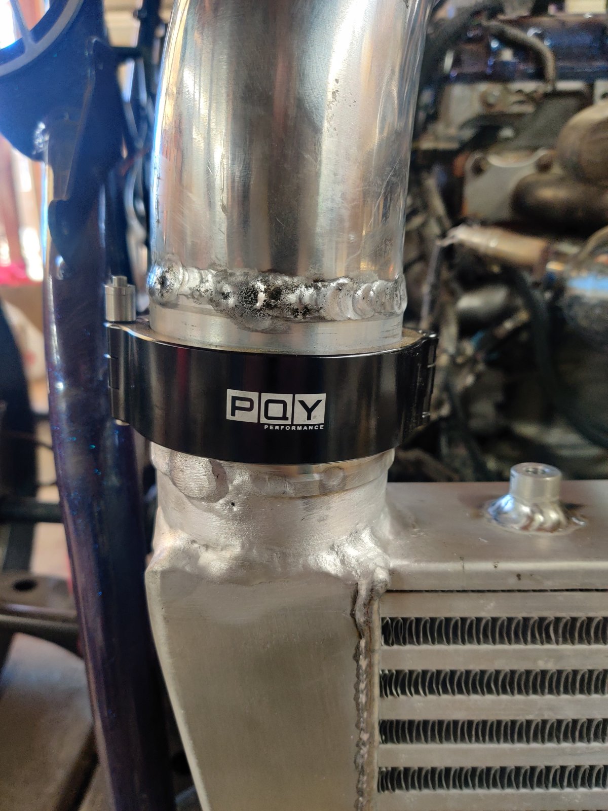

Here are a few more pics of the clamps, take it easy on the welds this was the first time I have ever done aluminum, they have a nice O-ring seal and will easily hold much more boost than I will ever make
How well does air actually flow to that intercooler tho?
