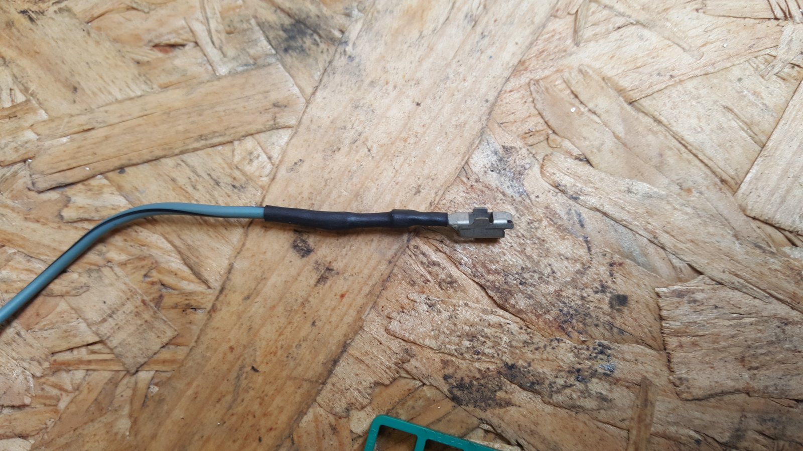

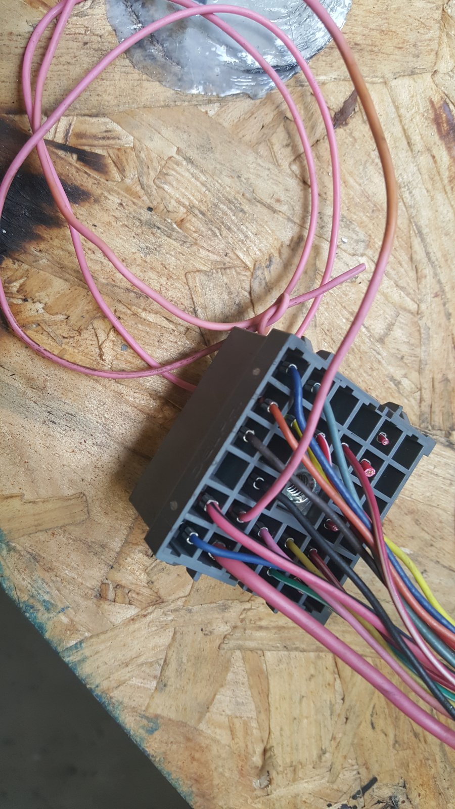

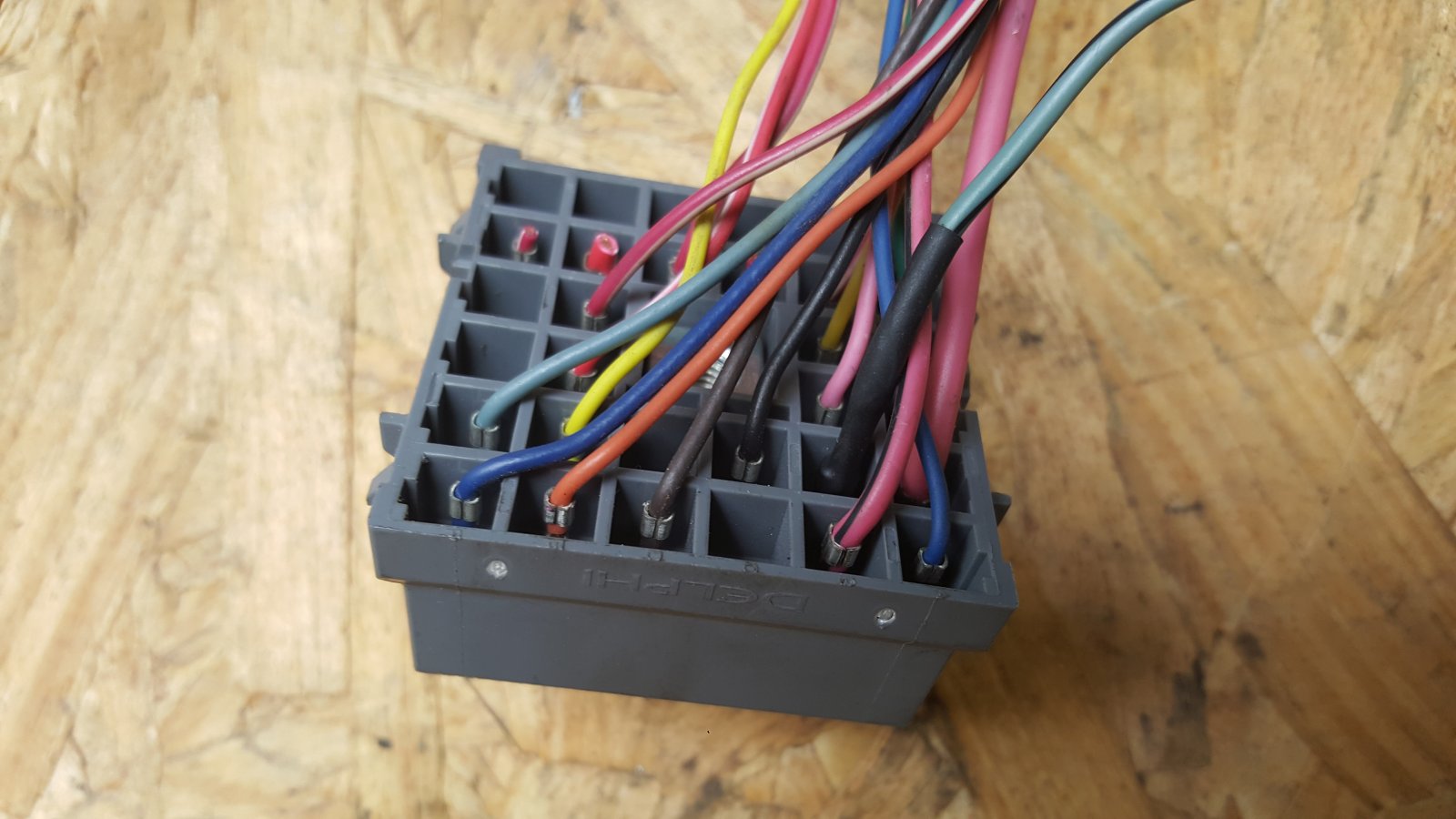

Locate pin B2 in the gray fuse block plug. It will have a short pink wire attached. Attach a six foot length of wire to this pin.
The other end will go to your Bosch water pump.
