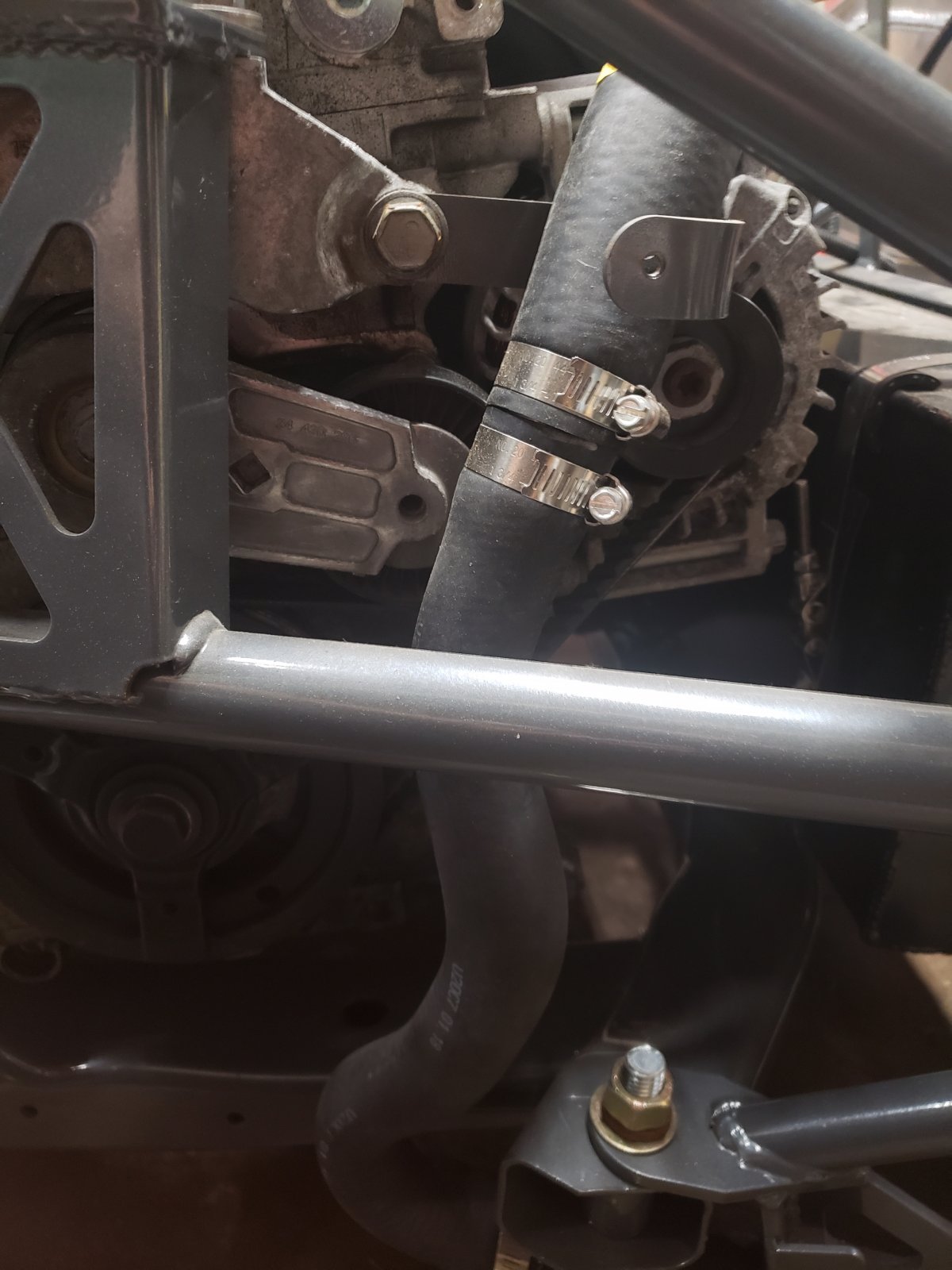

Is this where this goes?

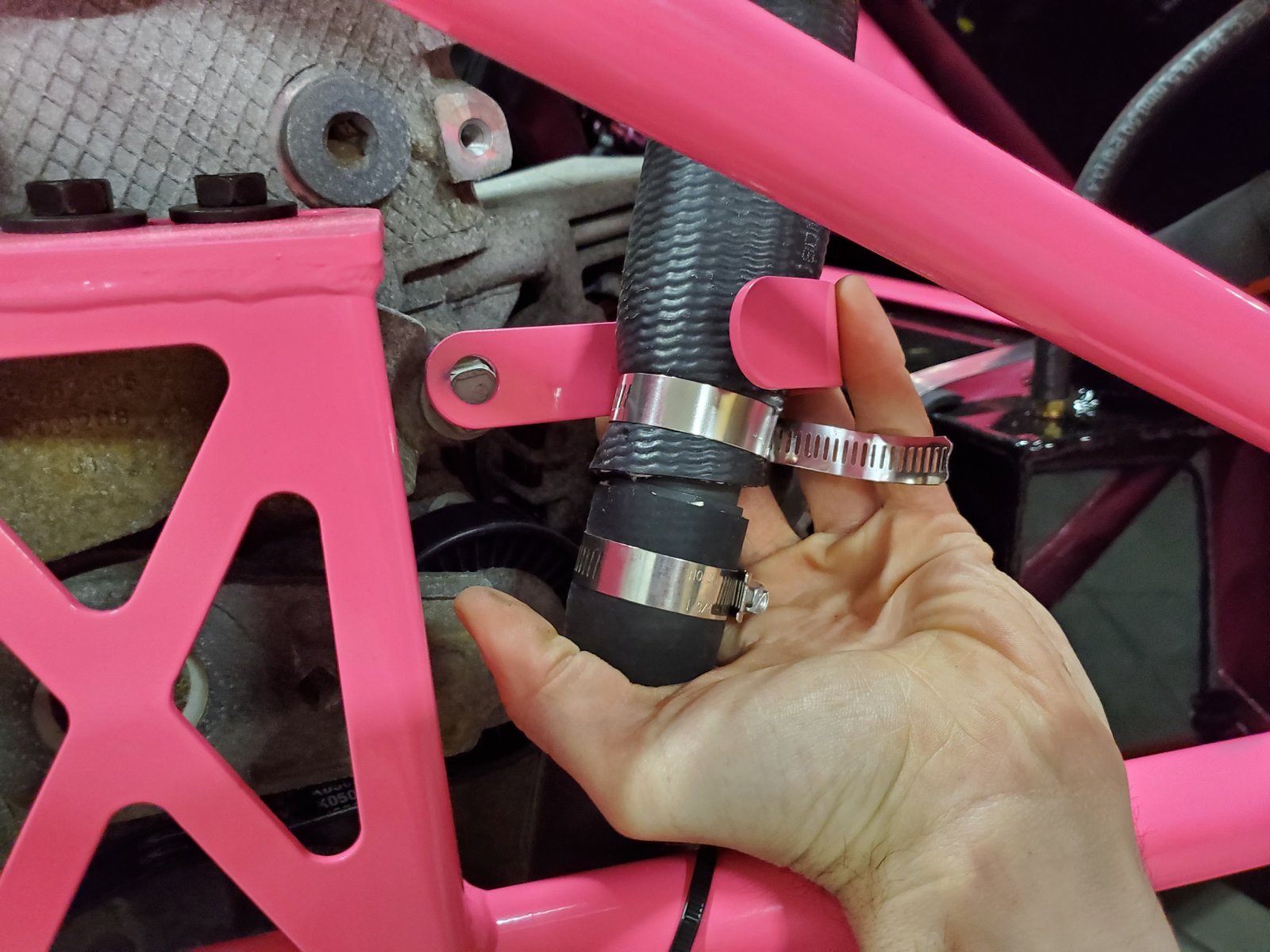

I've never seen that metal hook... must be new, or part of a different kit than mine.
k.rollin
Can confirm, that's where I've got mine bolted up to prevent fouling with the alternator pulley.

For future searchability, the steel J hook goes on the passenger motor mount front bolt to hold the upper radiator hose away from the alternator pulley.
