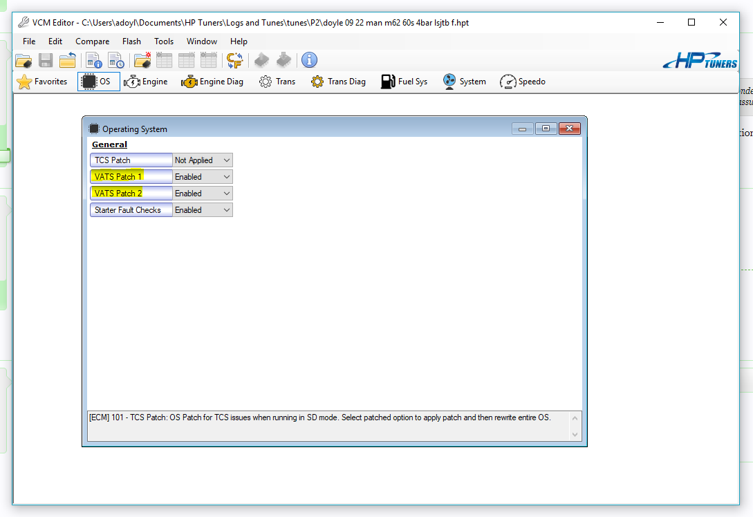

I just checked and it looks like there is a way to disable VATS with HP Tuners (at least on my 09 LS file).
I didn't know about that. Thanks for the info.

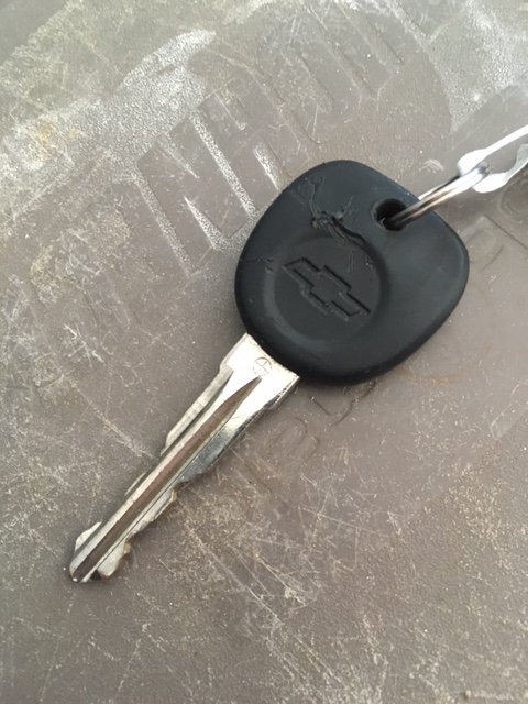

So there is VATS in this?:

You can purchase keys online with the chips in them. Get the key cut to operate the mechanical switch. Use a door lock if necessary. Then you can get the ECM to read the new key - a 30 minute procedure. That key is then the "master". The procedure erases all previous keys from the ECM. With the new master key you can have the ECM learn up to 9 more keys. I have done this on my car. I wrote up something on this on the forum.
VATS stands for Vehicle Anti-Theft System. The transponder located inside the key is one component of the vehicle theft deterrent system. You can tell you have a transponder key by the circled + sign towards the top of the actual key part.
I see that now. Thanks for the info. I would not have guessed it was in there.
This is the IT guy in me asking, but will disabling a couple of items labeled "patch" disable the entire underlying functionality? When I think of "patch", I think of something that sits on top of something else to modify its behavior.
