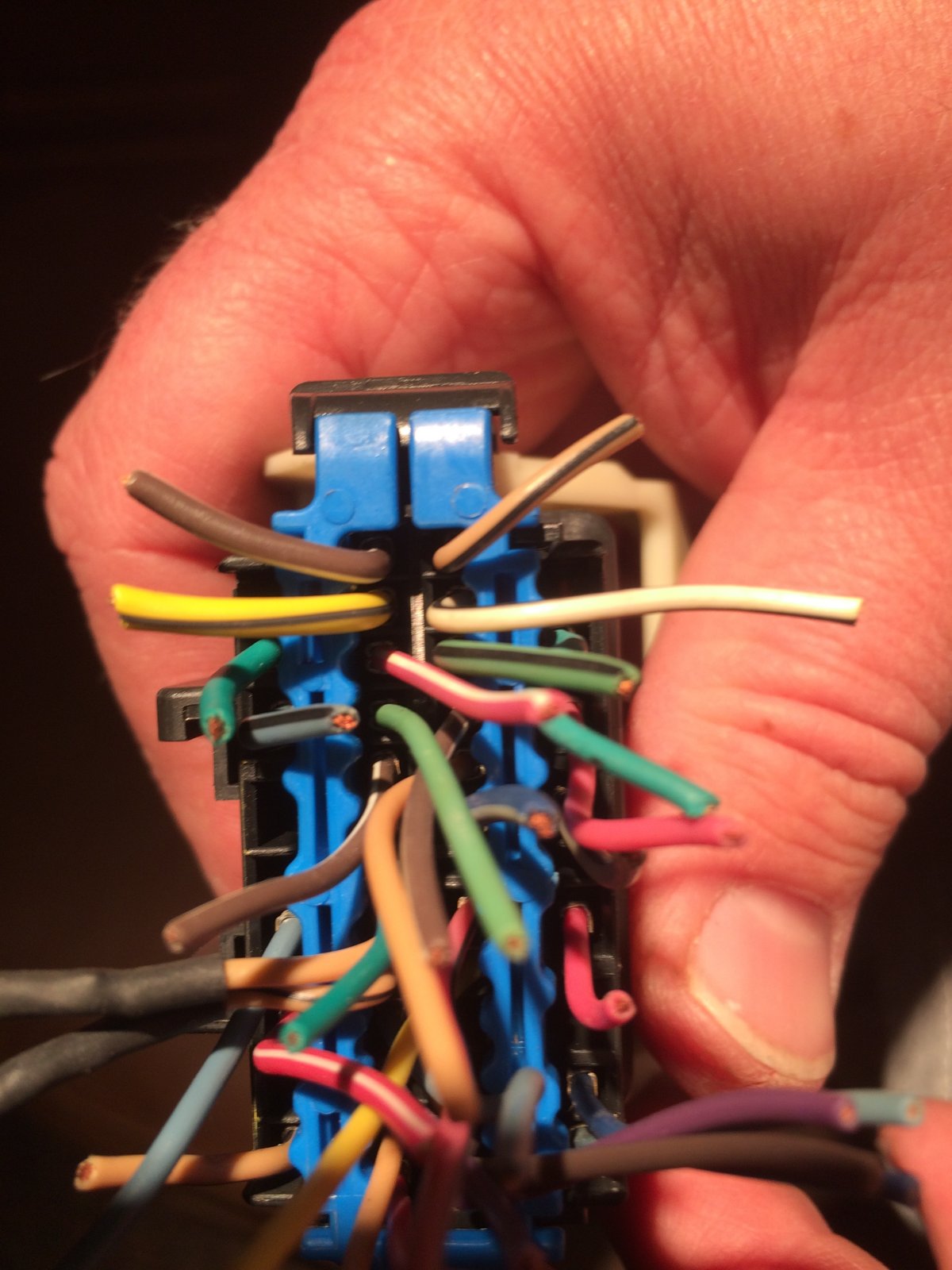

I cut but didn't remove a larger heavy gauge wire that is yellow w/black tracer from the BCM plug. I cannot remember why I didn't remove it. Now I cannot find it in the videos or any reference to it.

Can you post a pic of the connector? It must be specific to your model as I don't seem to have any heavy gauge wires of that color. I do have a few of that color but they're for things like low reference, turn signal, etc.
I thought it went to the BCM, but actually it went to the blue dash connector. It's the wire on the top left, second one down. Still looking for that connector in the diagrams. Since this connector was cut out and the rest of the wires extended, whatever this came from might be long gone.

I believe I finally found it! I believe its the left rear speaker (-) (UQ3). It's in the I/P Harness to the Body Harness connector. Pin C11. It changes from a yellow on the one side of the connector to a yellow/black on the other side if you have the UQ3 option and if you don't it's just a yellow wire. For some reason I didn't get this one cut and thought that I needed it for something.
