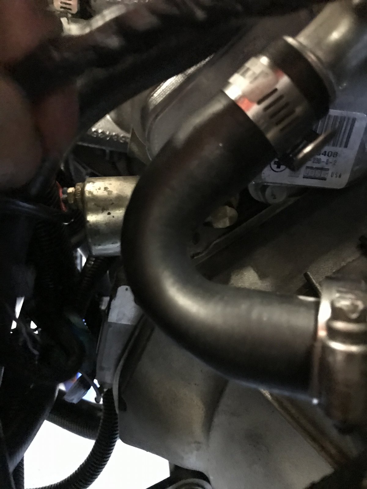

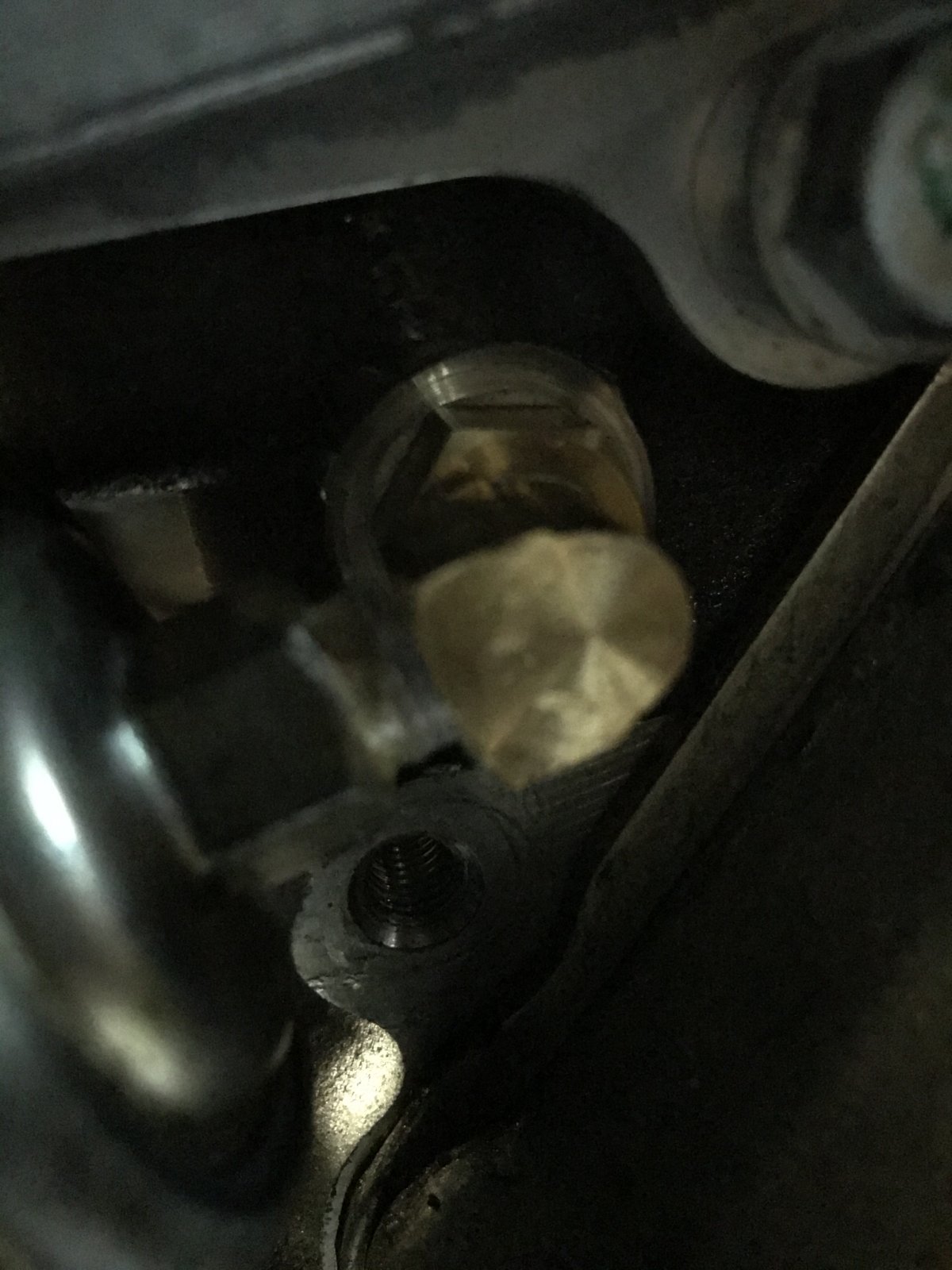

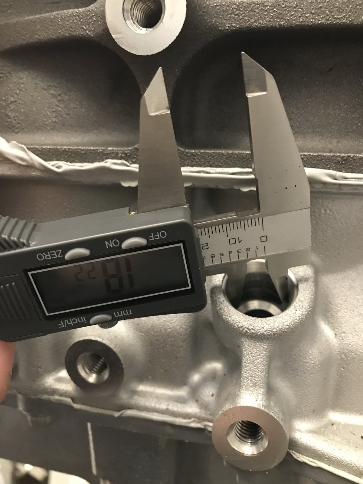

I am going to start my LDK / LSJ build soon as some of you know I had used engine issues and I have decided I’m just going to build it correct with a new block. I have to pull the main girdle and swap the crank reluctor wheel so I need to cap off this turbo oil feed since I’m going supercharged. The hole is a little over 18mm what do you all think? I have contemplated putting my oil pressure sender in that location. Funny thing is out of all things I have done threading bolt holes is not one. I will update this thread to include my build process.
l
looking for options here guys I originally went with a 3/4 expansion rubber plug but the other day my father and I were driving and the plug popped out and I had to tow the goblin home. I have a new plug but when heat rises it pushes itself out. I thought about purchasing this lnf return and capping it hopefully it’s the same size as the LDK block.
LNF Turbo Oil Drain Fitting
www.overthetopperformance.com
As you can see this oil return inlet is not on the oil pan otherwise I would pull it off and bring it to a shop to weld a bung on. This is actually on the crank cradle which would require an engine removal and about $100 worth of torque to yield bolts. I wish I would have went with a welded bung but Any ideas would be appreciated so I don’t have to be paranoid driving longer distances.
