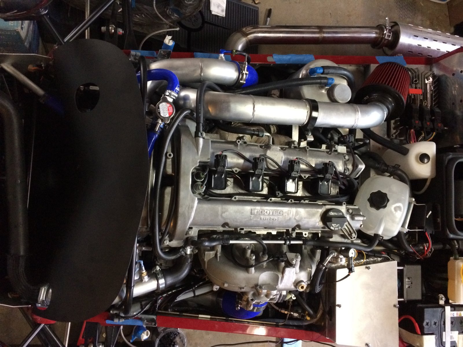

Hello,
I have a semi-new build of a Caterham 7 running an LDK with E39 (LHU) ECM. The car has about 600miles on it now. It's running off the base tune (just modified for standalone). It seems to run just fine, but I need to put it on the Dyno to tune WOT and the external WG. I'm running a GTX2860R on a modified factory manifold.
I'll post some pictures, but I had some questions for this community. Does anyone know a tuner familiar with the E39? I have HPtuners and have done some playing on my own, but it needs an expert.

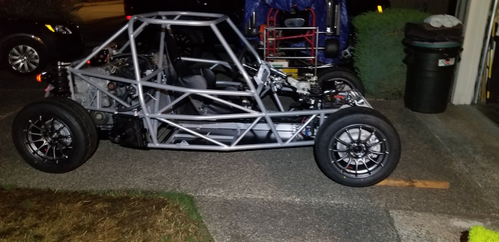

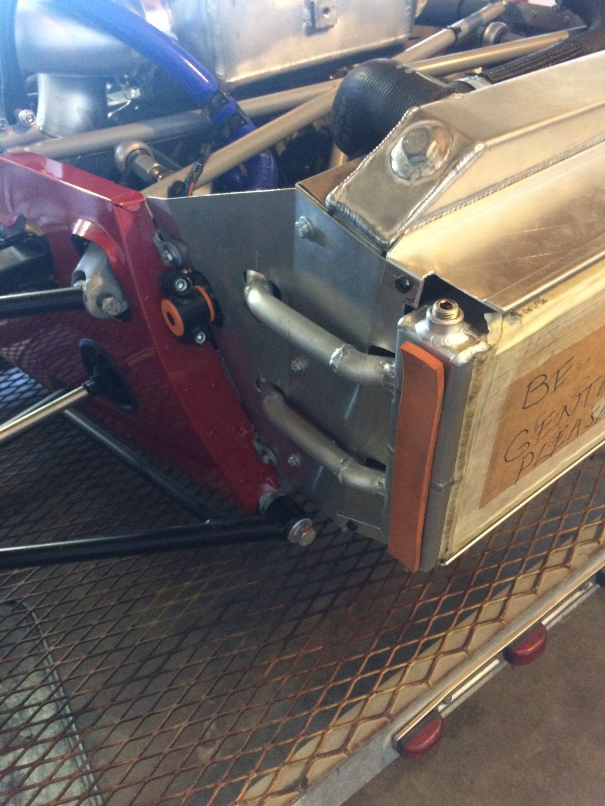

Thanks guys! My radiator is mounted in front of the engine radiator (really the only possible location). The core is 21x8" which was the absolute largest thing I could fit in the nose cone. My end tanks are only 3/4" which helped me avoid having end tanks in front of the engine radiator. I haven't updated my computer with new pics in a while, but I think you can get the idea in the attached pic. The radiator for the intercooler is the part with cardboard taped on the front with welded on tubes running around the main radiator. This does mean everything is aluminum and in contact, but the area of contact is small. There are two puller fans mounted on the back of the engine radiator and this gets vented out through a hole in the hood. You can see a black plastic shroud on the far left of the second picture that guides the air up.

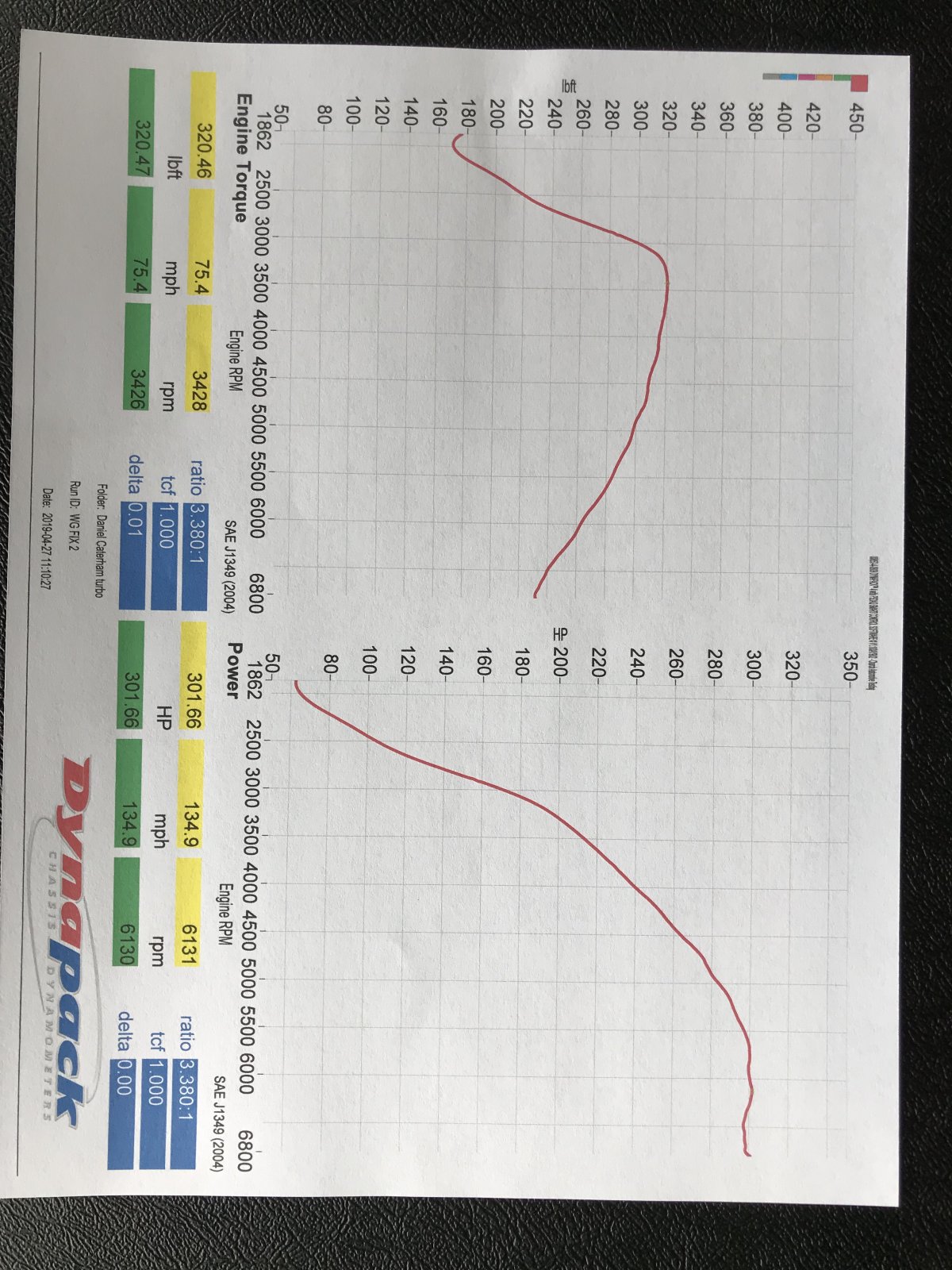

Just thought I would provide an update. It turns out Sean from Church Automotive near Long Beach is familiar with these ECM's and was able to get me tuned on his dyno. I achieved my target of 300hp with 320ft*lbs. I haven't had much time to drive it since, but it's certainly fast. My 245's may not be enough or I might need a button or switch to toggle boost levels. Although the WG spring is only a few pounds less than the 16-17psi that I ended up at. Time to put some more miles on it! Thanks again for the comments and advice. If anyone is in the Socal area I'm ready for some mountain trips!
