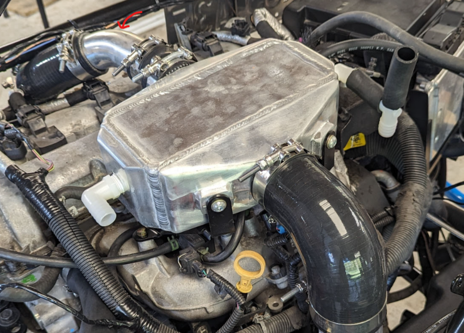

I would agree, I did delete shafts, beefier chain guides, ATI Dampner, Dyemond Fab intake and some additional ARP fasteners so the plan was to retune it in hopes a better intake airflow and possibly a little more HP.

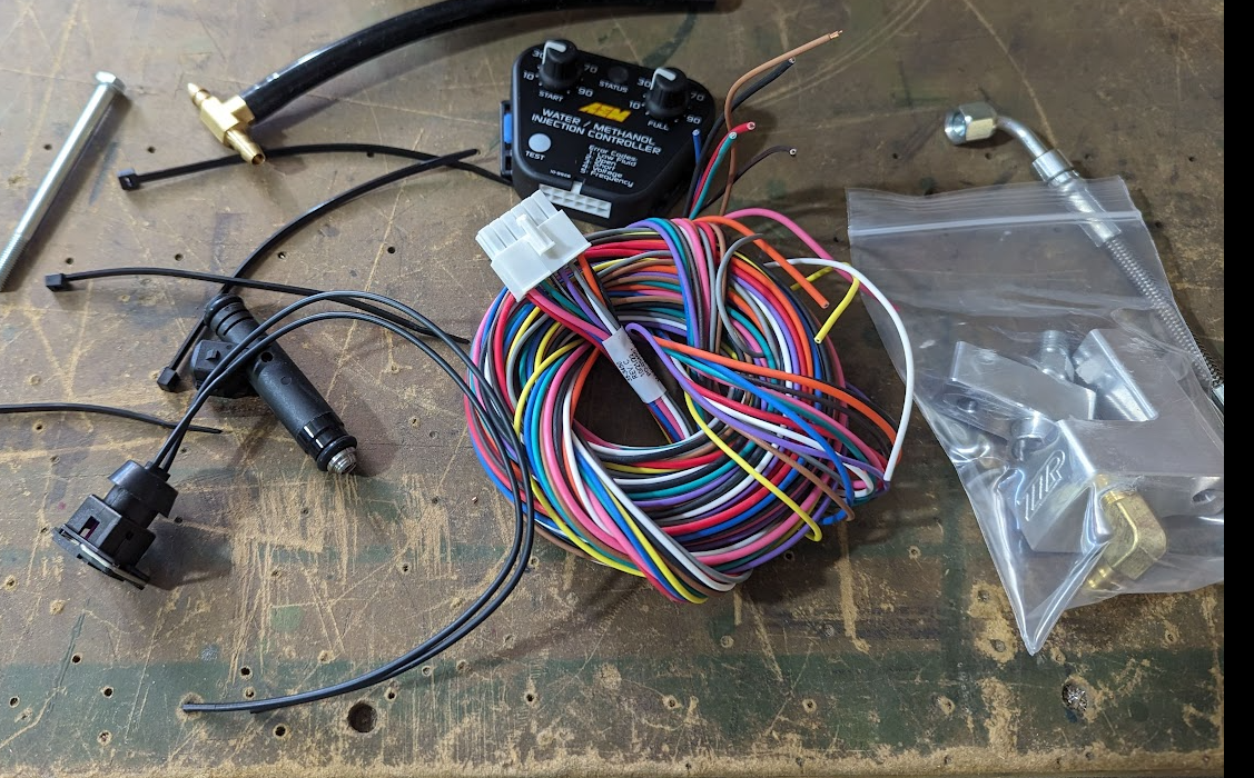

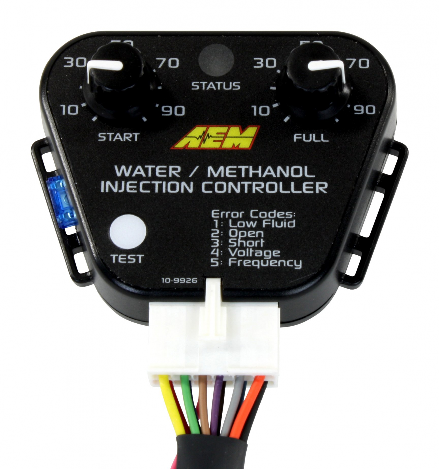

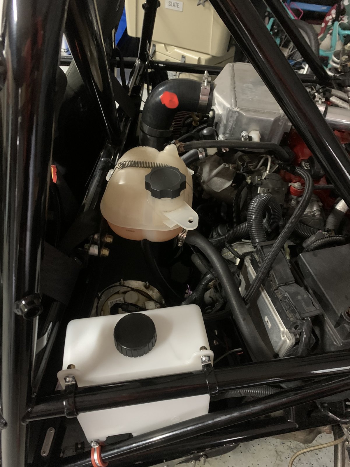

I’m currently trying to put a meth injection kit on my Lnf. My current hurdle is finding a good spot to put the water/meth pump to be under the tank and injector.
I have mine mounted low and tight behind the passenger seat. I also invested in the electronic check valve, I recommend that strongly as I've sold many of these kits and although it doesn't happen very often it is very possible to see them siphon into the intake and dump the entire reservoir inside.
Stretch2126
I did the same time. Made a bracket for it in the small spot next to the fuel tank and engine. I wired the arm voltage to my accessory button so I can turn it on or off. I’m not tuning it up to always have it, but it’s nice to clean out the intake and help stay cool with autocross runs.
