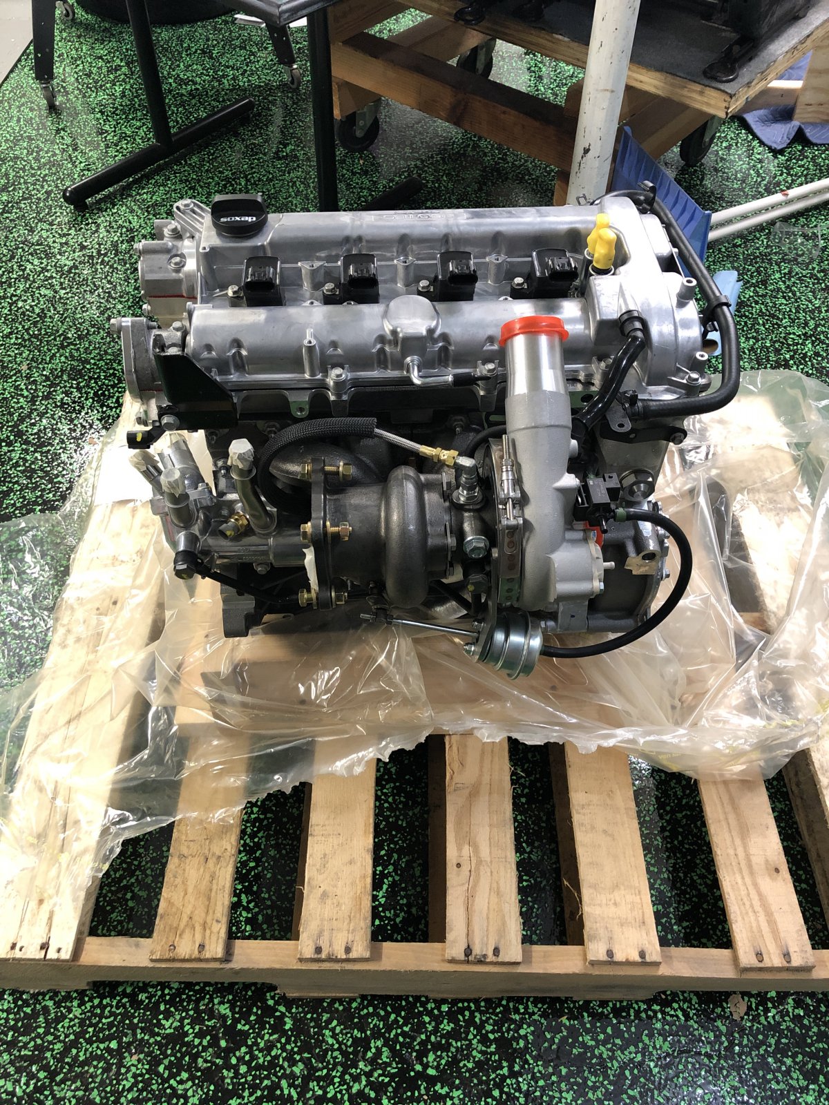

Hey peeps,
My crate engine did not come with the transmission extension that bolts onto the engine. Any idea what model number that is and where I can buy one? I can't seem to find that anywhere.
Thanks,
Nuker-

Is this what you are looking for?
If yes, looks like you might need to go used or rebuilt since the part is discontinued.

Yeah that's the part. I was hoping to get a new one, Else I'll just pull this one off the used LNF from my donor. I'll probably just replace the bearing that CED has for 70$.

I couldn't find that either and ended up using the old one. But I might have replaced the bearings in the holder, I can't remember anymore.
