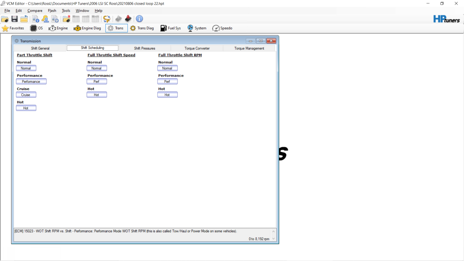

Got a nice tune over this weekend, hitting within ~3% across my low freq MAF table.
Next up is the speed density, virtual VE table tuning. Hopefully this should be pretty quick.
The Google drive folder in my signature has the as found and final MAF tune files.
