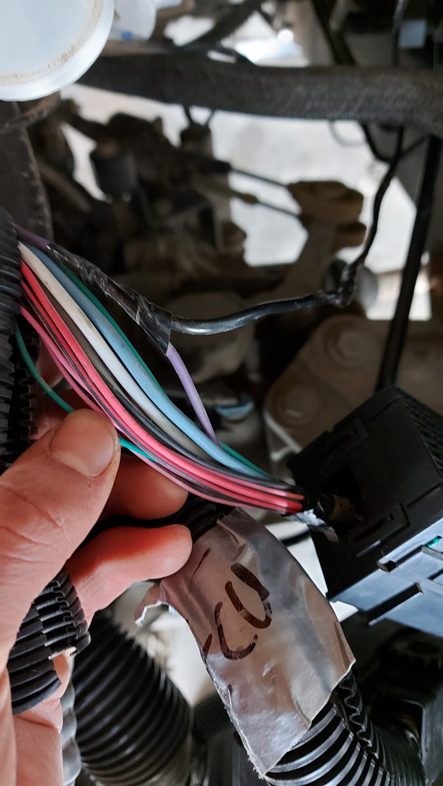

Wire #1 (First Picture)
Spliced into my headlight harness, there is a green and black wire that connect to what looks to be a relay which is in turn connected to the main harness that goes into the cabin. My current best guess is that this runs to power the amp when the ignition is turned on? The black wire is grounded and the green taps into one of the front headlights. Can anyone confirm before I start cutting wires?

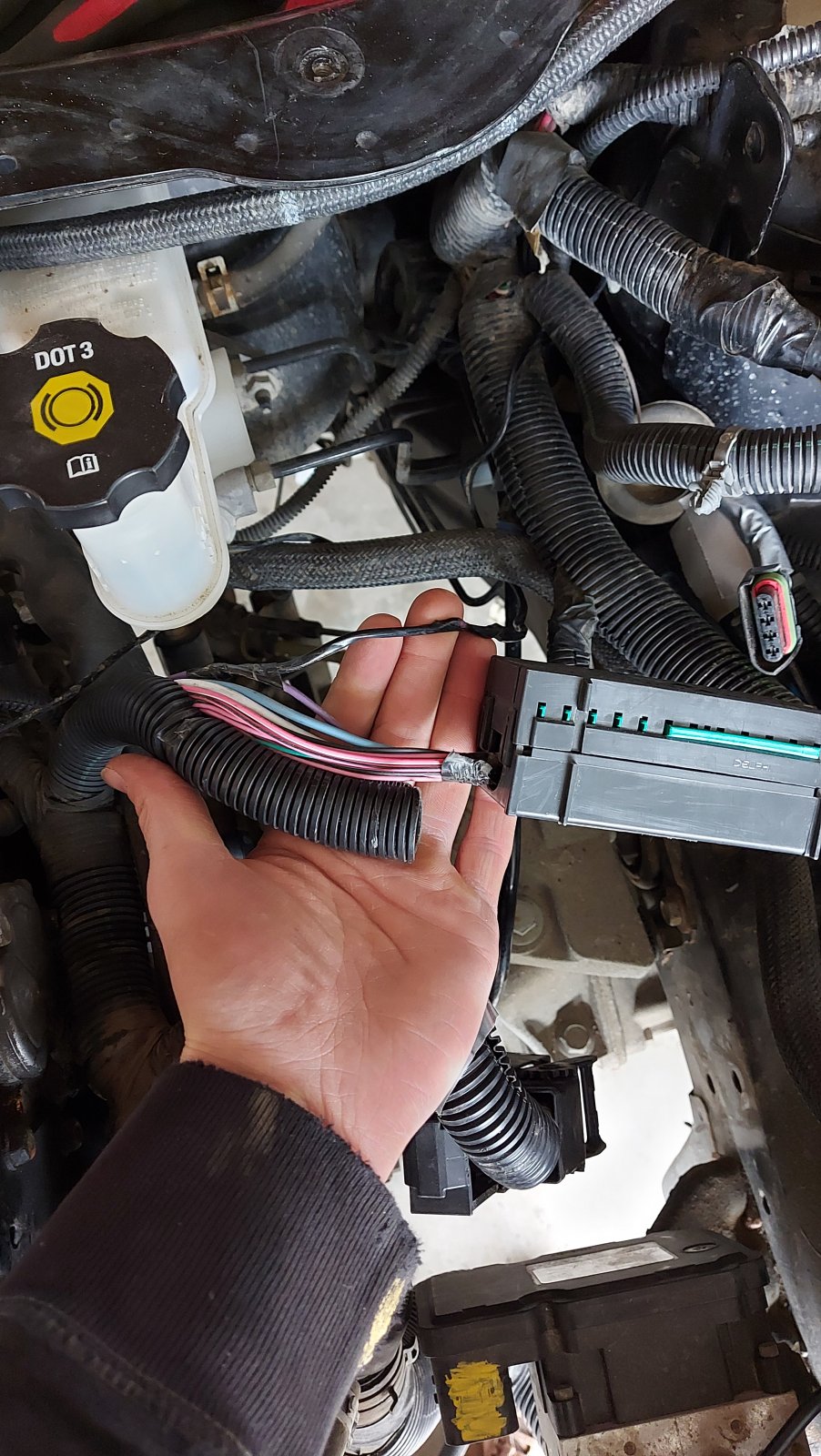

Wire #2 (Second Picture)
This second wire I am more unsure of. It is a single purple wire tapped into the cylinder 3 spark plug and running back through the firewall where it disappears. Does anyone know what the purpose of this wire might be? Its currently my last wire connecting my engine and body.

Add you donor to your signature. There are differences in the wiring between them.
Not sure anyone is going to be able to say what the splice is in picture 1. If connected to headlights, maybe they had other lights powered by the relay. However they may have had a bad stock relay, and are using this to power the OEM headlights. Need to identify the pins the wires connect to and see which side of the stock relay they are on.
What's the color of the oem wire the additional coil wire is attached to.
RCK605
Do you have any aftermarket gauges like a tach or shift light? They could have possibly tapped into the coil to get RPM.
DUNE
The purple coil wire disappears through the firewall and I haven't been able to track down where it connect to OEM wiring yet. Maybe ill have to do that before dropping the powertrain
There doesn't appear to be any aftermarket gauges. Just the factory boost pillar gauge
What color wire does the purple wire attach to in bundle by the coil?
It's possible someone had a bad 12v+ wire feeding the coil break and they powered it with something else. Or they might have added a ground.
Most likely is aftermarket tach or shift light though.

Its connected to a light blue/green wire running into the spark plug.

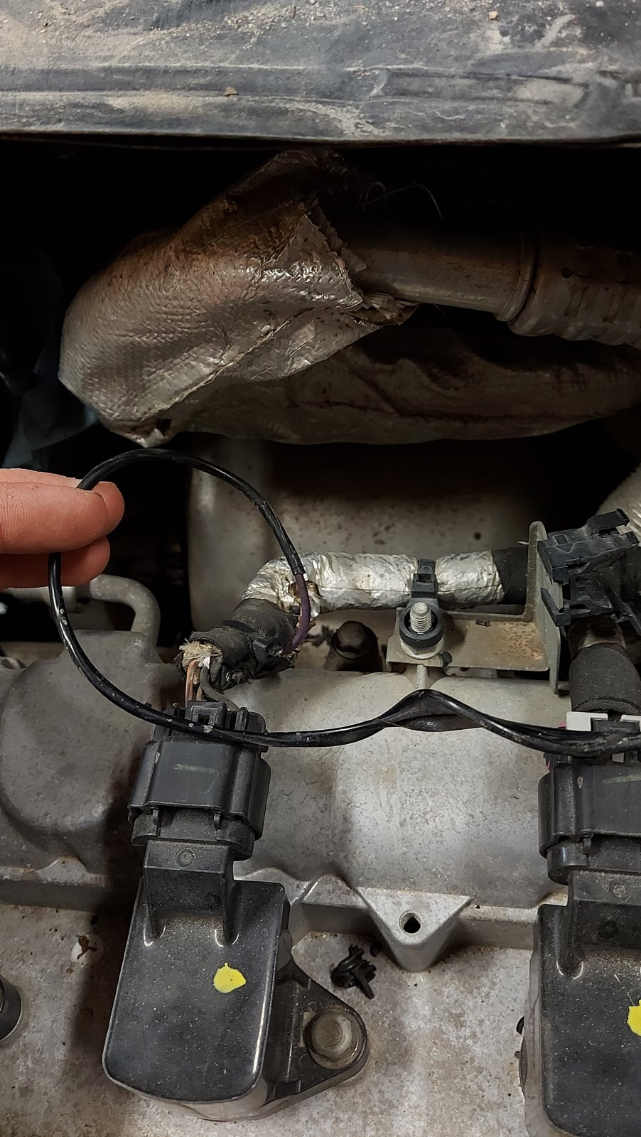

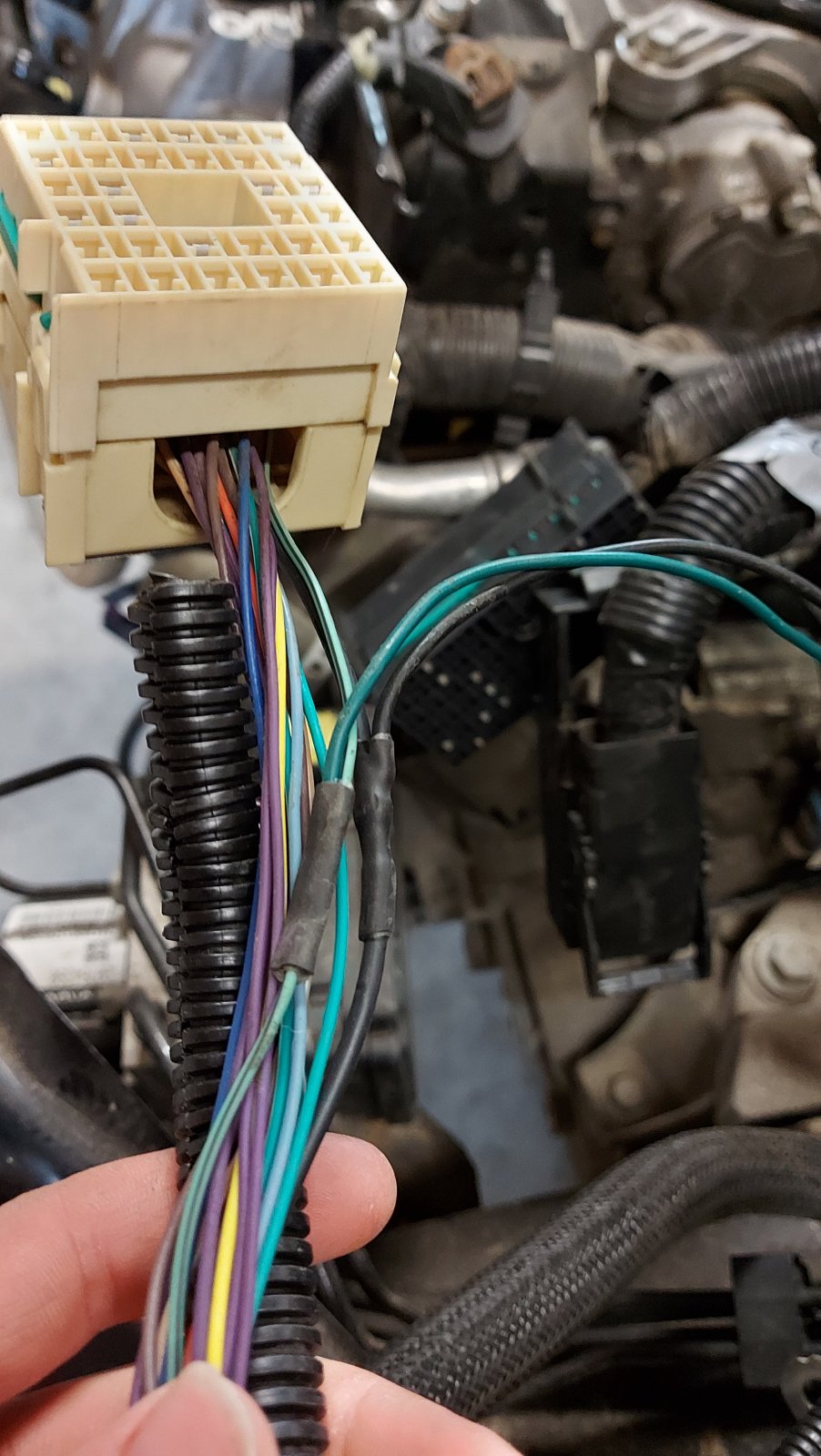

While looking at that one I also found another purple wire coming out of a different engine multi-plug, pictures are below. This one is the same deal where this spliced in purple wire runs into the cabin. Are there wiring diagrams for these plugs that I can reference?

Technically, that isn’t running to the spark plug, it’s running to the coil. Light blue/green iisn’t a choice of colors for the coils on the later
models, just light blue for coil 3 or dark green with white strip on coil 4. These are the fire signal for coils so likely was aftermarket tach.
Im not aware of any free wiring diagrams for the later models. You can subscribe to Alldata or buy the service manuals. I
You need to show the end view of a connector for good if. It looks like the last pictures is probably the fuse block x2 connector. Only solid purple wire on that connector is windshield wiper motor-high speed.
Very first picture. X3 connector light green with black stripe is the hi beam feed after the pcb relay and fuse. Either they were switching something from that through a relay or the pcb relay died and they rigged something to replace it. Depends on what the wiring of the added relay does.
DUNE
Thank you for the detailed responses Gtstorey! Based off that I think ill just cut and label the mystery wires and trace them to their source once I have more of the harness accessible. Then if necessary I can re-connect them when I rework the harness
