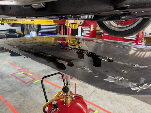

Here is the leak after seven 46 second autocross runs. Double yuk. Dropped the diffuser from Nine Lives.

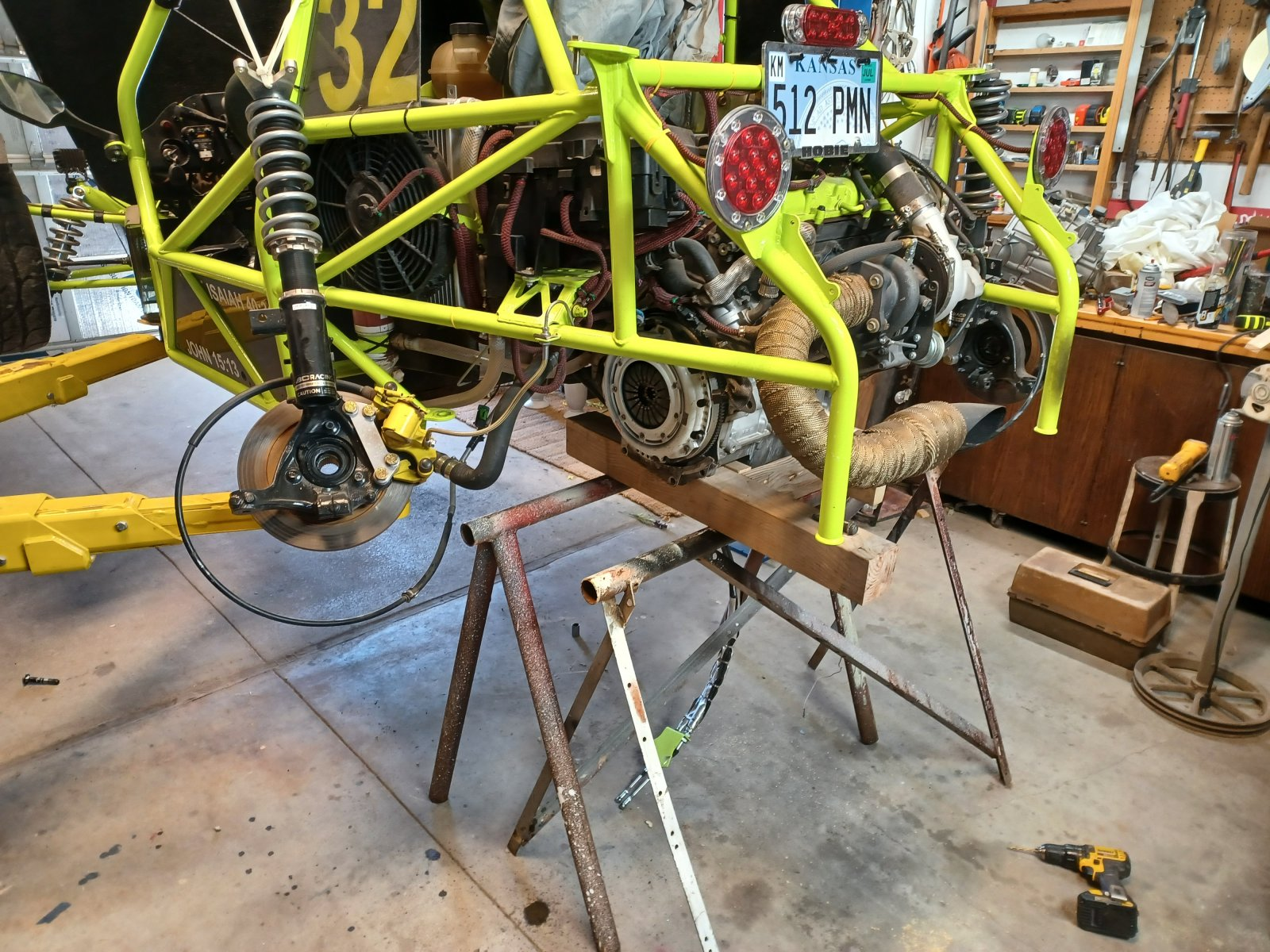

I used a horrible freight hydraulic table. I usually use it for putting transmissions on the bench but it sometimes works as a powertrain table
