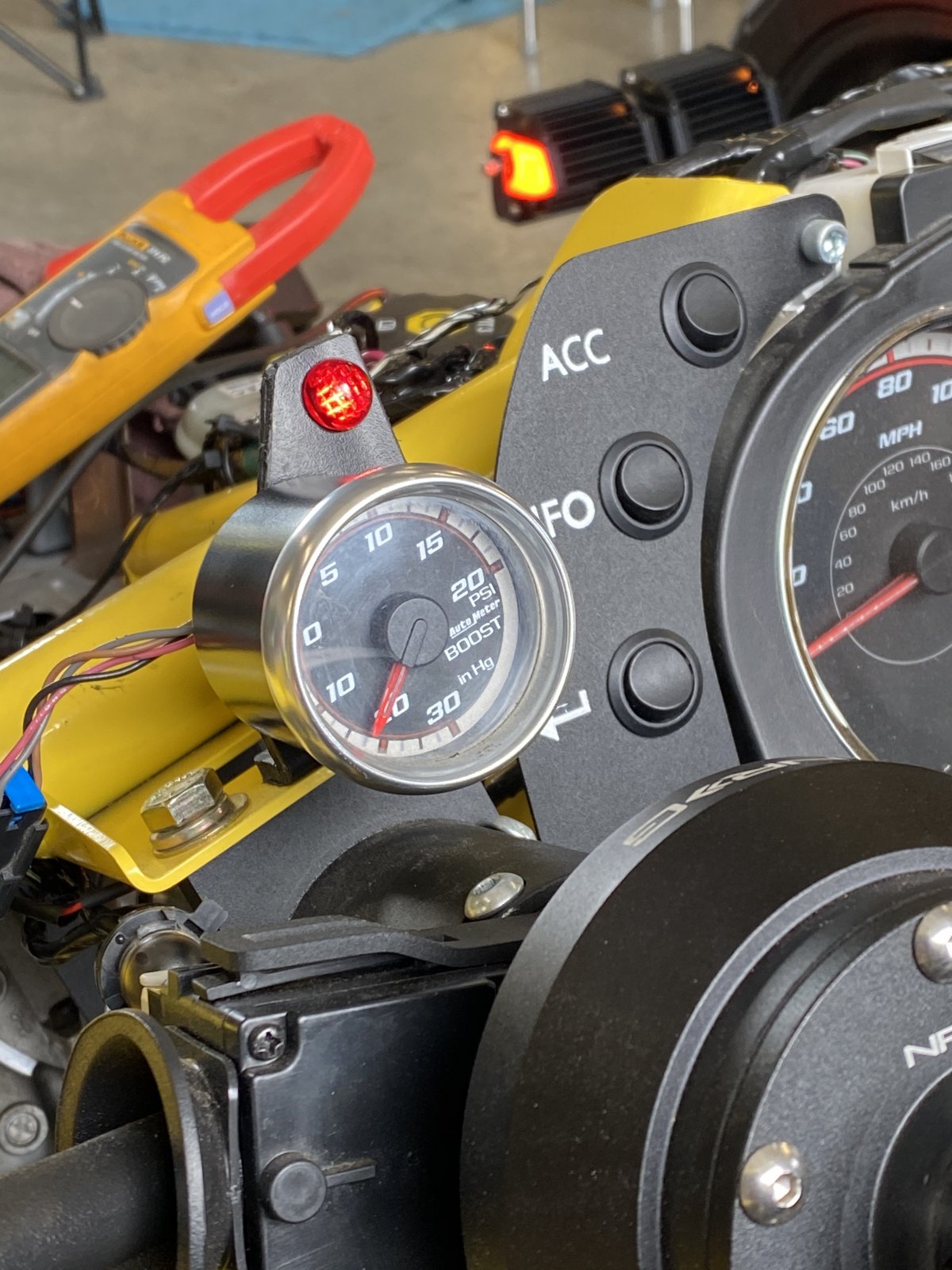

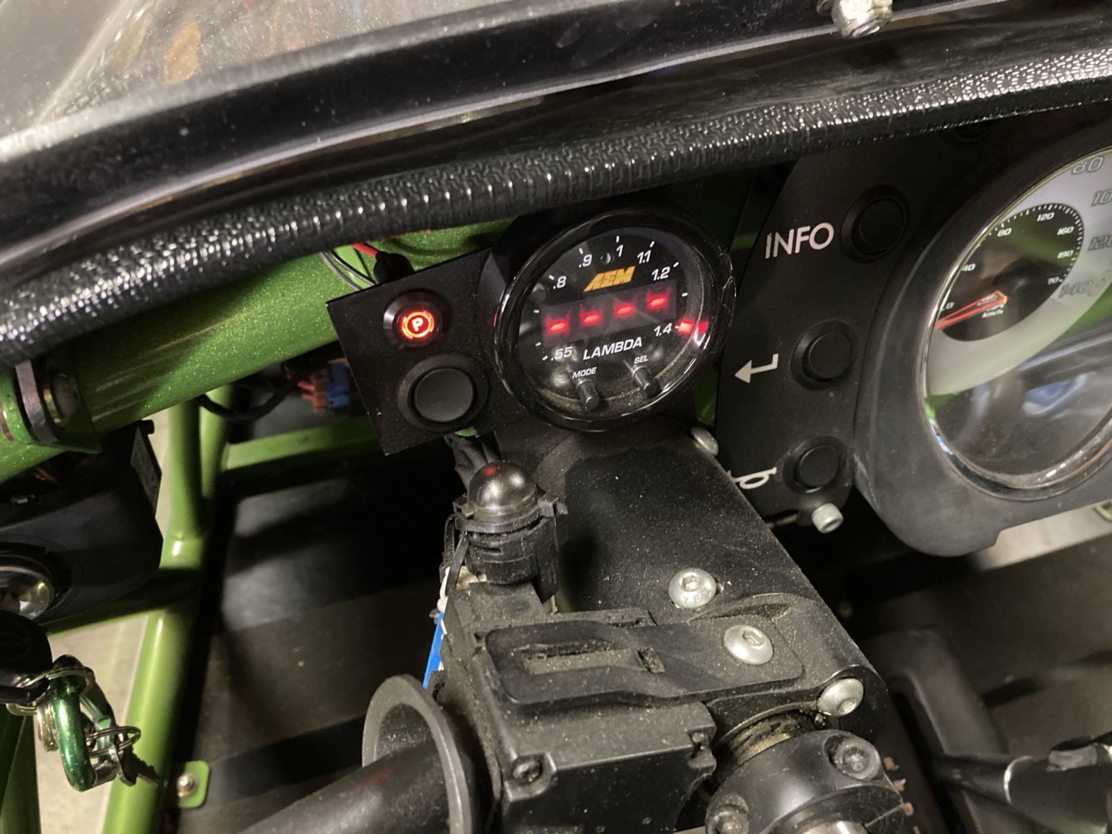

Yep. Block off the dash lights and run your own. A small led with ignition power to it, then use the switch on the park brake lever to throw ground. I added my light to the boost gauge
