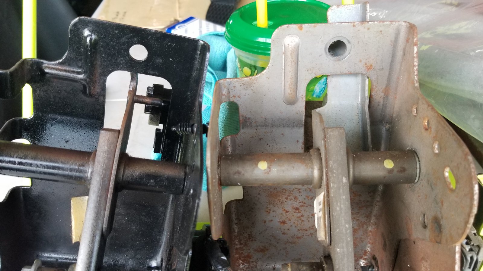

So, at first glance these look the same physically, but then i look at how the brake switch works and it looks like they are not compatible.
Back to the drawing board. Might be cutting and welding that corner of the pedal box to reuse the manual box.o_O
comegetjoe
Wonder if I shouldve looked for a 08-10 automatic if that wouldve changed things for me?
Nope. I shouldve just looked closer st what I was ordering. Orientation of/and brake switch wouldve saved me a bit of headache. Atleast now I know what Im looking for and what Im not. :rolleyes:
One has a depressed on/off switch and one had a rotating on/off switch. I need the rotating bracket to make it work.

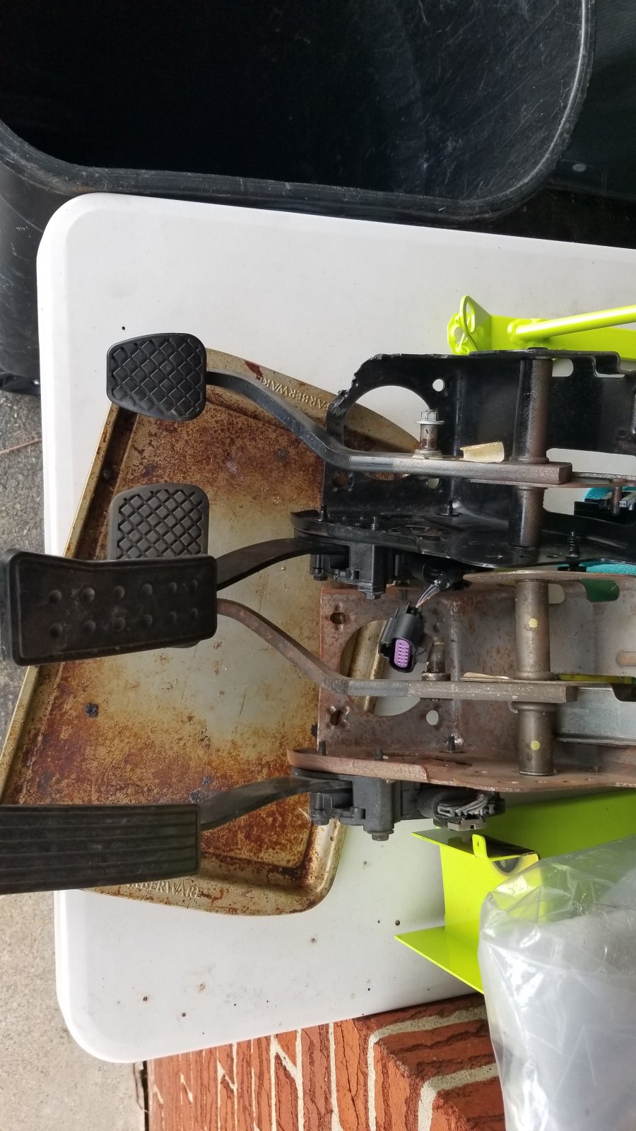

Found one pulled from a 2010 with the right bracket and switch setup and bonus, it comes with the foam piece where the brake pedal connects to the booster :cool:
Conclusion.
I could not find a 2008-2010 manual pedal box. The 2010 automatic pedal box I ordered was the same size as the manual pedal box. I cut the larger automatic brake pedal down to the smaller manual pedal size and put the manual pedal cover on it. Everything fits into place. I used my original 2009 manual throttle pedal. The brake pedal switch was identical. Message me if you have any questions, Ill be happy to help.
