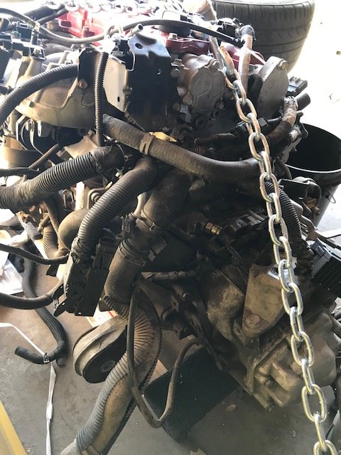

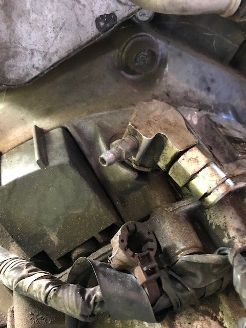

Happy Easter! When i pulled the engine this T coming out of transmission (not sure what it is) is able to spin and move back and fourth. Is that normal?

Back up view of whole engine and a close up of the part

When you replace the throw out bearing make sure to add some blue lock tight to the threads of this pipe so it will not leak. Also there is a small black rubber gromet/seal at the top circled above in the pic this sometimes gets stuck on the block that you explained moves. It has to be installed first. There is also a pin installed see how it
Goes on before removing. There is a reason I know a bit about this check my thread lol I fought this most simple part.
