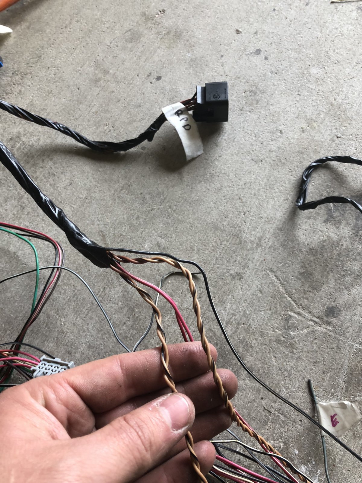

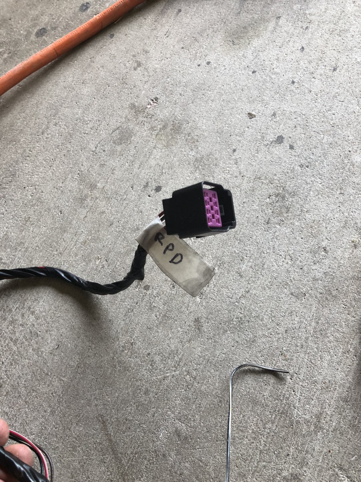

So I have been unable to find much about data wires on t/c cars except for one really helpful post with pics from DF. But I figured I would post some pics of how my wires run with the reconfigurable performance display option. Also if I routed them wrong I am sure somebody can correct it for me..
Christopher Sanchez
RPD plug...

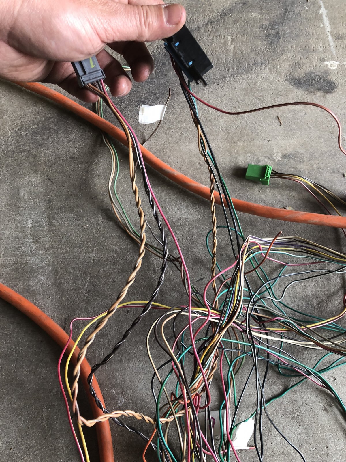

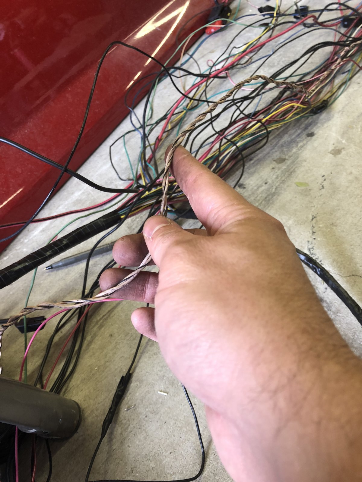

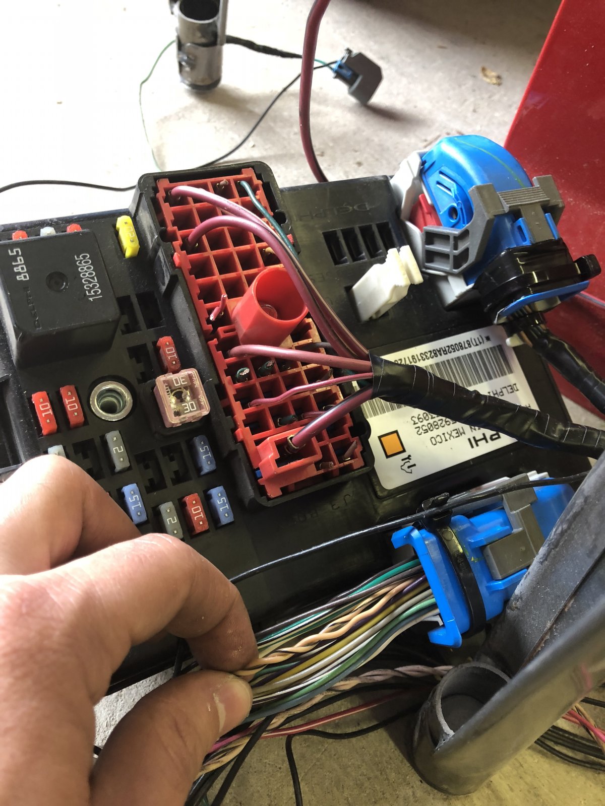

Christopher Sanchez
Data wires coming from ECU...(first pic) it’s appears that the data wires that go into the BCM plug then go to a grey plug in dark brown twisted wires then the OBD plug in the original wire colors.
