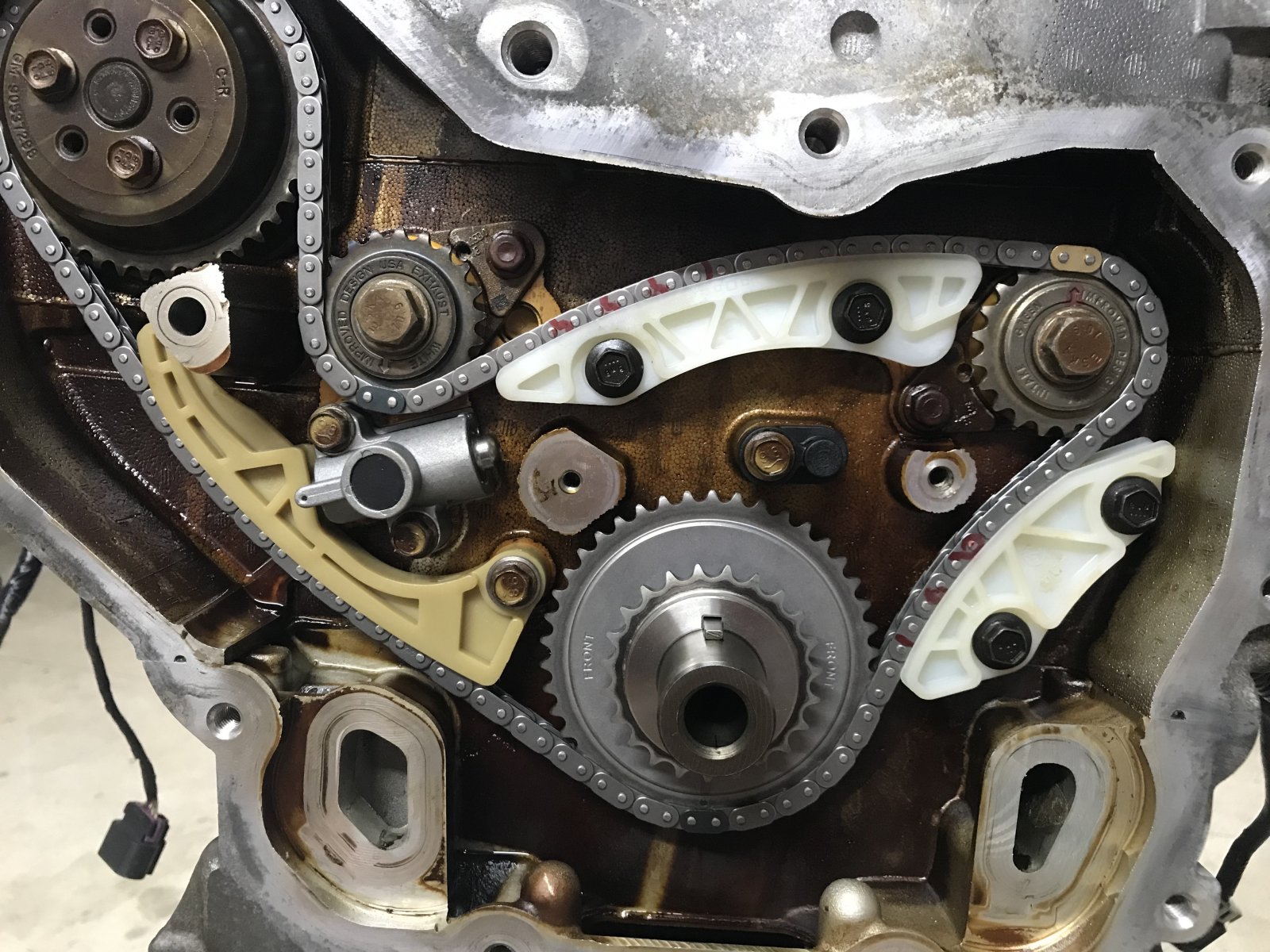

I did mine before I installed the engine (2.4 NA). I also replaced the VVT Sprocket & Solenoid/Actuator since the engine was at 87K. Replaced & upgraded the clutch at the same time. There are great video's on line to walk you through it. I figured it was cheap insurance.

I wanted to post this addendum. If you plan on removing the timing chain gasket then you need to snip the little portion marked with X's off. The motor mount is connected to that threaded hole. Snipping it allows the gasket to be removed without taking that bolt out. If the gasket is staying on the motor then no need to snip.
I'm not sure if this applies to all engine types.
