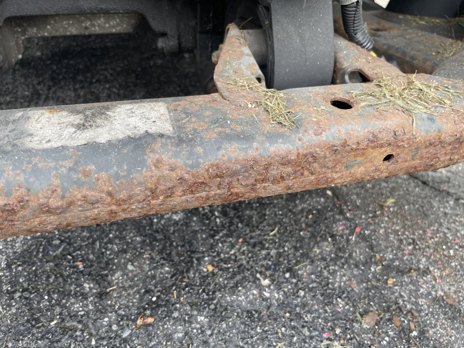

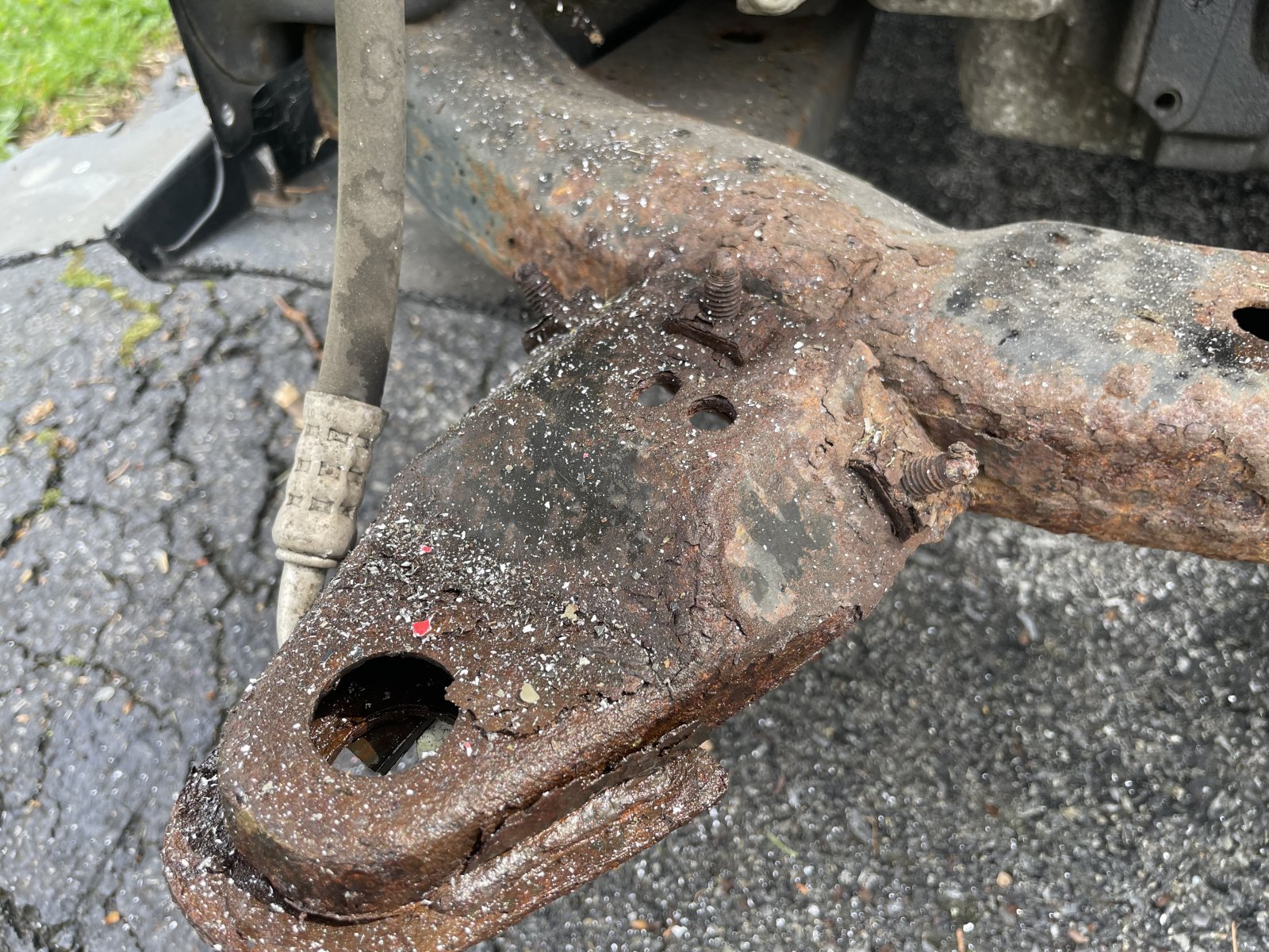

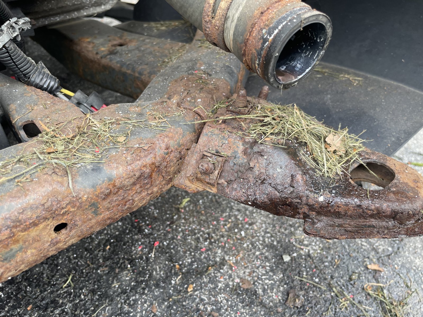

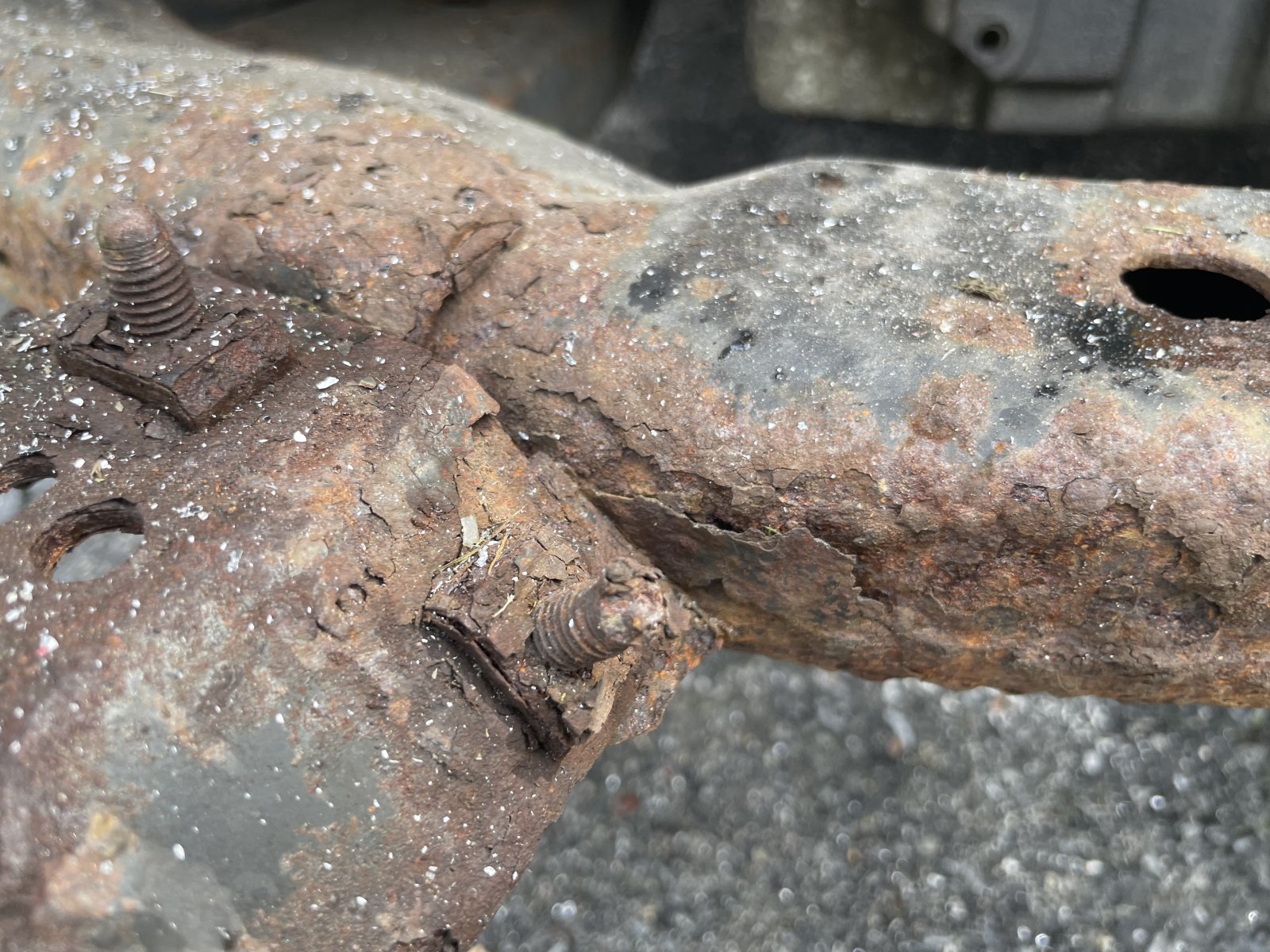

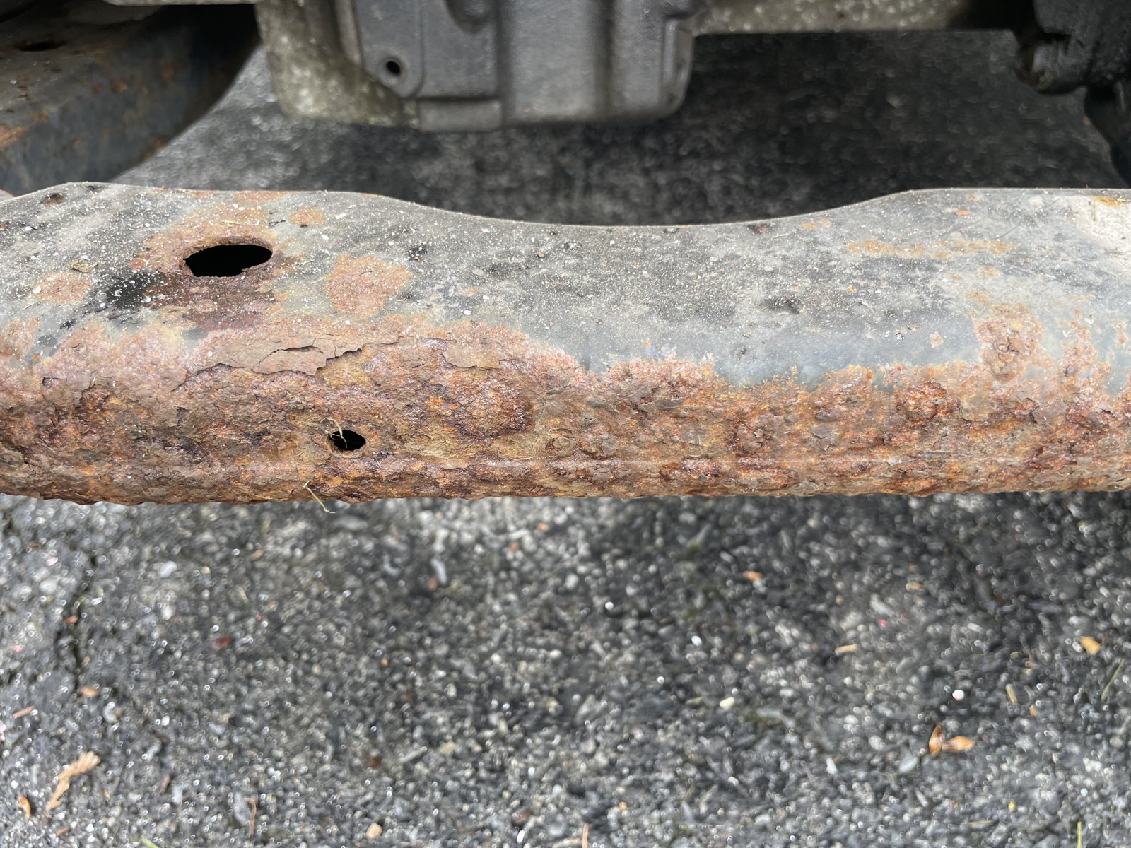

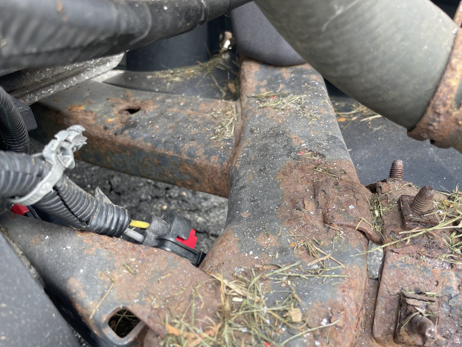

Hey guys. I got the front end off the car completely now and can see the extent of the rust. The rest of the frame back just looks to be surface rust from the bottom. Top can’t tell but looks like this thing mostly rusted on the front.
I believe I read that the radiator mounts are not used and an be removed.
I did take a flat head screw driver to the rust and was unable to poke any holes in the frame. Still I want peoples opinions if the subframe is still good or if I need to find a replacement.

I had the exact same issue as this. Yours does not look as bad as mine but I cannot say for certain if that is structurally sound and good enough to support the car. I would recommend looking on FB marketplace and seeing if anyone is parting out a cobalt near you. Someone was doing that near me and we got a new subframe for 100 dollars instead of paying 300-400 on eBay.
jirwin
Being in Michigan, and being my former daily driver, my su frame looked similar. I found one one eBay for $100ish that was rust free. Look into that before you go super crazy.
Metal Mech
Yeah I will look around. I’m also a bit worried if I pay someone to clean it up it may cost me a fortune. I’m guessing I could probably have at it with a wire brush in my angle grinder.

If you have an air compressor, buy a needle scaler. I prefer the pistol grip type. They work great on the type rust you have. After going over your subframe with the scaler, you'll have a pretty good idea its condition. The scaler will poke through any areas where the metal is thin.
