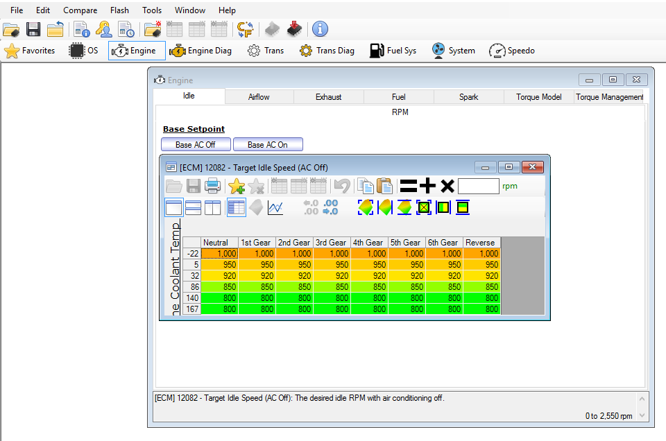

I have Stage 2 cams and ported head which I've read others are having idle surge or hunting issues with, if you have these problems your MAF is not dialed in correctly (see tune guide #2). I can sit all day at 800rpms - Base AC off is the same as Base AC on

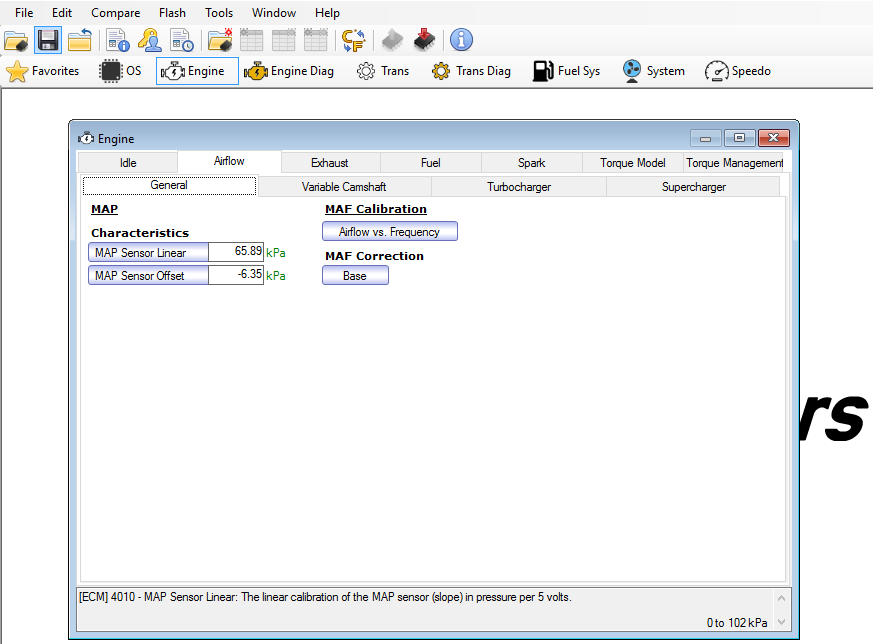

Airflow > General
Only use these values if you have the GM 3 Bar map sensors. Honestly, if you don't have the map sensors you should stop right here and install them first. The MAF Calibration & MAF Correction tables are talked about in the Fuel trims guide

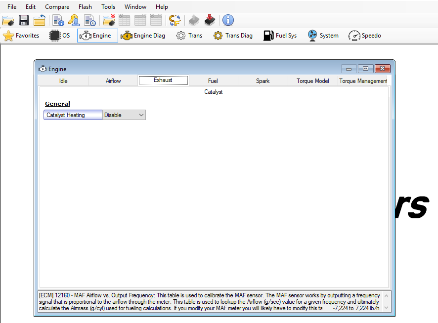

Exhaust > Catalyst

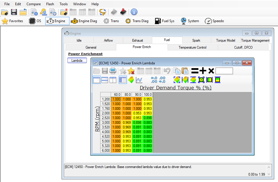

Fuel > Power Enrichment
This one you're going to play around with a little bit based on your logged afr's but this is a good baseline

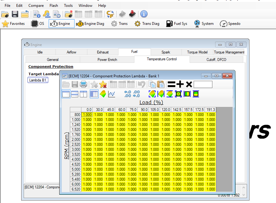

Fuel > Temperature Control
All 1's

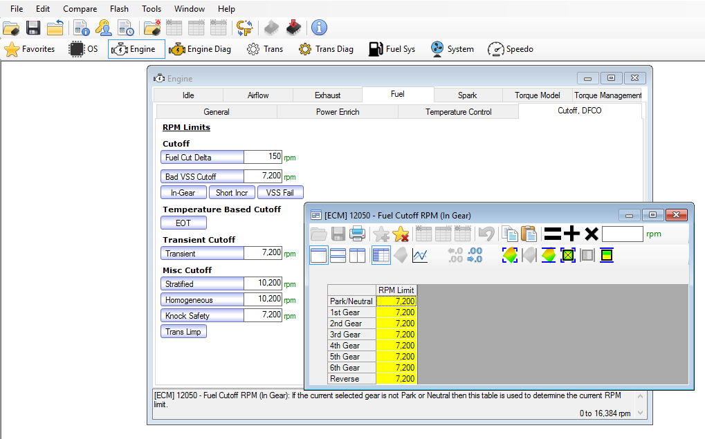

Fuel > Cutoff, DFCO
If you have stock springs / retainers just put everything to 7,200 rpms

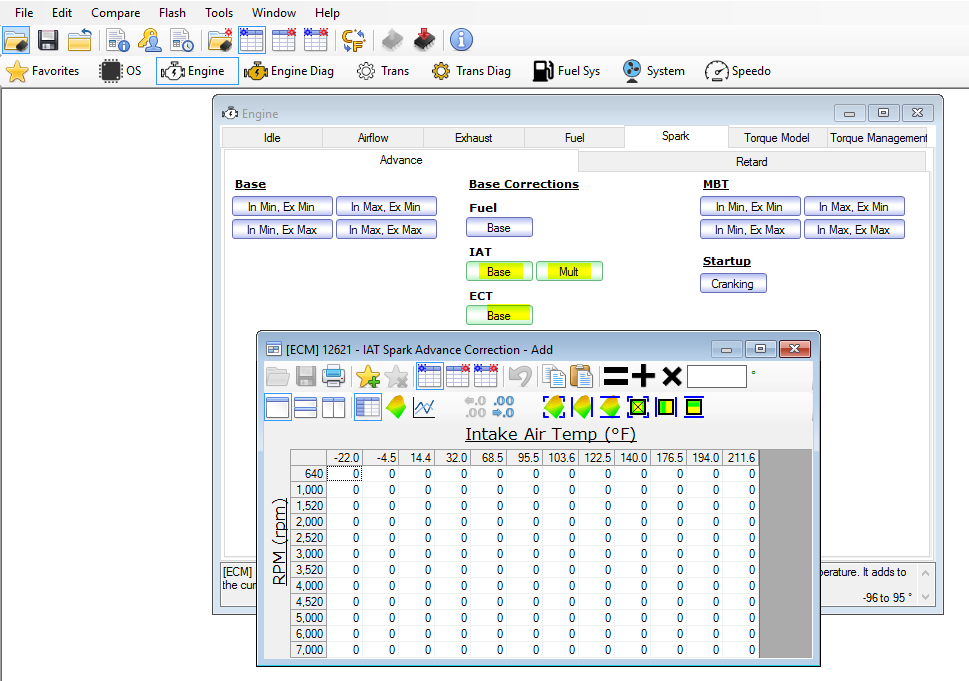

Spark > Advance
IAT / ECT should all be 0. We will get into the timing tables (Base / MBT) in their own guide.

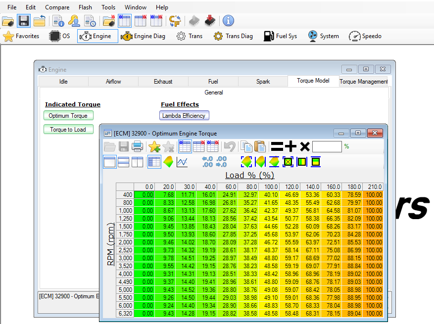

22540
Torque Model > Optimum Torque
You can play around with this one but this setup runs well for me

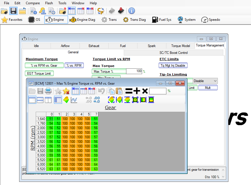

Torque Management > General
% vs RPM vs Gear - This is where you'll modify the sensitivity of first gear to your liking, the rest should be 100
22542

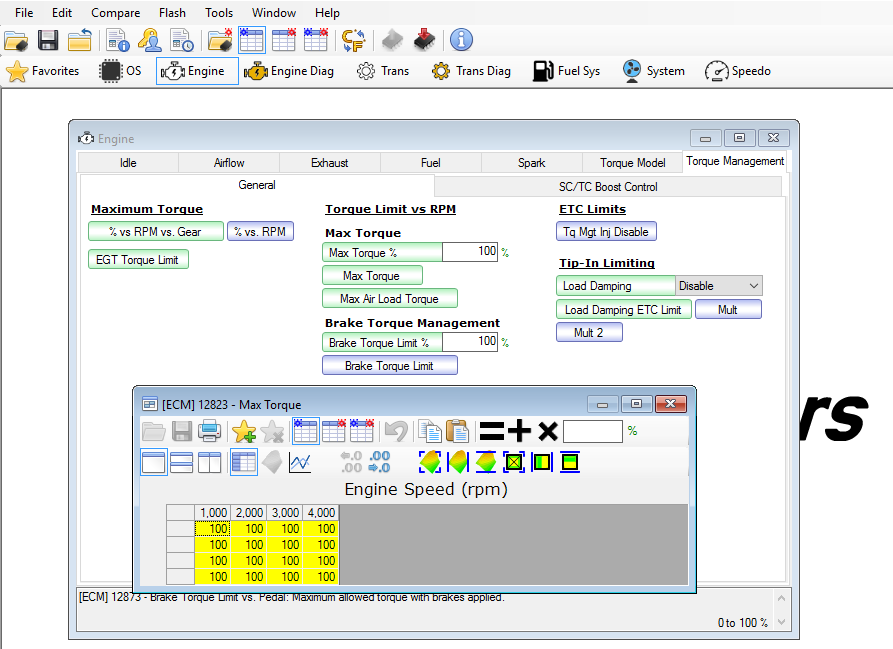

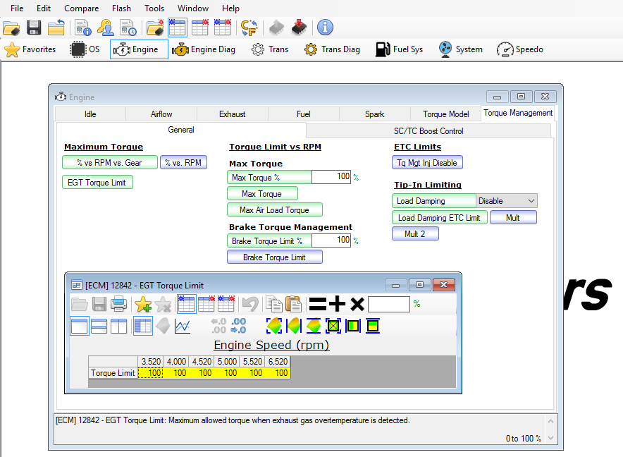

Torque Limit
22543

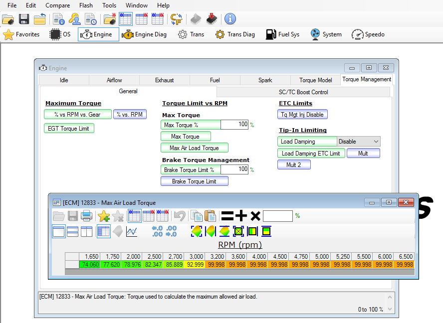

Max airload torque
22545

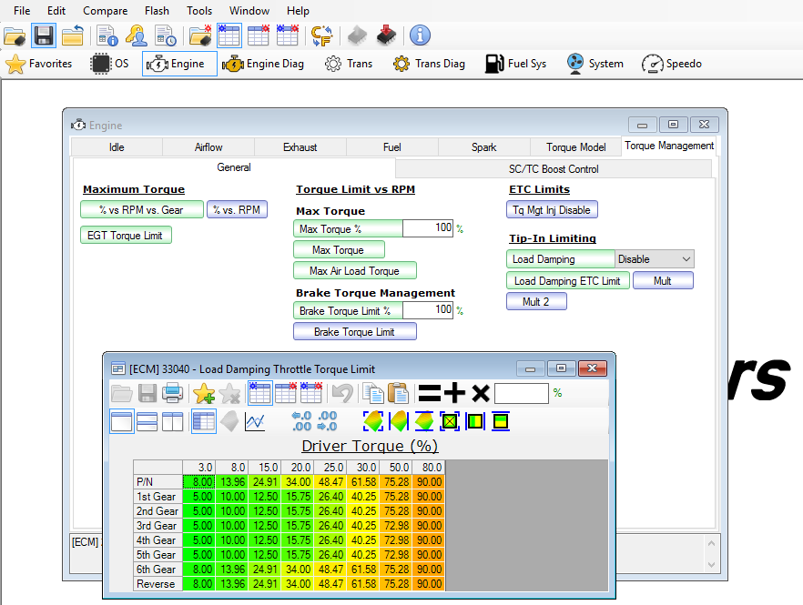

Load Dampening
22546

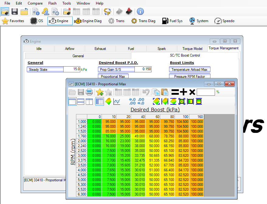

SC / TC Boost Control > Proportional Max
If you don't have Opel injectors, do not change anything else

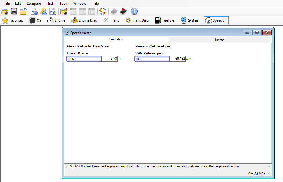

Speedo > Calibration
Calculate your VSS Pulses here for your tire size: https://dfkitcar.com/forum/index.php?threads/speedometer-vs-vss-pulses-mile.2503/
