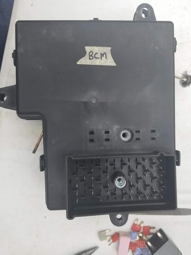

Trying to open the BCM up to inspect the circuit board. I opened the 6 perimeter plastic clips that hold the black clam shell together... jamming 1/8" spacers as I go. But the BCM seems to be held together in the middle. Maybe those 2 metal thread inserts? Anybody opened the BCM already?

I drilled out the BCM two inserts past the swedged area, and inspected the motherboard. Nothing looked cooked.
