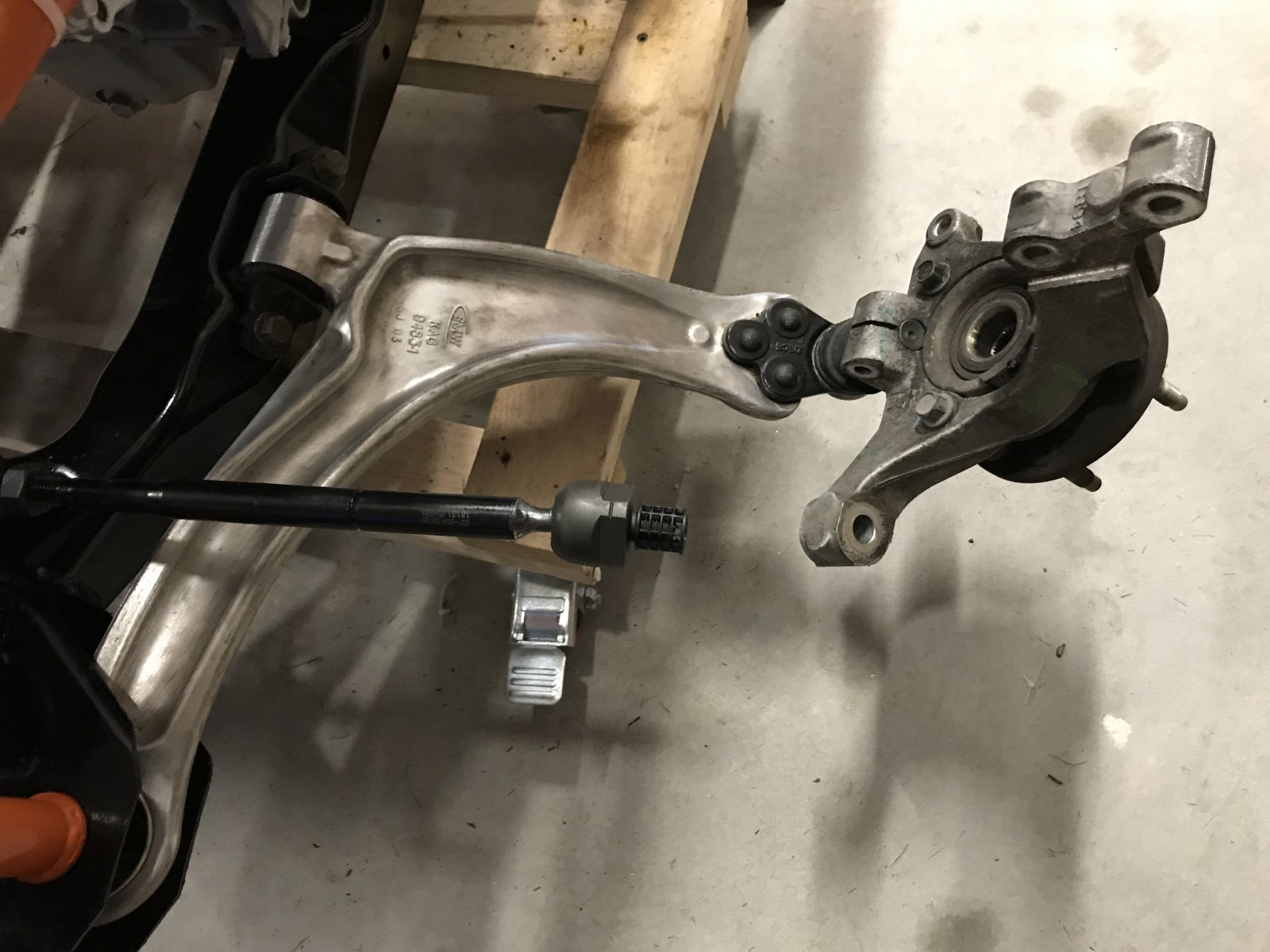

ZacMaster Well-Known Member ZacMaster Well-Known Member Jun 7, 2019 #4 For context, this is where I’m missing my donor rod ends... Haven’t painted the knuckles yet, just trying on for size.

ctuinstra Goblin Guru ctuinstra Goblin Guru Jun 7, 2019 #5 Your intermediate shafts are on backwards. The ball socket should be to the inside of the car.
Tim Moland Well-Known Member Tim Moland Well-Known Member Jun 8, 2019 #6 ctuinstra said: Your intermediate shafts are on backwards. The ball socket should be to the inside of the car. Click to expand... I second that

ZacMaster Well-Known Member ZacMaster Well-Known Member Jun 8, 2019 #9 ctuinstra said: Your intermediate shafts are on backwards. The ball socket should be to the inside of the car. Click to expand... That’s because at first glance I thought those were the ends that fit into the knuckle. Makes sense. Thanks for the heads up.
