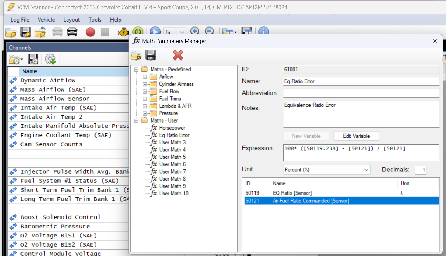

Hey Guys,
I am starting to dabble into tuning via goat roap garage channel and up to this point I have sent my data over to ZZP which has done a great job. The issue is I have a long bit until my cortex boost controller is dialed in properly so I figured why not understand the MAF tuning while I have all the equipment.
My AFR Gauge is a AEM 3000 series. I am stuck on one area right now which is an important step. In the video its mentioned to use the built-in equivalence ratio commanded which is not an option on the 05 ECU. I followed the similar math to calculate eq ratio error but utilizing Air Fuel Ratio Commanded (low) instead. This data will not let me transform to Lambda like I did with my AEM - AFR so when AFR is 1.0 Commanded is 14.7. Will this mess up my calculation? I am curious what you all have created for a math parameter to calculate eq ratio error to apply to a graph.
Hope this makes sense I am just starting out.
Thanks
