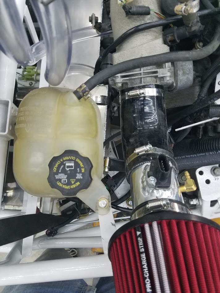

Lets start with the MAP sensor - do I have it pointed the right way? (with the brass fitting on the right side)
And that brass elbow vacuum line on the side - where does it go?

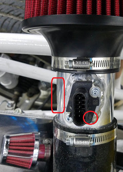

Am pretty sure the brass elbow gets connected to the breather on the valve cover.
There's an arrow on the MAF (yes, MAF) sensor and, when the sensor is properly installed, said arrow points in the direction of the airflow.
Thanks Parson. I found the arrow on the MAF - inside the red circle.
The red rectangle is where I put some aluminum duct tape over the hole, as I have a small red air breather for the valve cover.
The arrow should point towards the engine...so you have the MAF correct. The hole on the MAF housing is for a small brass nipple to mount. That will be for the vacuum hose that goes to the valve cover. I capped mine off, and put an breather filter on the valve cover.
