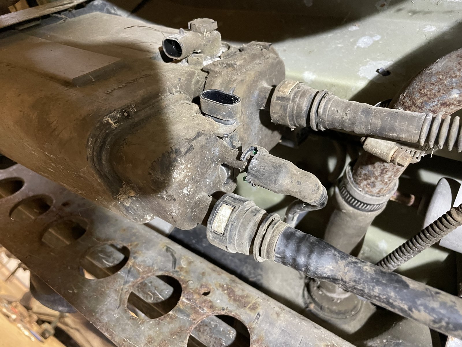

Having issues getting these connectors loose. As you can see I have already done some damage.
any suggestions??

push then lines towards the box, squeeze the top and bottom of the fitting at the square holes and then pull. You don't need them if you are in a non emissions state though.
