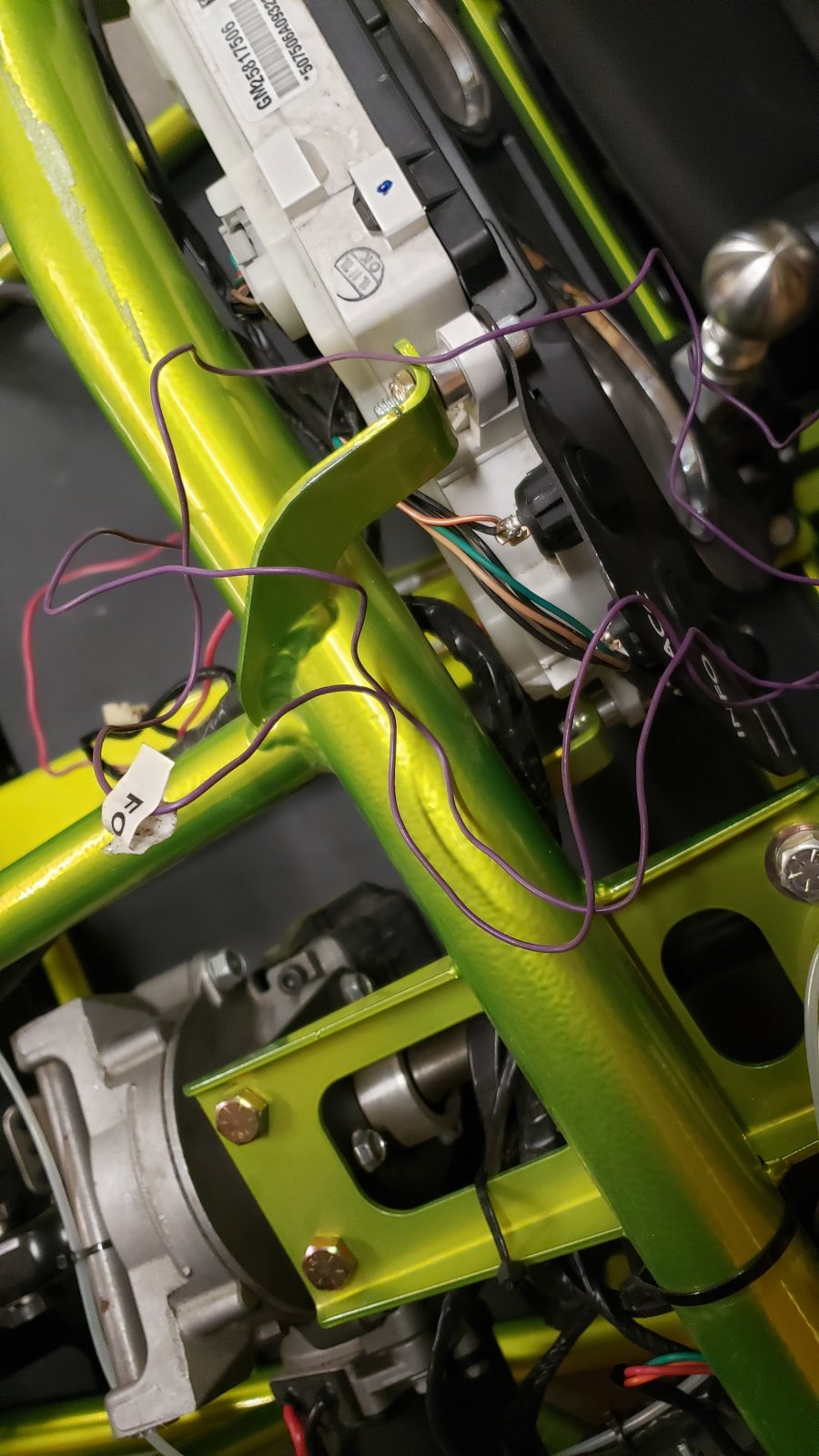

I’m getting close to having my harness finished up but I need to know what these wires are for?
The purple was supposed to be extended from the fog lights I don’t have. The red with white stripe was supposed to be coming out of the amplifier connector that I don’t have either.

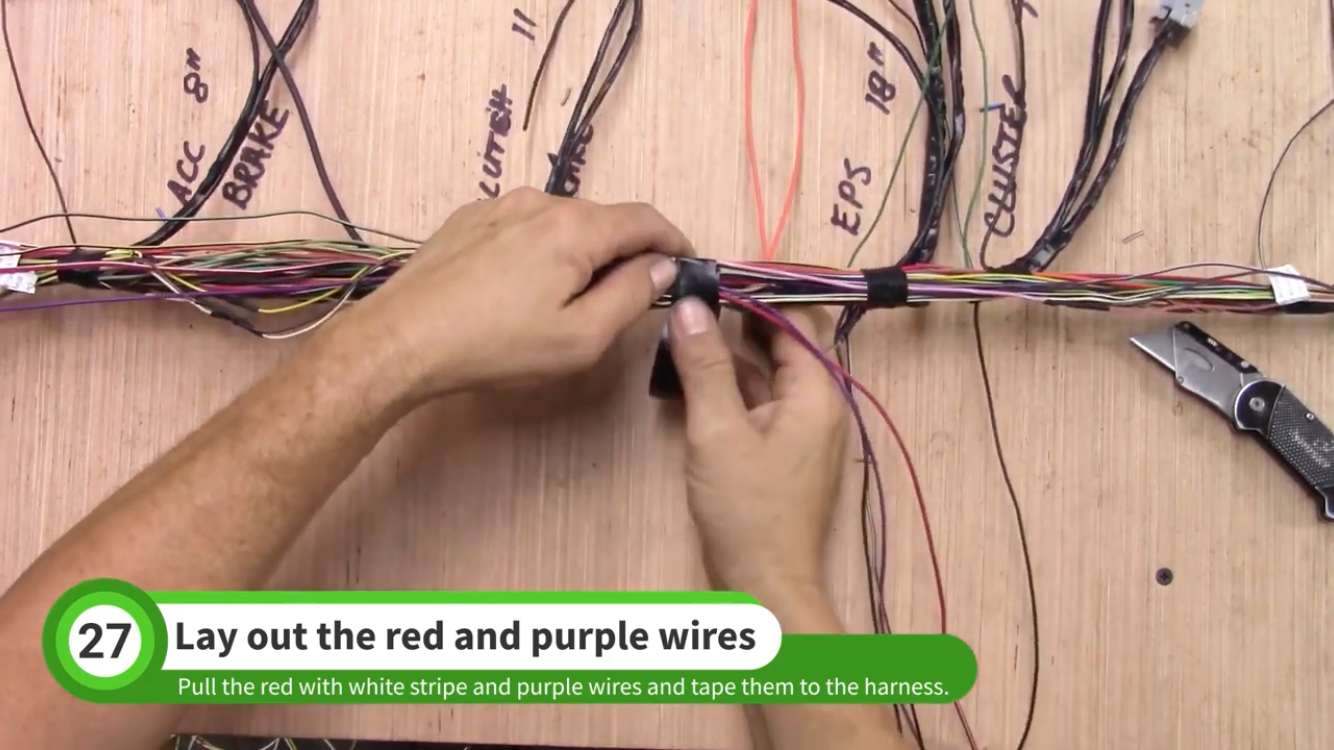

The red/white should be ingition-on 12v (I think they use this for the intercooler fan up front, iirc), and the purple will power accessories using the ACC switch on DF's button panel.

Thanks. I am supercharging this car but I’m putting the ducts in so I don’t need the fan wire. If I decide on some kinda accessory later that needs power I’ll deal with that.
You could use the red/white for the ACC switch (if you go for the DF button panel) since you don't have a fog light circuit.
The RD/WH wire was from donors that had an amplifier from the factory. I left it for extra power if someone needed it.
The purple wires (one near the fuse box and one on the dash harness) were from donors that had fog lamps. I left these for folks to use to turn things on and off like extra lights.
You can disregard these two wires.

There's a purple wire in the front half of the harness that gets bundled and saved for later in the DF videos. That is the wire that gets 12v when the ACC switch is on.

I was kinda hoping for a more precise location. I had df do my harness. It's already installed in the car, and I was wanting to avoid opening up the entire front harness.
It should be rolled up and attached to the harness somewhere around the pedal box, or where the harness bends upward at the front.
You should not need to cut the tape to use the fog lamp circuit. It will be a length of purple wire near the dash ground strap in the front and you will find another rolled up purple wire in the rear near the fuse box. They are both labeled and zip-tied to the outside of the harness.
