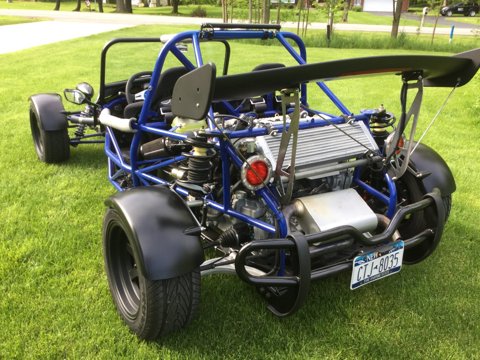

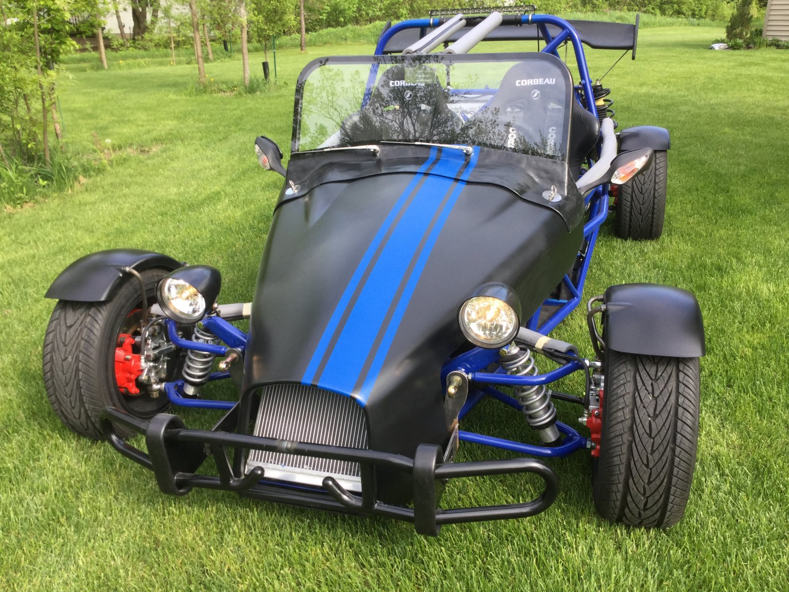

You mentioned deer. They can be unpredictable, so if it was me, I would add A pillars. If you remove the top Halo bars, like BAR-AIR did here, with an easy entry sides, you still will be able to enter/exit your goblin easily, but have a bit more deer protection with the window frame in front of you. Up to you if you want to put a windshield/polycarbonate in it.
View attachment 22833 View attachment 22834
Did he remove the hoop? My understanding is he started with an open frame and actually added that A pillar and two top bars to it. (He needed to have a glass windshield due to his state requiring it)
